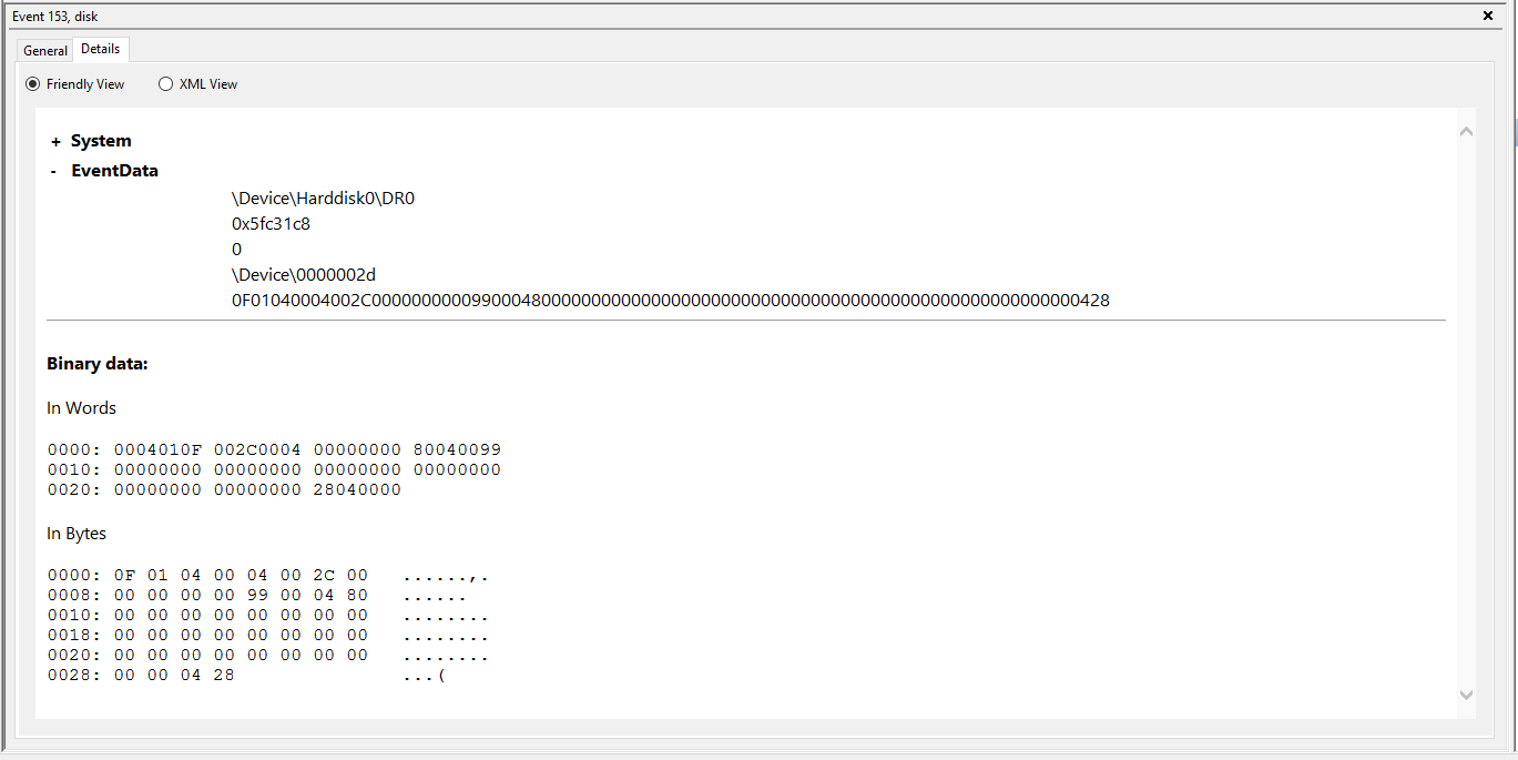

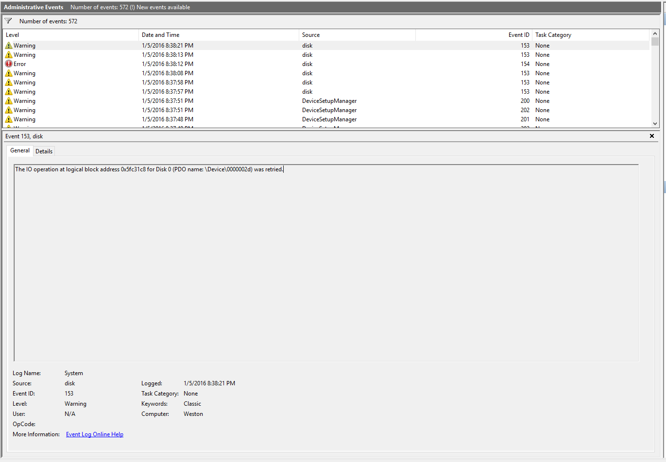

Keep getting this error in event viewer PC keeps locking up/freezing. I have to force restart. Any ideas rest of error codes and specs below.
Fresh install of WIN10 (kept having this problem reinstalled win10 didnt solve it)
Dell Z87 mobo (fully updated bios)
PNY 120 GB CS1100 (already tried to update frimware has OS on it)
Seagate 2tb SSHD
Seagate Barracuda 1tb
I7 4770
10gb of ram
GTX 970
Thanks
post-88805-0-36127000-1452045086_thumb.p
post-88805-0-88104500-1452045087_thumb.p

Well i had 10gb of ram 2x4gb the computer came with and 2x1gb sticks i took out of a old pc for some extra photoshop ram. I took the 2x1gb sticks out and now i get this error
The IO operation at logical block address 0x3e829c8 for Disk 0 (PDO name: \Device\0000002d) failed due to a hardware error.
error code 154
error code 154
