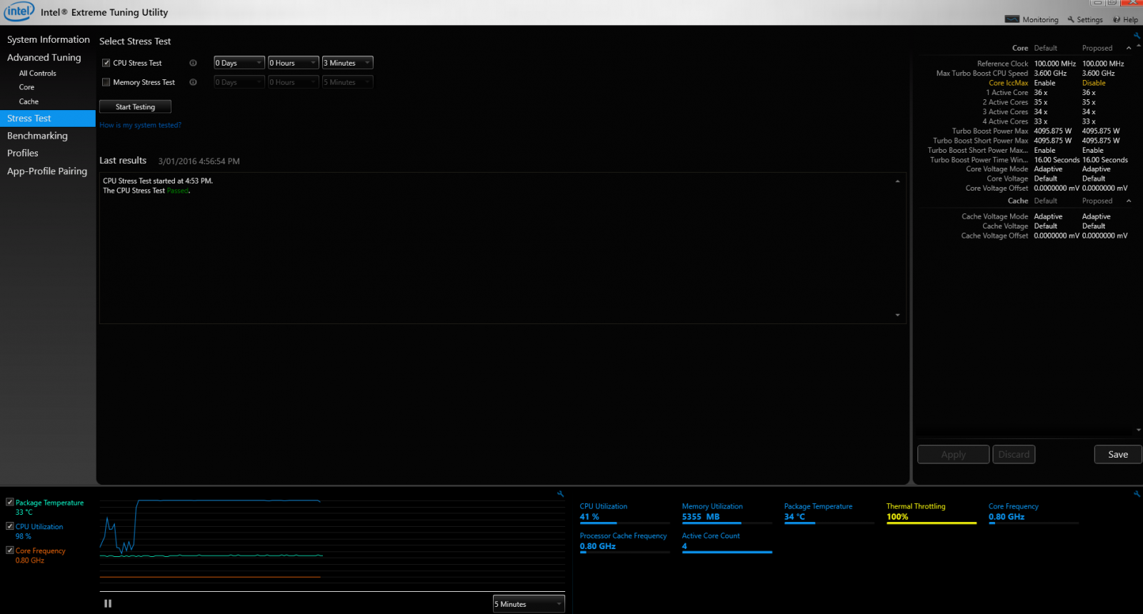

I just put together my new rig and everything was going fine until i started performing some more demanding tasks and thats when i noticed it was a bit slow. I then ran CPUZ and saw that the CPU multiplier was at 8x even under a stress test (see attached image).

but the max frequency of the chip is 3200 MHz and the highest i've seen is 800Mhz (8x100MHz where 100 MHz is the base clock)
From that image there is no stress test running your only at about ~25% CPU utilization run a program like Intel XTU or Adia 64 and see if the frequency changes.

i was running "stress cpu" in CPUZ in the backround of that screenshot, and any other stress tests i have run have given similar results
From my understanding CPU-Z is only a information program there is no stress test option on it, run another stress test program and ensure your CPU is pushed to 100% to check your CPU frequency.

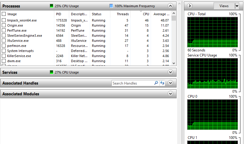

here are the results but when looking at the resource monitor again it never went past 25% (see image)
Well it's a fairly simple problem, something is wrong with your cooling solution what are you using as a cooler and waht temps are you getting, Intel XTU has noticed thermal throttling so it down clocks the CPU to protect it self.
