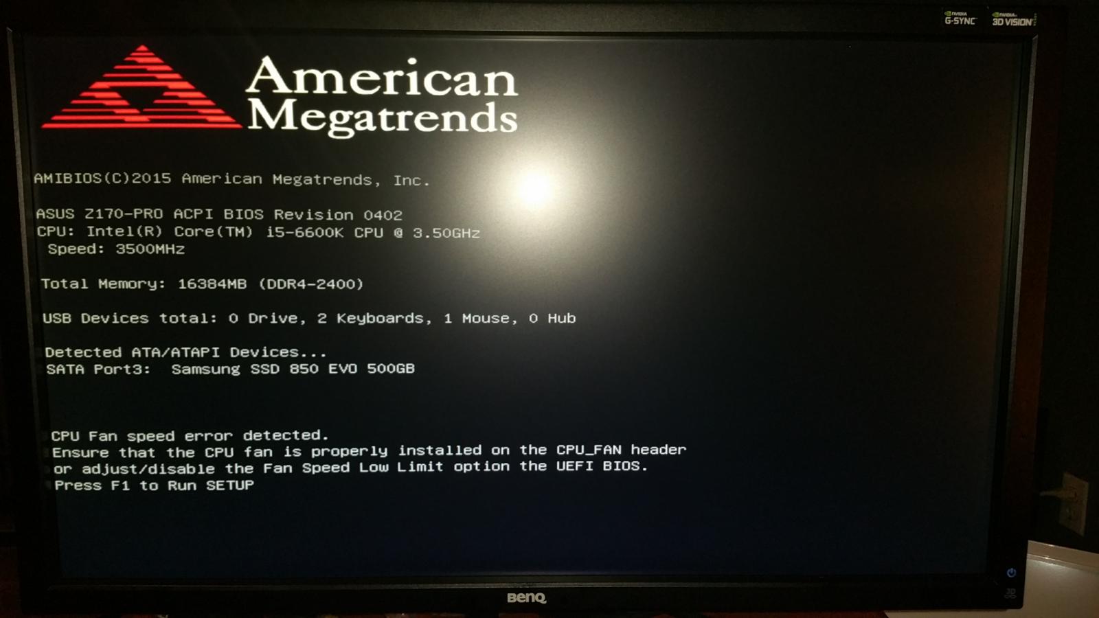

Yeah im getting a cpu fan error on boot...oy
"Ensure that the cpu fan is properly installed on the cpu_fan header or adjust/disable the fan soeed low limit option in the uefi bios."
Just disable the low limit option.

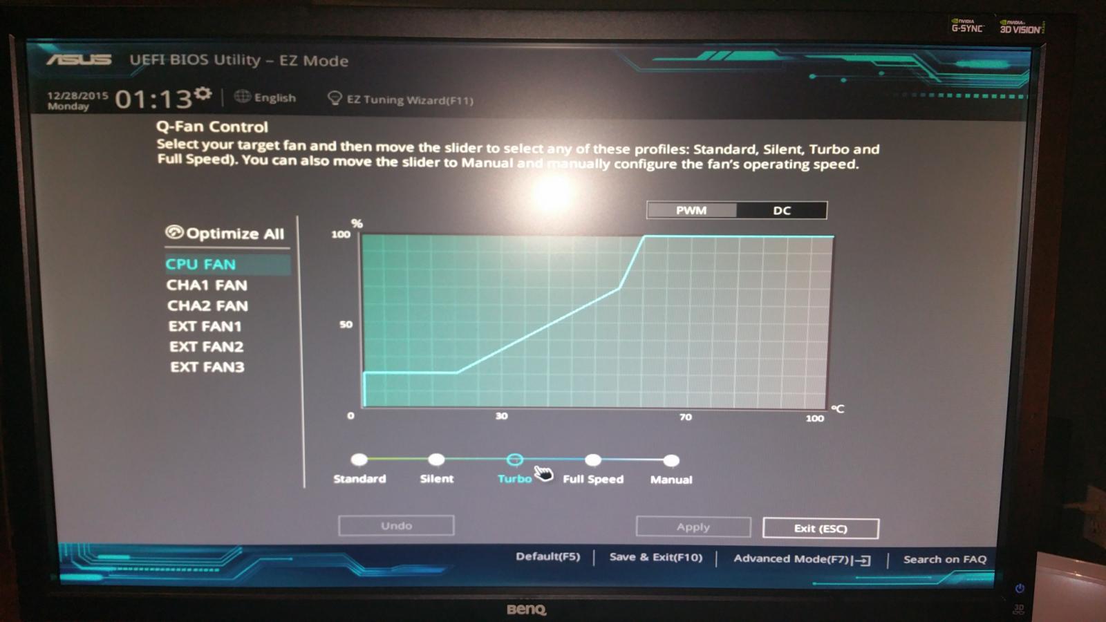

Ok...just having a hard time finding that. All im seeing us Q-Fan Control with presets or manual control, and an Optimize All routine. Will keep looking..unless im supposed to just increase the minimum speed, but I have no idea where to put it.
There should be a low limit option.
Ah, it was in a drop down menu in the monitor section. So I set it to ignore and still got the error. Guess I'll try increasing it instead..? Should I change the mode or profile? Its on PWM and Turbo right now. Hell should I disable Q-fan entirely or what?

Q-fan is just a preset. If you want to customize the fan speeds, you can do so.
Not sure what Turbo is--can you post a picture?
Here's what I'm working with...
What's the drop down menu for CPU Fan Profile?
Standard, Silent, Turbo, Manual. Tried manual with no luck. Heres the exact error btw. Maybe I need a different kind of fan hub? I read some only work at full speed or something.
Does the fan error stop the system from booting into the OS?
