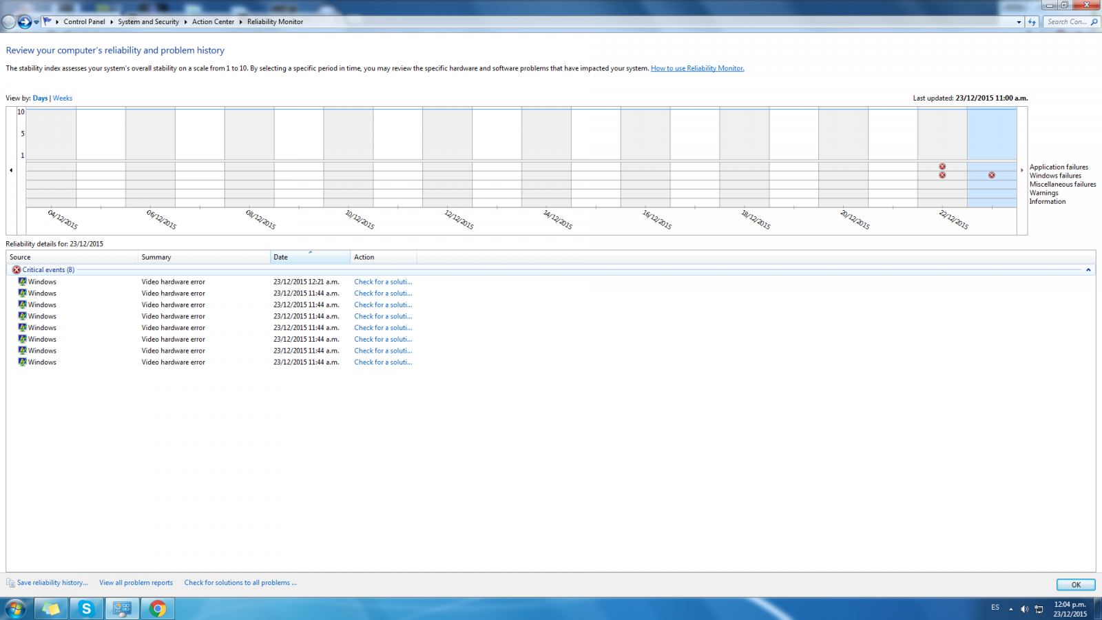

Here are the error reports that appear on the reliability monitor
Source
Windows
Summary
Video hardware error
Date
‎23/‎12/‎2015 12:21 a.m.
Status
Report sent
Description
A problem with your video hardware caused Windows to stop working correctly.
Problem signature
Problem Event Name: LiveKernelEvent
OS Version: 6.1.7601.2.1.0.256.1
Locale ID: 11274
Extra information about the problem
BCCode: 117
BCP1: FFFFFA800A01F4E0
BCP2: FFFFF8800F1B3E80
BCP3: 0000000000000000
BCP4: 0000000000000000
OS Version: 6_1_7601
Service Pack: 1_0
Product: 256_1
Bucket ID: X64_0x117_Tdr:2_IMAGE_nvlddmkm.sys
Server information: 00a54269-34c8-4f42-b362-2426f776e288

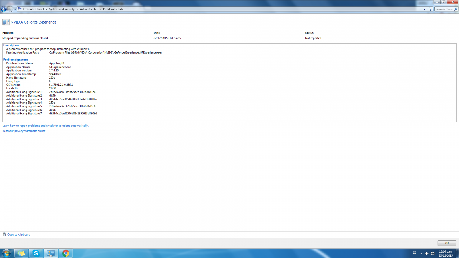

After i updated my drivers i wasn't getting any crashes but my monitor didn't receive any signal, but the pc didnt crash, i could hear the game sounds and everything when using my splashtop from my phone, i saw an error message saying the gtx 960 is not an ejectable device, it can't be ejectable or unplugged.
At first i thought it was my ram, then i runned a ram test, everything was ok with my ram, then i thought it maybe was the ssd but after getting these error reports i was thinking about my graphics card or my motherboard, btw i wanna point out that when i turn on my pc, it boots twice, the second boot is succesful, but my oc is not applied, i have to save my configuration and boot again, then it boots with my settings, as well that i have to boot manually on my ssd because if i just let the pc boot by itself, after post it boots on my hdd, i even changed settings and stuff, but it didnt work, im thinking of a hardware problem more than a driver problem, can anyone help me? Please i would appreciate if someone helps me get a clue on whats going on with my pc.
