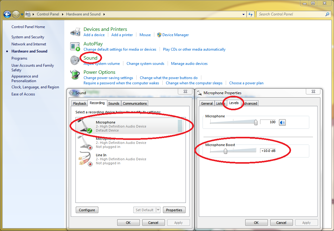

It might also be that the mic is simply not sensitive enough. If you go into the Control Panel -> Hardware and Sound -> Sound -> Recording -> Right click on the connected mic -> Levels then you can increase the "microphone boost". It will make the volume sound louder, but you usually sacrifice some audio quality.
Here is an image explaining what you should press.
