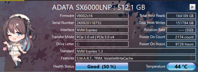

Hey so I just bought a 1TB SSD to replace my old m.2 which is a Adata SX6000 LNP/Lite, For the new one I bought a Teamgroup MP44L for around 876K IDR is it a good m.2 SSD? I'm on a low budget around 1.2 Million IDR and my country doesn't have that much good prices Especially for tech stuff. Also wanna know whether the SSD will work on my motherboard which is the Asrock A320M HDV-R4.0. The reason I'm replacing my old m.2 is its 5 years old now, The health is at 50% according to crystal disk, My boot times are slow from around 10 Sec to 12 now, sometimes it black screen first then It shows me the windows login screen. I just wanna know whether its a good SSD at that price or I could've bought something better and does it work on my motherboard.OLderssd.png.ee415e2fa4284db0bd9cb0279bcfce66.png
Yep, decent SSD and it'll work.  They are backward compatible.
