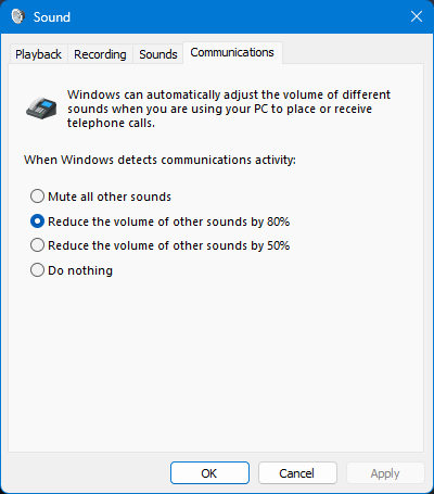

Check on your sounds settings. Sound, communications tab

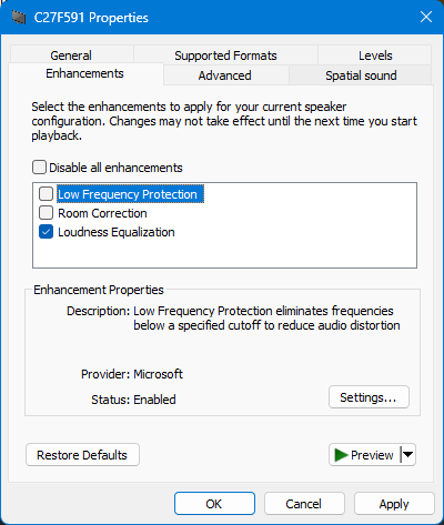

4 hours ago, biswadip.sh said:
I did all of it but its not as clear as my laptop but rather just increased bass.
the area hes talking about
right click your speaker icon and click "sound settings"
then scroll down to advanced section and click "more sound settings"
now click "communications" it should be set at "do nothing"
as for bluetooth usb adapter it was a bluetooth 5.3. tp-link i believe. but remember i said your issue is similar but not exact. id verify if its just a setting messed up first
https://linustechtips.com/topic/1616097-muffled-sound-in-game/#findComment-16755706

Yes, i did that but it didnt solve my issue, anyways thnx for the info really appreciated.
