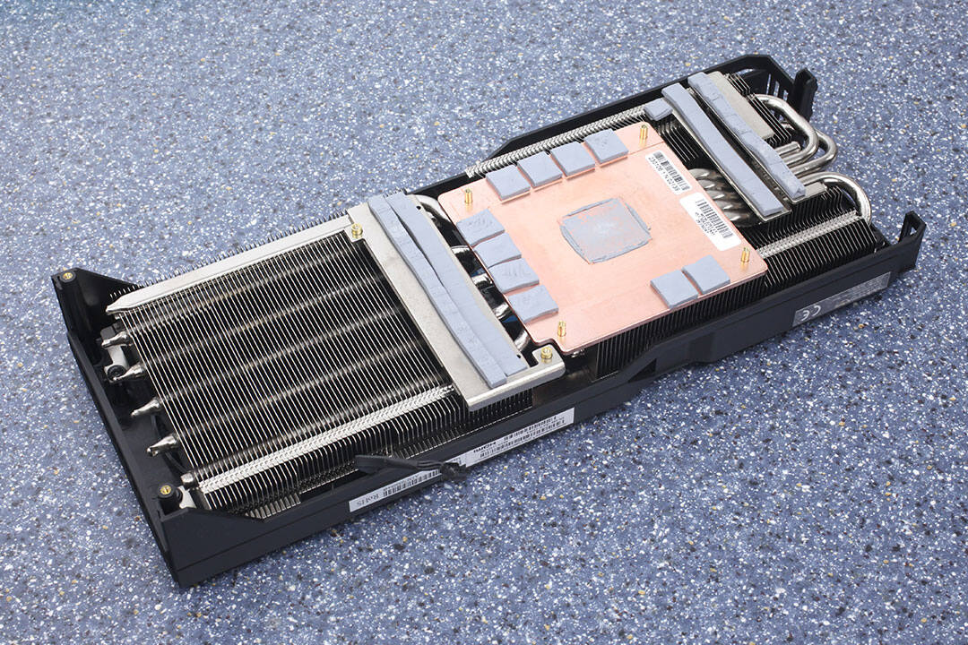

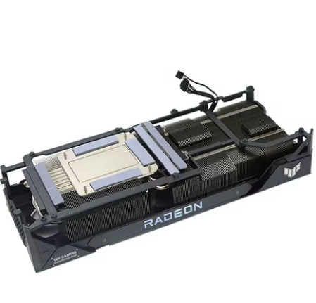

36 minutes ago, OdysseyMayn said:
I have the Sapphire 7900xtx Pulse, the heatsink isn't keeping the card temps low enough for me, Could I mount a Asus OC 7900xtx Heatsink and fan frame on the card? Gave the 2 photos of the 2 separate
 card heatsinks
The other heatsink isn't going to do much better, if at all.  The cards run hot.
Doesn't look like it's an exact fit though, some pads not same places and the rigid supports on the bottom one.
 card heatsinks
Repaste with PTM or liquid metal.
Replace the fans with desktop 120mm fans if the card is long enough for that.
https://linustechtips.com/topic/1616095-7900xtx-heatsink-swap/#findComment-16754893
Where are the temps?
The pulse SPECIFICALLY is made to run very quiet whilst being well in limits of the gpu. You can simply make the fan curve more aggressive to compensate for that.
As for swap it barelt makes a difference. the asus card runs a couple degrees cooler and thats because its fans run harder.
If you are under 100c you are doing great hardware these days is MADE to run as fast as possible in a thermal/power budget. This is intended behavior. Making it run cooler doesnt do anything at all.
