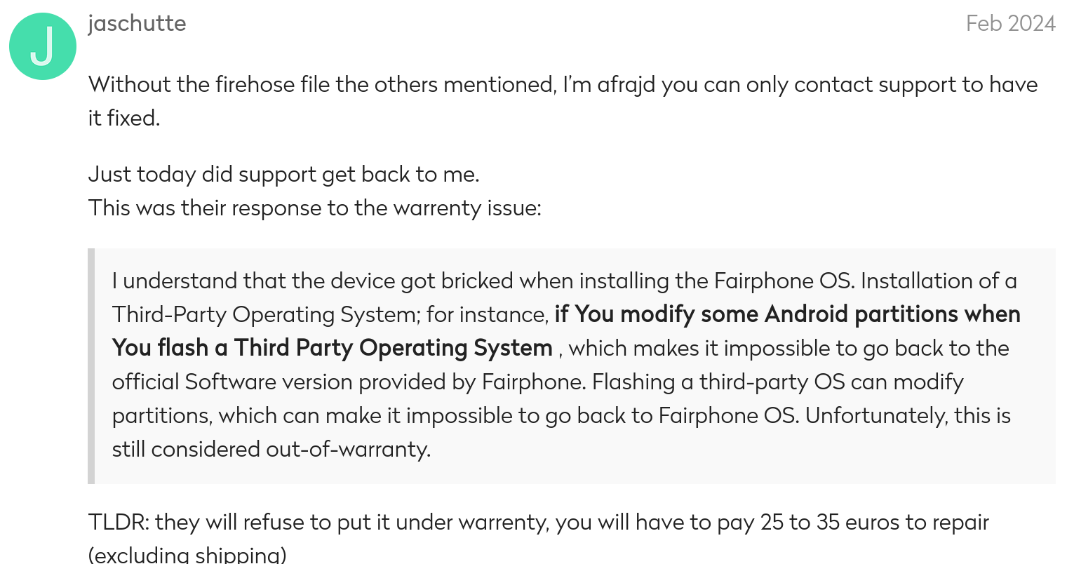

Then tell them that! Tell them you messed up doing a install and seem to have bricked the bootloader. Ask if they could fix it if you send back the device and pay for the work hours it would cost.
Thats all you need to do. Nothing else. The hardware is fine. The firmware is just fucked and fairphone themselves can unfuck it as they have all the tools. Theyve done that before and will do it again.
Dont ask for soldering stuff or whatever thats not needed they have all the tools needed to reflash bricked hardware.
