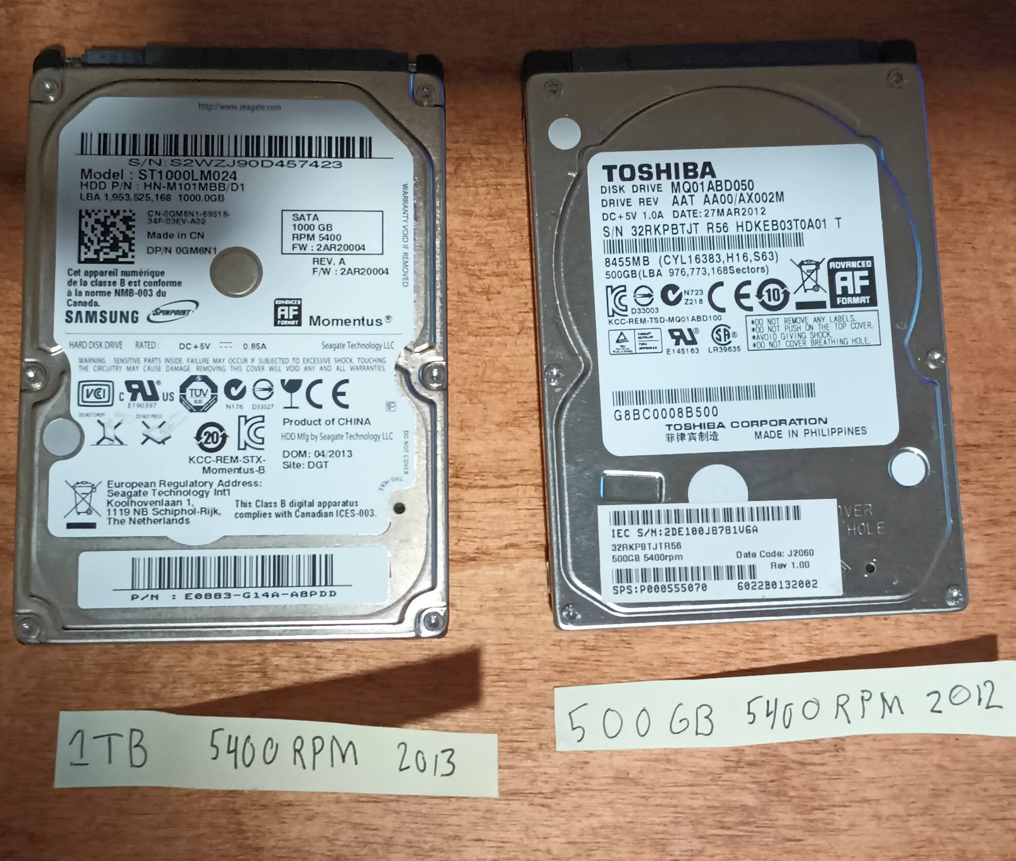

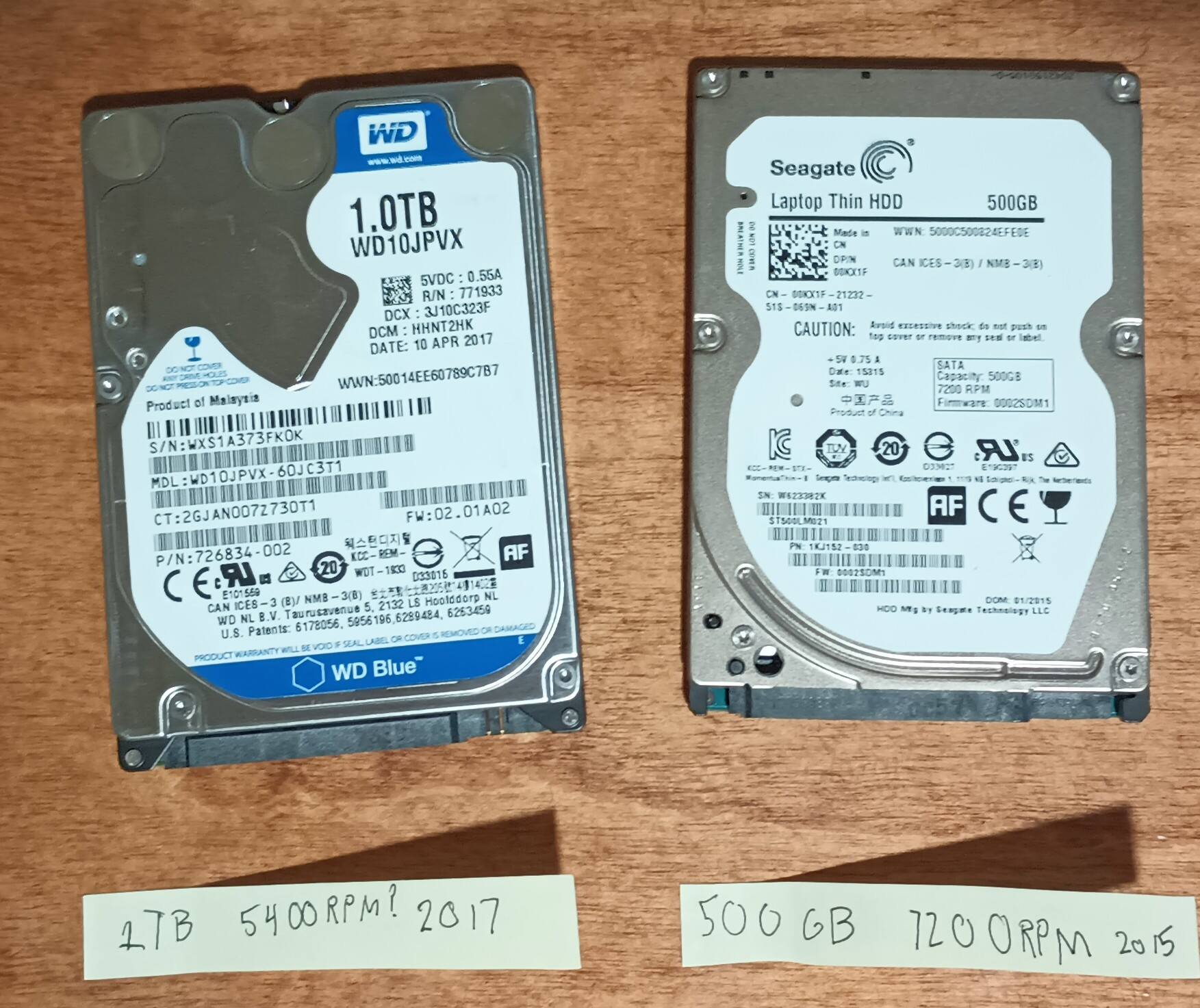

Out of the four hard drives, which would be the best for media storage(pictures, audio clips, etc)? I am hoping to use the two on the left sides of the pictures, but not sure if the age of the 2013 one will be an issue.
They can all last another 10 years or just another 2 months.  Its hard to tell with old drives, not knowing how much read /write and the amount of hours they have.

Run CrystalDiskInfo on them all... see what warnings, if any, are reported.
Pay particular attention to "Powered on Hours"
The top two are S-ATA 6Gbps, the bottom two are 3Gbps... if that helps

If the data is important, and new drives weren’t an option, I’d probably use all 4 in some kind of Raid arrangement, maybe using something like ZFS anyraid.

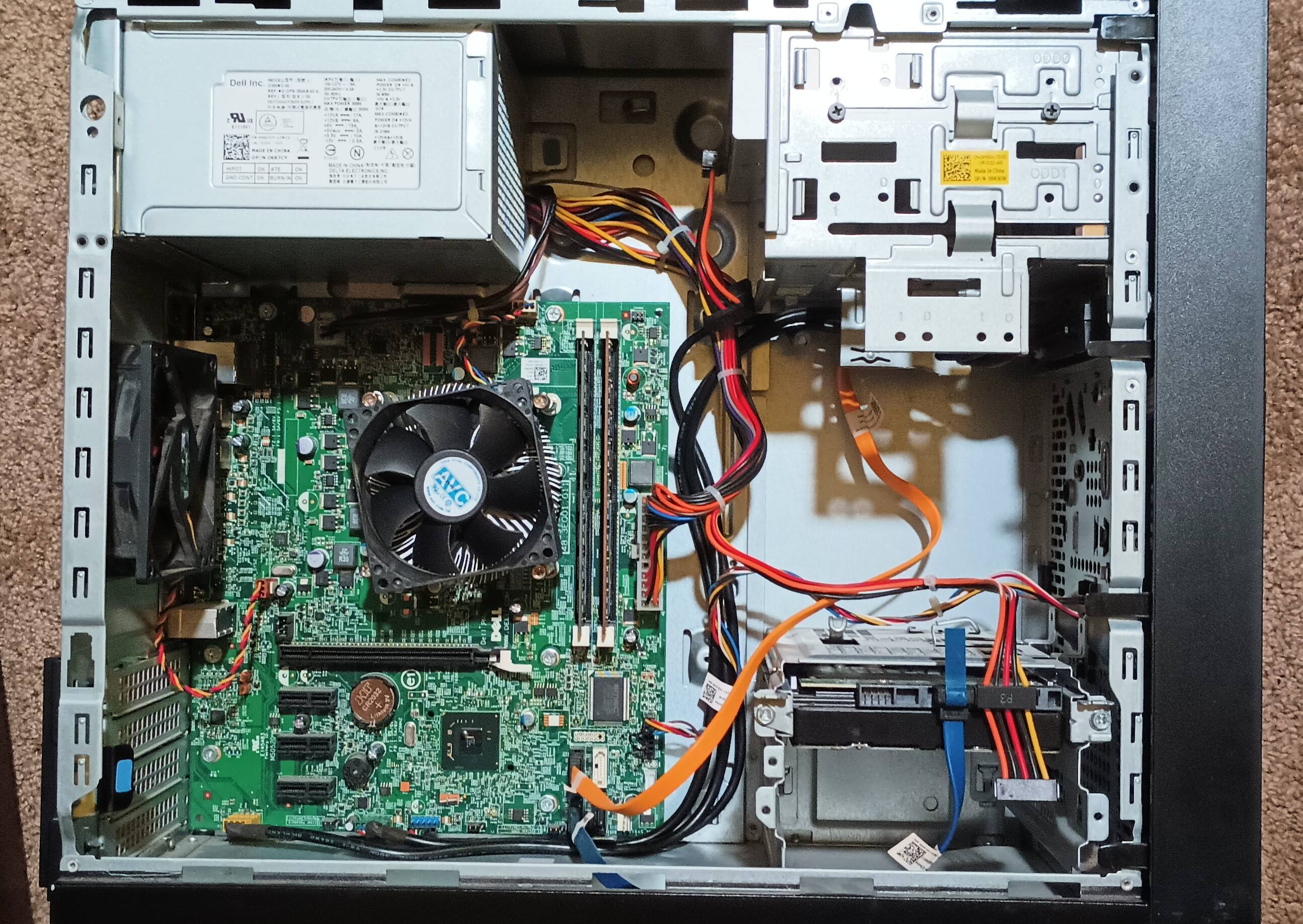

Is it possible to run that alongside my normal os(Win10)? I have an old pre built I could use, but it lacks mounting places for the drives.IMG_20250623_211339160.thumb.jpg.ea58b51f5915b864d2b4009b941bf323.jpg

Probably not very easily, but Windows 10 might still leave some easy and good options. How much data do you actually need to store?

ZFS anyraidz1 would be my recommendation if you have that option. It would use all the space on all 4 drives, but also can withstand 1 failure.

That seems impossible. You *must* loose space for parity calculations.

To clarify, when I said "It would use all the space on all 4 drives": I mean the array will use all the available space. I didn't mean that all of the space will be usable storage.
For example, with RaidZ1, the array only extends 0.5TB of each drive would be in use because the smallest drive is 0.5TB. The result is a 2TB array, where 1.5TB would be usable. Meanwhile with AnyRaidZ1, the array uses all the available space, so that's a 3TB array, and 2TB of usable space (as I understand it).
