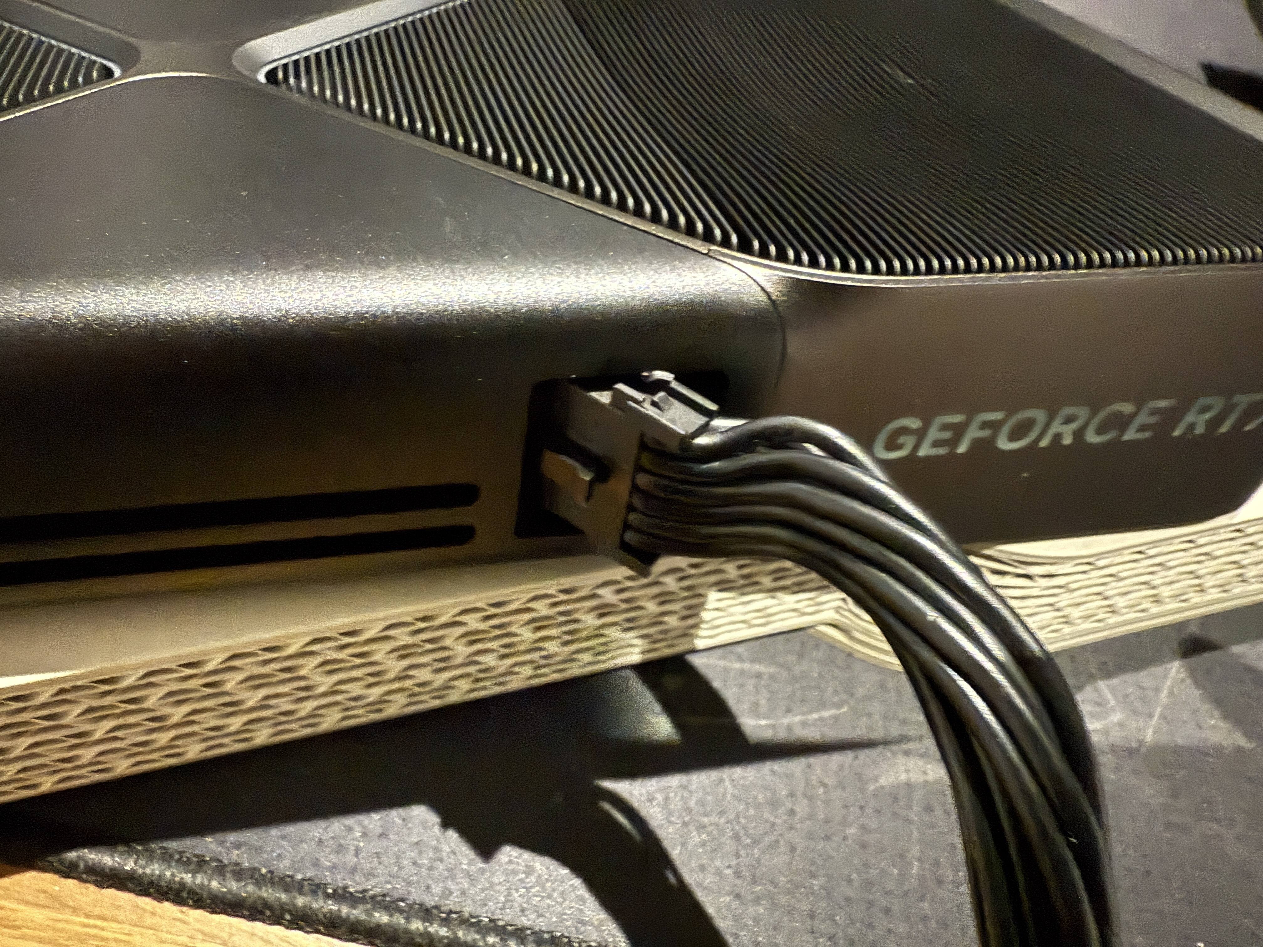

I’ve recently picked up an RTX 5090 Founders Edition and I’m running it with a CoolerMaster MWE Gold V2 1250W PSU. Unfortunately, I’m running into an issue with the included 12VHPWR cable from CoolerMaster.

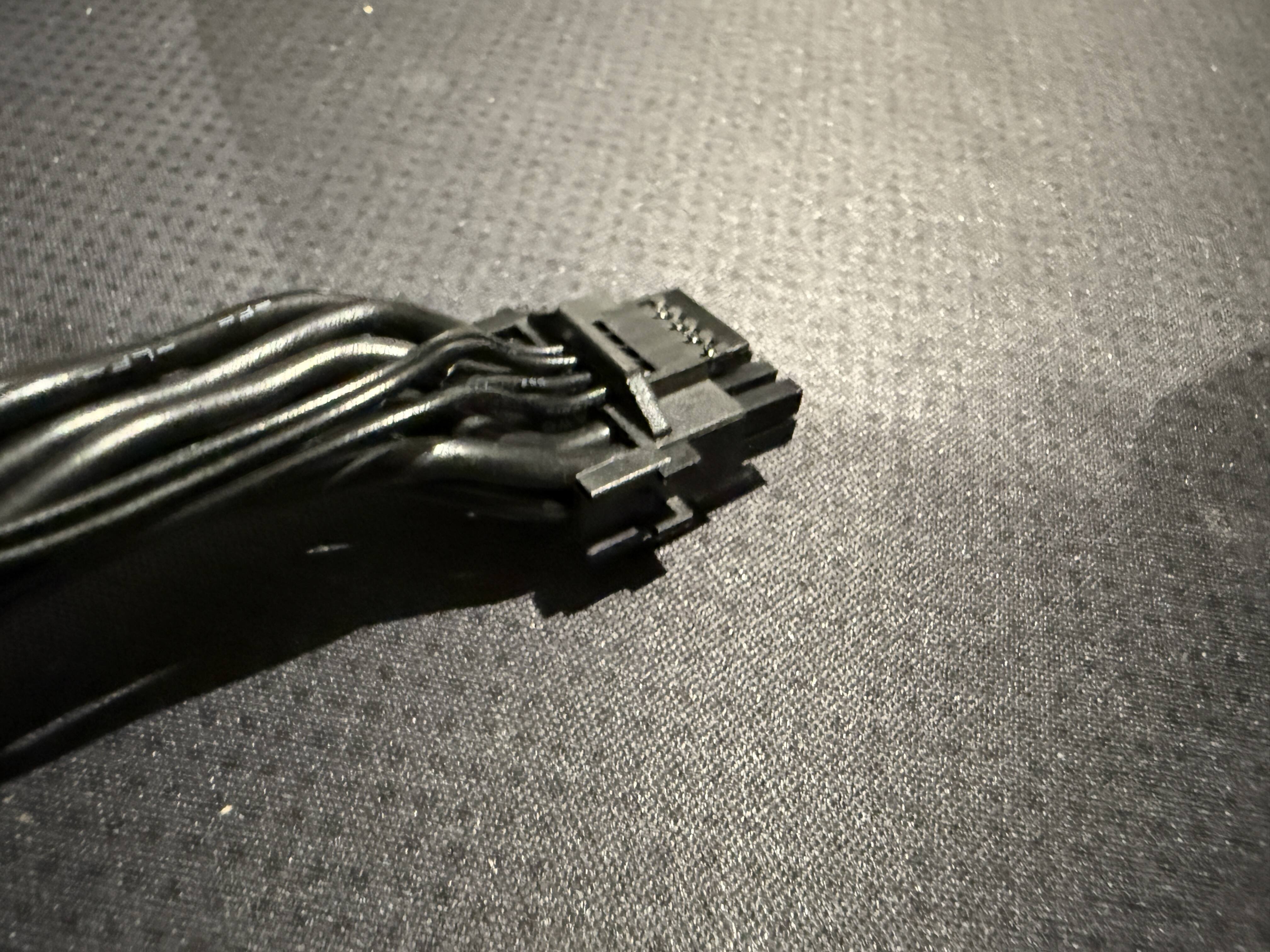

The cable is right-angled, but due to the design of the 5090 FE, it doesn’t physically fit. I contacted CoolerMaster support, and they advised that the right-angled connector has a removable plastic shroud which, when taken off, turns it into a straight connector. However, after removing the shroud, there’s still a plastic portion that sticks out just enough to interfere with seating it properly in the GPU. I can’t see a safe way to remove this extra bit without risking damage.

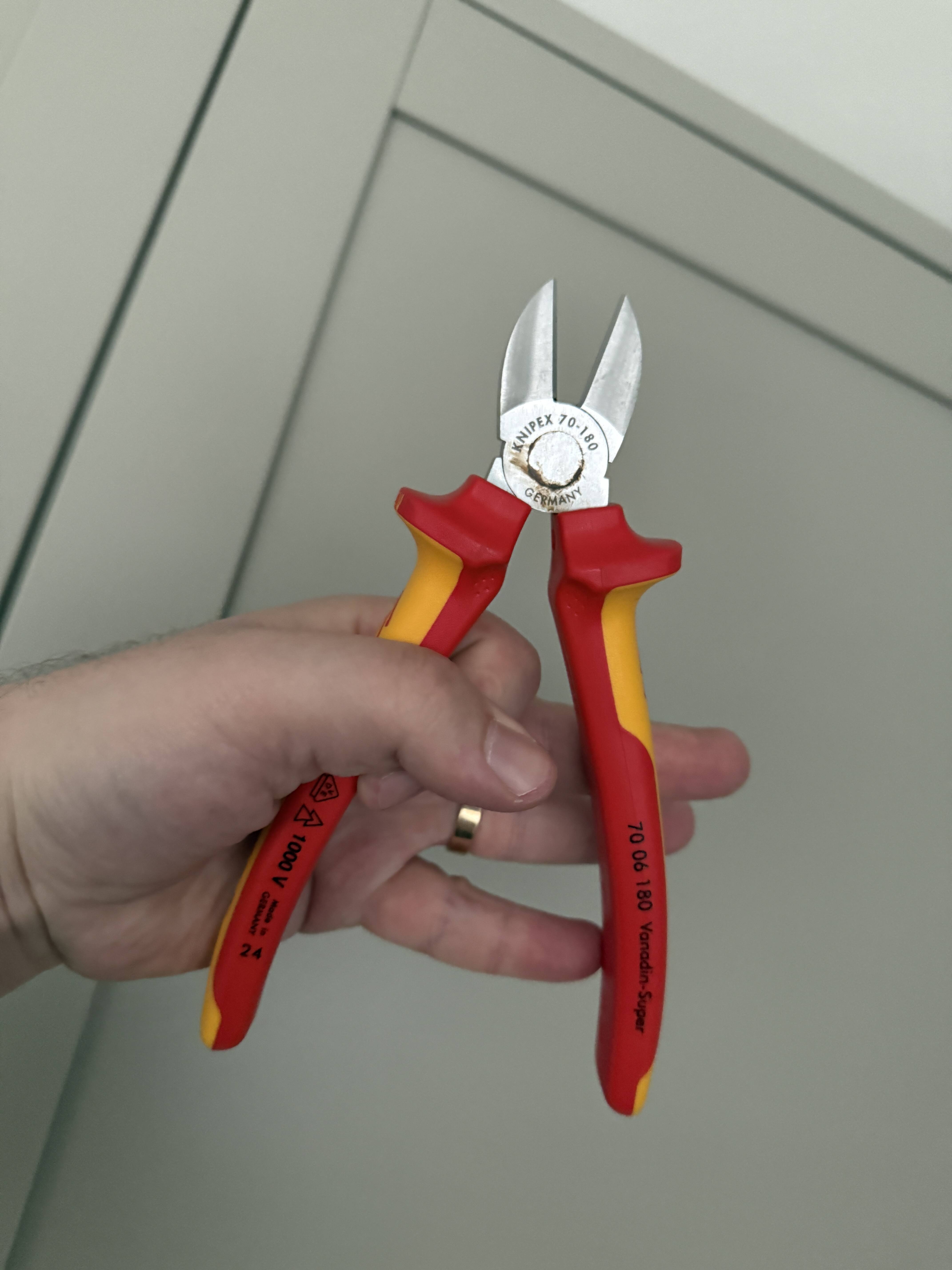

Got a pair of wire cutters? You should be able to snip it off. It's just plastic.
I can think of a half dozen ways to trim it, but wirecutters would be the best and safest

That all being said yeah, I'd just snip off the extra plastic.

Looks like it’s time to snip!
Will provide a progress update in the next couple of hours. (The joy of having a newborn, everything takes about 10x longer.)

Well it’s done, we are up and running! Going to run a furmark benchy for an hour just to make sure everything is peachy.
Thanks so much for your help.
