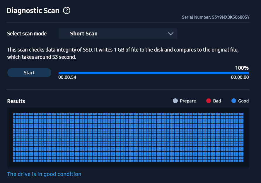

How full (and old) is your SSD? Make sure your SSD is the boot drive, not the HDD.

21 minutes ago, Folktale said:
Yes it is my Boot drive and it is almost 6 years old. 75GB free space
Maybe try a new SSD.

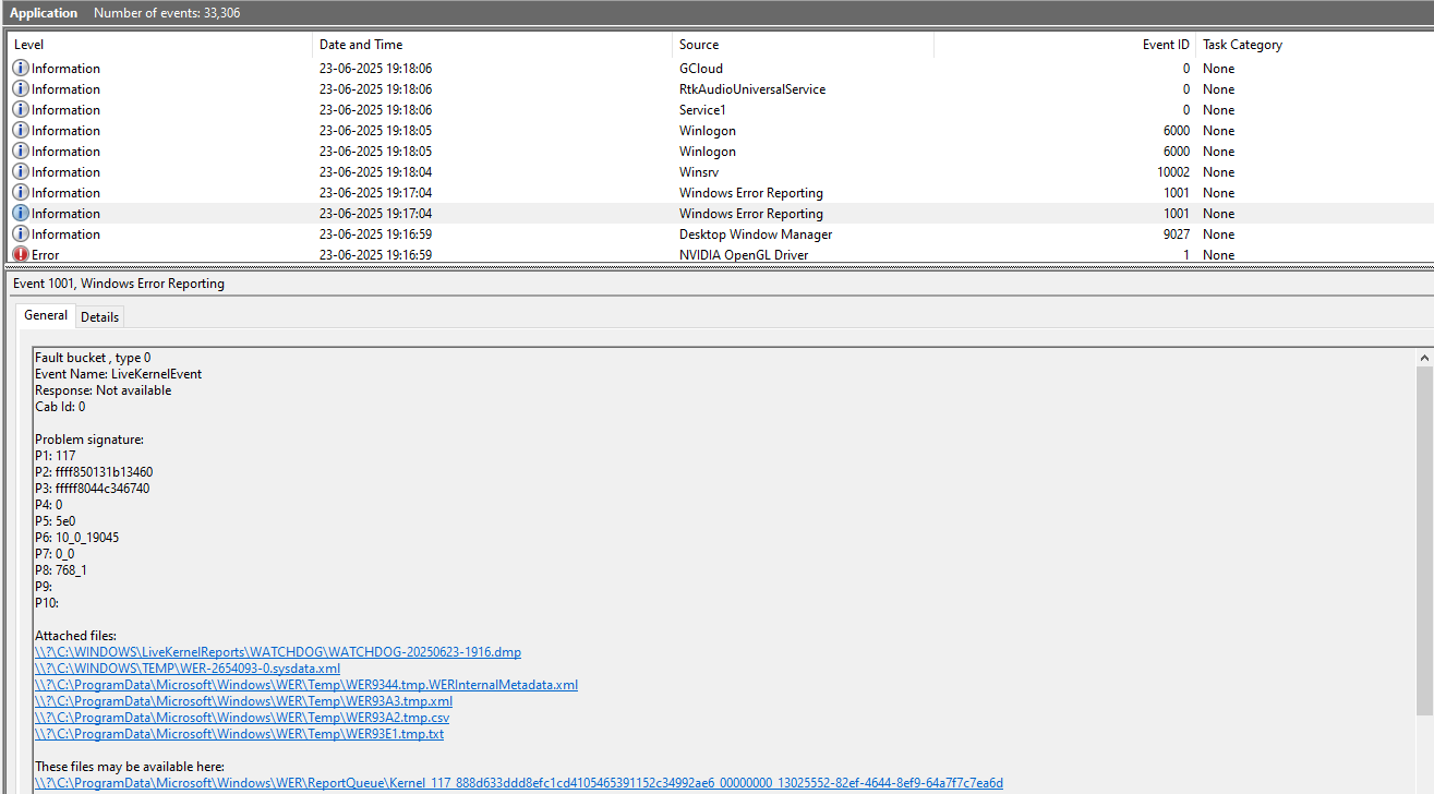

12 minutes ago, Folktale said:
yes there are some events but not sure which one
Is there anything within the 'System' part of the Event Viewer?
In my experience, errors within the 'Application' section usually show app crashes or crashes to desktop.
Windows Logs > System errors typically detail proper crashes like Blue Screens or system freezes.
Ignore the 'Critical' error that follows you power cycling the PC without doing a proper shutdown.
Personally, I'd get your files backed up to the cloud where possible, get a Win 10 install USB stick made up and do a fresh Windows install. I tend to find its the quickest way to rule out something more sinister.

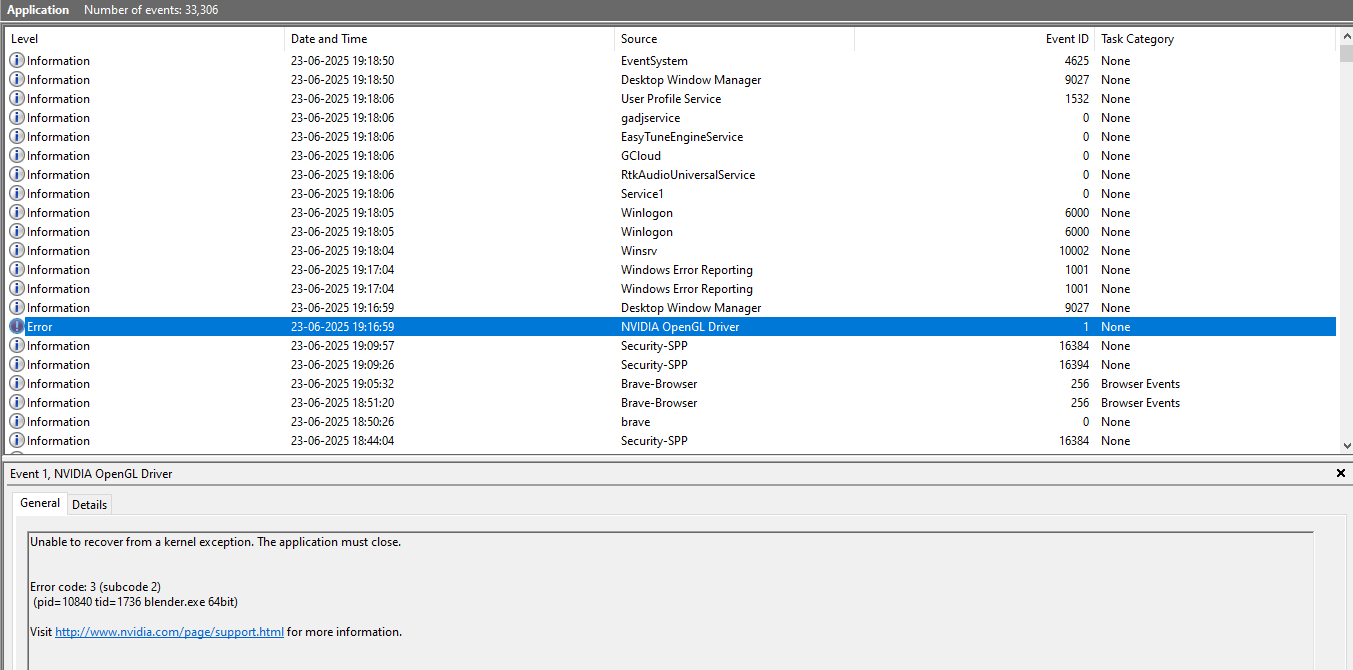

This is the only error I Found in System Log.
