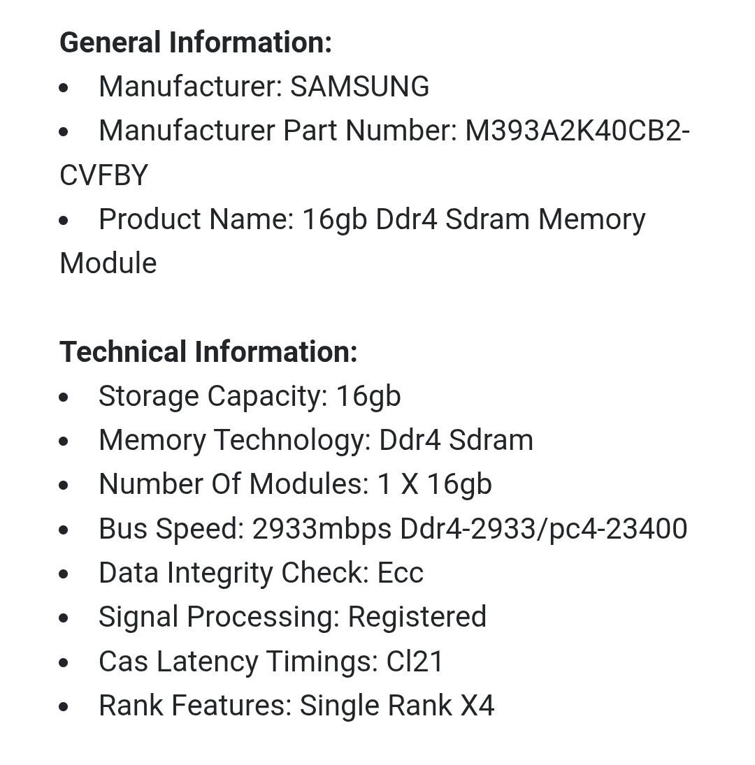

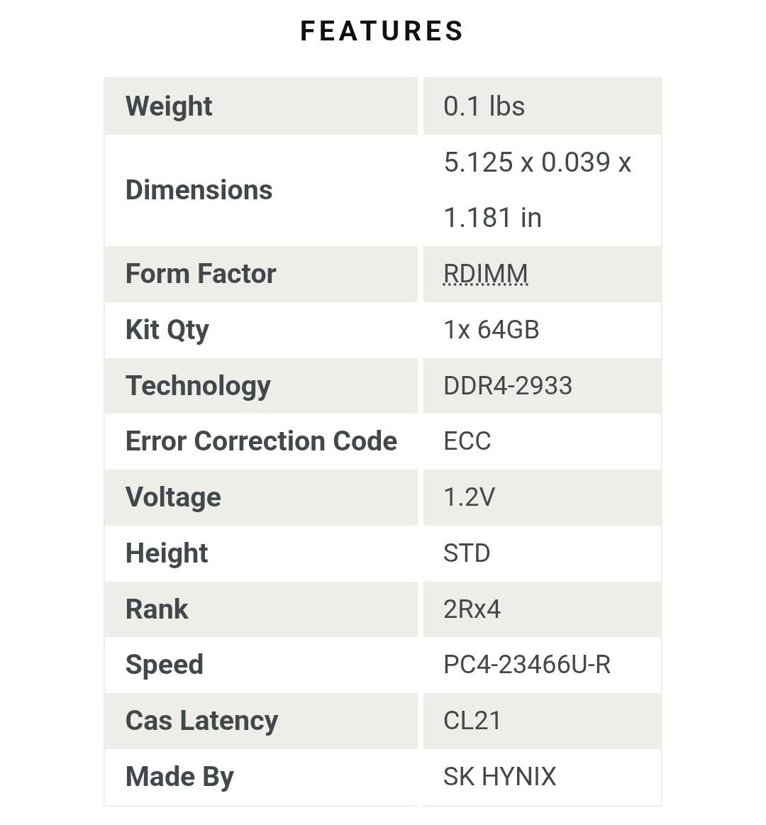

Hi all, im lucky enough to have a job that allows me to go to many different buildings all over the city i live in that also means I spend a lot of time in loading docks as a tech and get to do a lot of ewast dumpster diving which has lead to me getting a lot of free components for PC's. I have recently scored 3 hp-z4-g4's all only having 32gb (16gbx2) of ddr4 ecc pc4-2933y. But as of today in a different discarded server pc I found 8 sticks of 64gb ddr4 ecc pc4-2933y but they are also slightly different speed of ram. The 16gb sticks are samsung  pc4-23400 and the 64gb sticks are sk hynix pc4-23466-r, I have tested the new sticks in the pcs with it throw out a ram error code at me as they seem to not agree with the new ram. Now I some what understand the the 23466-r is a faster speed but I do not understand why it won't work with the system I did only use the 2 sticks out of the 4 stick set so im not sure if that would be the problem or if its just incompatible with the chip set on the mobo cpu combo that these HP's have. Im hoping someone can help shed some light on the problem as im new to the home lab seen and server gear is a bit out of my realm of knowledge.

Ok that makes sense, Im guessing thats what the -R stands for on the end of the 64gb stick speed. unfortunately i checked the specs on them after I got them, but luckily they are from ewast so didn't brake the bank getting them and may come in handy down the line if I ever find another server that takes registered dimms.

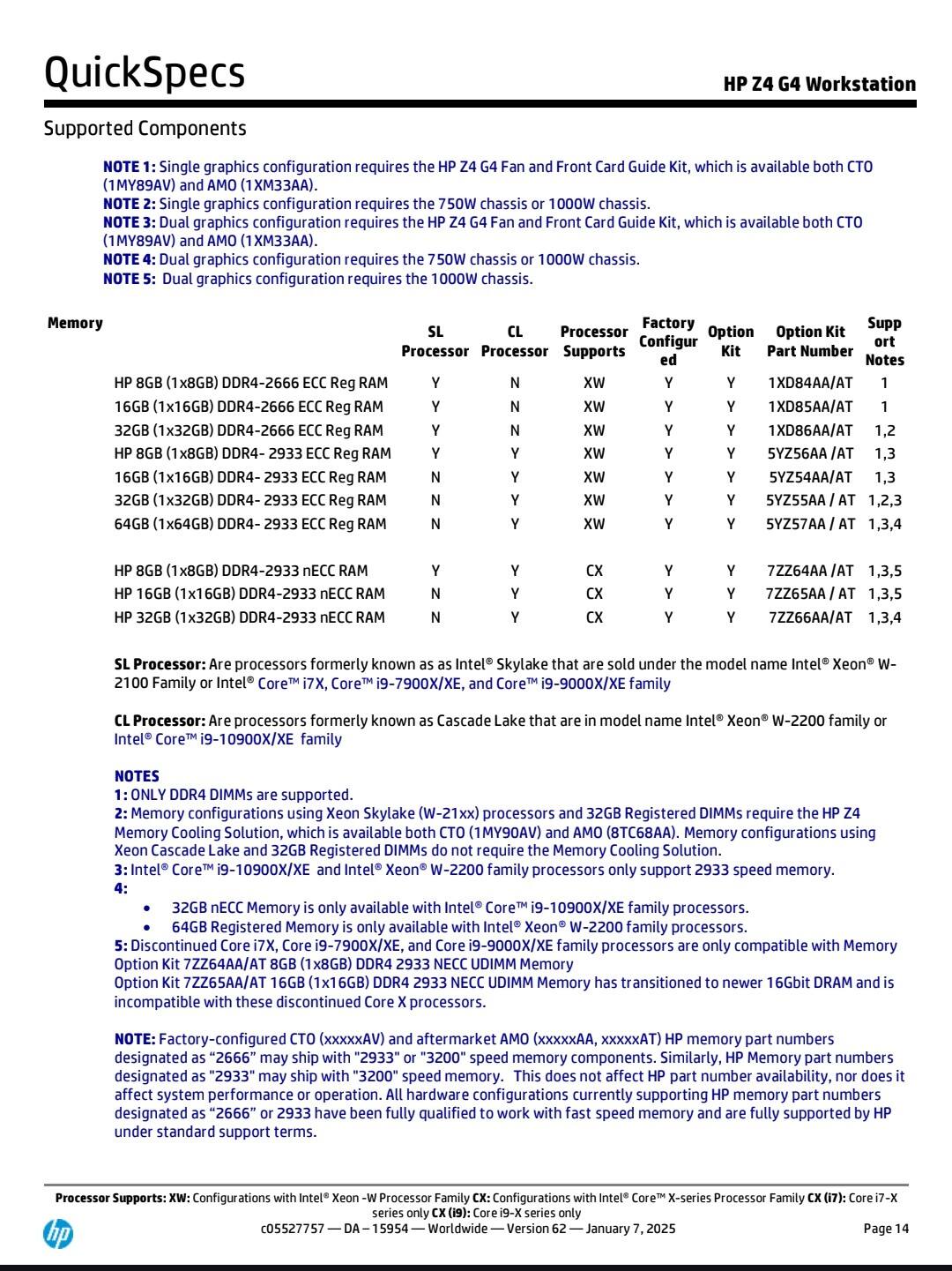

Screenshot_20250624_124307_Chrome.thumb.jpg.fc0bf66e527a646a5dddfb6254b8519c.jpgFor anyone still playing along at home or looking for the answer to this or a similar problem I have found the answer. I was lucky enough to suble upon a hp spec sheet for the z4g4 thats not on there website that had all the answers, it turns out that the problem is the cpu being a w-2135 it will not support dimms higher then 32gb (see note 2 on attached photo). After double checking the in bios today found out that it dose infact have that cpu and not a w-2235 which would support the 64gb ram sticks. So i guess the solution would be to get the correct cpu in this particular case that would then allow the use of the higher capacity of ram. I definitely learnt a lot about ram today in trying to trouble shoot this problem and will most likely promptly forget 90% of it.  Thank you to anyone who responded it definitely drove me to find the fix.
