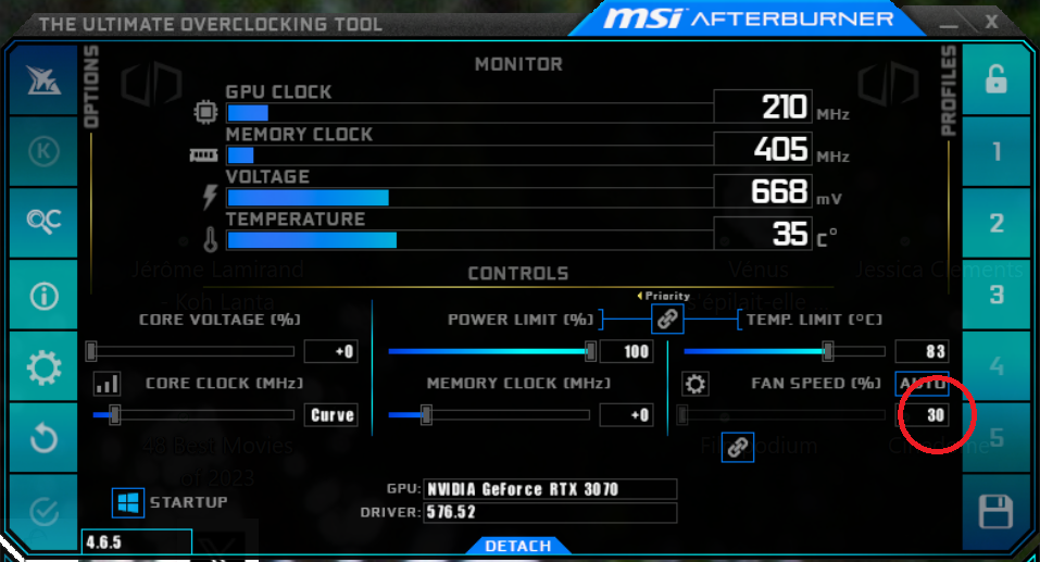

Just an idea,
I believe Afterburner reports the fan set percentage.
So do you see a set value higher than 0 while your fans aren't turning (while afterburner is set to manage the fans) ?
Or you could just play manually with that ruler by clicking Auto
(It seems you need to hit Apply each time you change something)

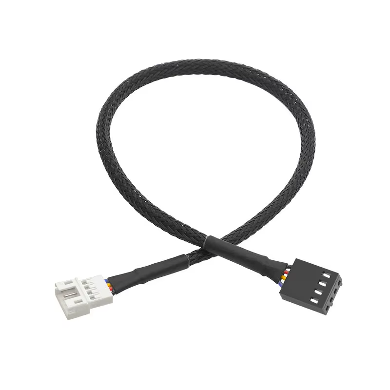

Could you try to plug the GPU fans to a mobo header (maybe with a splitter as cables may be too short) ?
Also maybe the fans just aren't properly connected to the GPU fan header
Posted (edited)
GPU fans have another header than standard fans, they need such a converter.
(It's very unlickely that 2 or 3 fans fail 100% at the same time so it's very lickely the fans would spin.)
