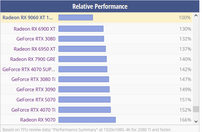

I meant the Radeon 90 series cards are barely faster but a lot more expensive.
Barely faster than what?
Only 9060 XT though, 9070 is faster than 3090.
3080Ti, no, 1080Ti, yes.

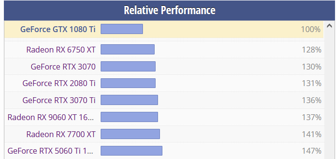

Why 3080Ti? It's not a bad card though.
There are other GPUs that are ~50% boost or higher in average performance:
  • RX 7700 XT
  • RX 6800 (XT)
  • RTX 4070
  • RX 7800 XT
  • RX 6900 XT/6950 XT
  • RX 7900 GRE
Or if you don't mind smaller boost, like ~30%, there's:
  • RX 6700 XT/6750 XT (these are 28% faster, but unlike Nvidia cards of similar "level" they have 12GB of VRAM instead of 8-10GB)
  • RTX 2080Ti
  • RX 9060 XT 16GB
Or you can get 3080Ti, how is your PSU? Wattage, brand, model?
3080Ti is exactly ~200% faster than 1080Ti on average. (doesn't always guarantee double fps, but it sure is significantly more)

25 minutes ago, podkall said:
What country you from?
Yeah, but 30-series used to have like the worst transient spikes though. But at the same time OP wants to buy 30- series card, so I guess that tracks.

it's from a gaming pc
I really appreciate your effort! I know the numbers - but ~20% more performance for 66% more money is not worth it in my opinion. (a 9070 is about 600€)
