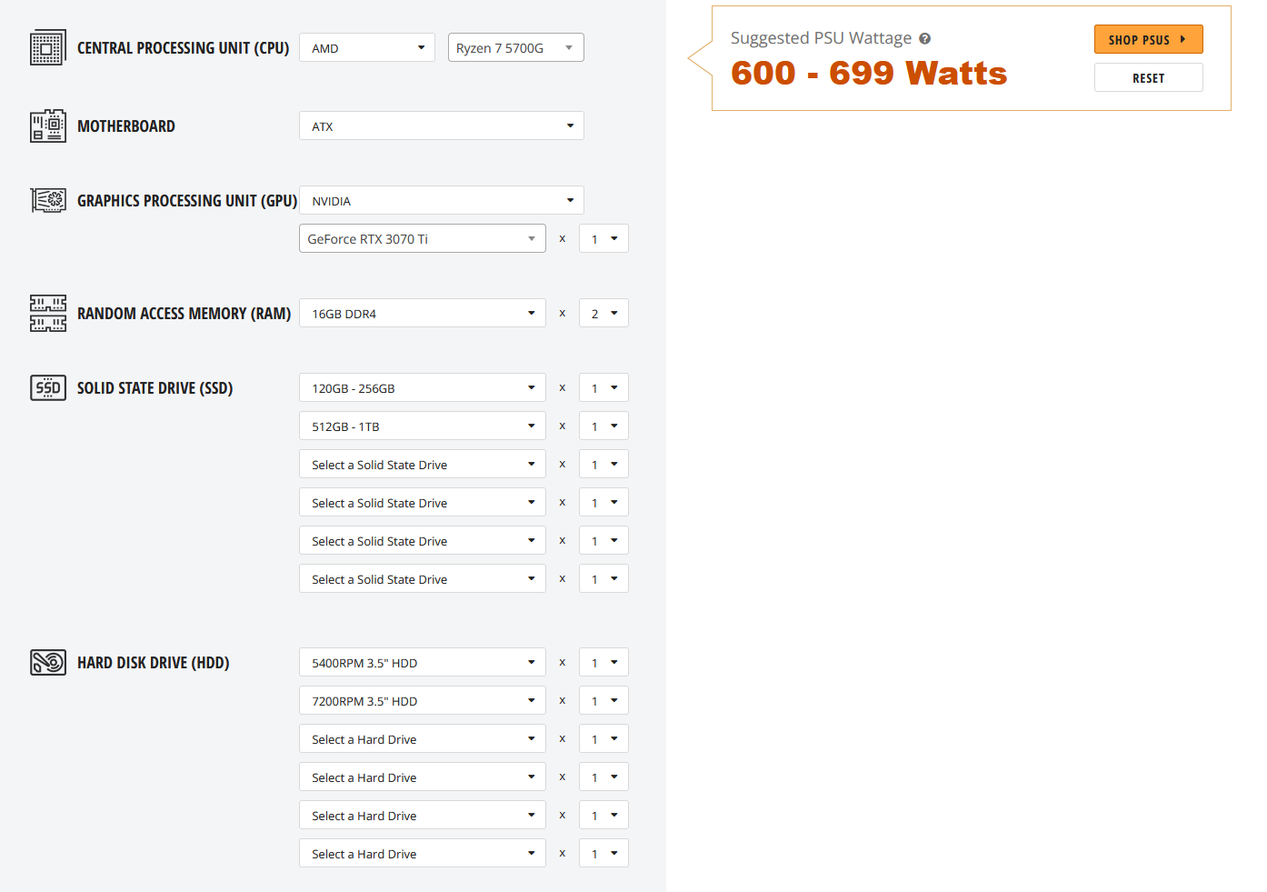

I'm upgrading from an RX 570 to 3070Ti, and according to the newegg PSU calculator, I should be fine as I have a 700W PSU. But the GPU manufacturer's recommendation is a 750W PSU.
The deal I'm getting is a 3070Ti cheaper than a 3070 where I'm living. The PSU I am using is Thermaltake Smart RGB 700W.
Is it better to spend a little extra and be safe with the 3070 or am I okay with getting the 3070Ti?
Thanks!
Thanks!

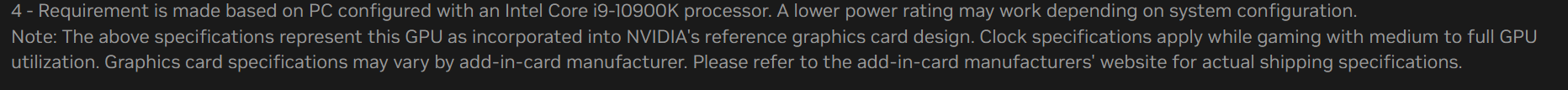

If you read the fine print on the nvidia website, it shows what they base the recommended specs on. In this case specifically, a 10900K system.
A 10900K uses 250W under load. Your 5700G uses 150w. You are fine with what you have.

But yes, you're right, I didn't consider the CPU's lower power draw. Let me have a look at the documentation again and see what the recommendation is based on.
