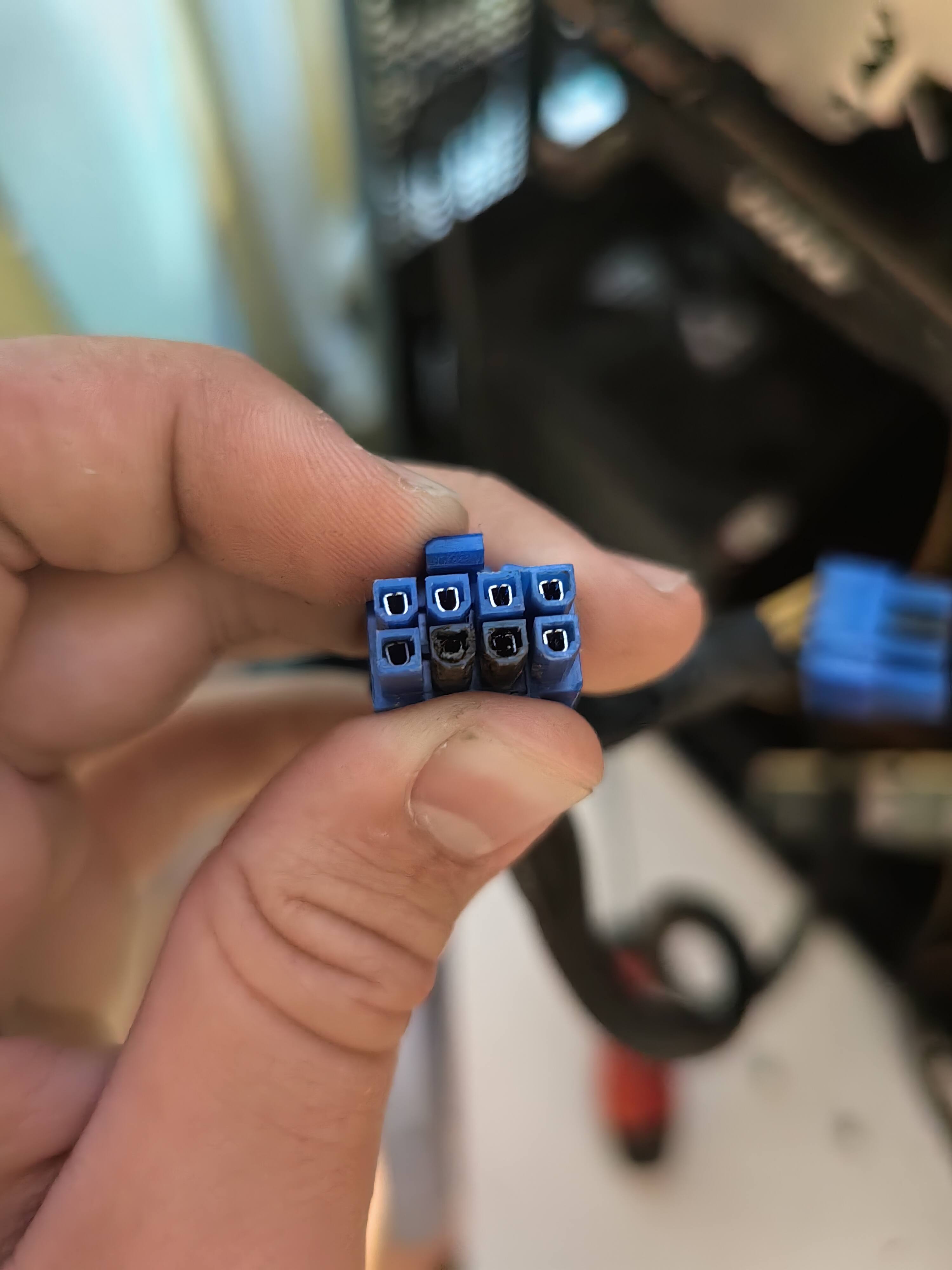

I pulled my GPU out and noticed that one of the power connectors is slightly melted from one of the cables (My PSU has 2x8pin + 2x8pin connectors)
My question is, would connecting 2x8pin from one cable be enough for my power hungry 1080ti?

Theoretically yes, but actually no. This is the main reason Nvidia decided to adopt 12V high power connectors as far as I'm aware. Modern GPUs are too power hungry to run off of one split cable. Normally the 1080Ti is fine with a split, but that's a pretty beefy overclock you got there and I wouldn't chance it.
Yes, if the PSU / Cables you are using are of good quality.
If you are using a shit tier PSU, don't.
Okay, so should I keep on using the burnt connector then? I'm not really in a financial state to buy a new PSU plus this one does the job... Maybe a repair shop?
Absolutely not.  Do not continue using the cable.

What PSU do you currently use?
I see blue connectors and that worries me.

That is indeed less than ideal..
Well, it is what it is.
I wonder how they fixed it after it went kaboom, that sketches me out the most.. But I guess it works right?
Yep, those aftermarket blue cables are usually quite cheap.
I would not reuse the burnt blue cable, thats for sure.
Use the 2x8pin on the original cable with the PSU and maybe remove your overclock?  Its already burnt one cable, though of questionable quality.

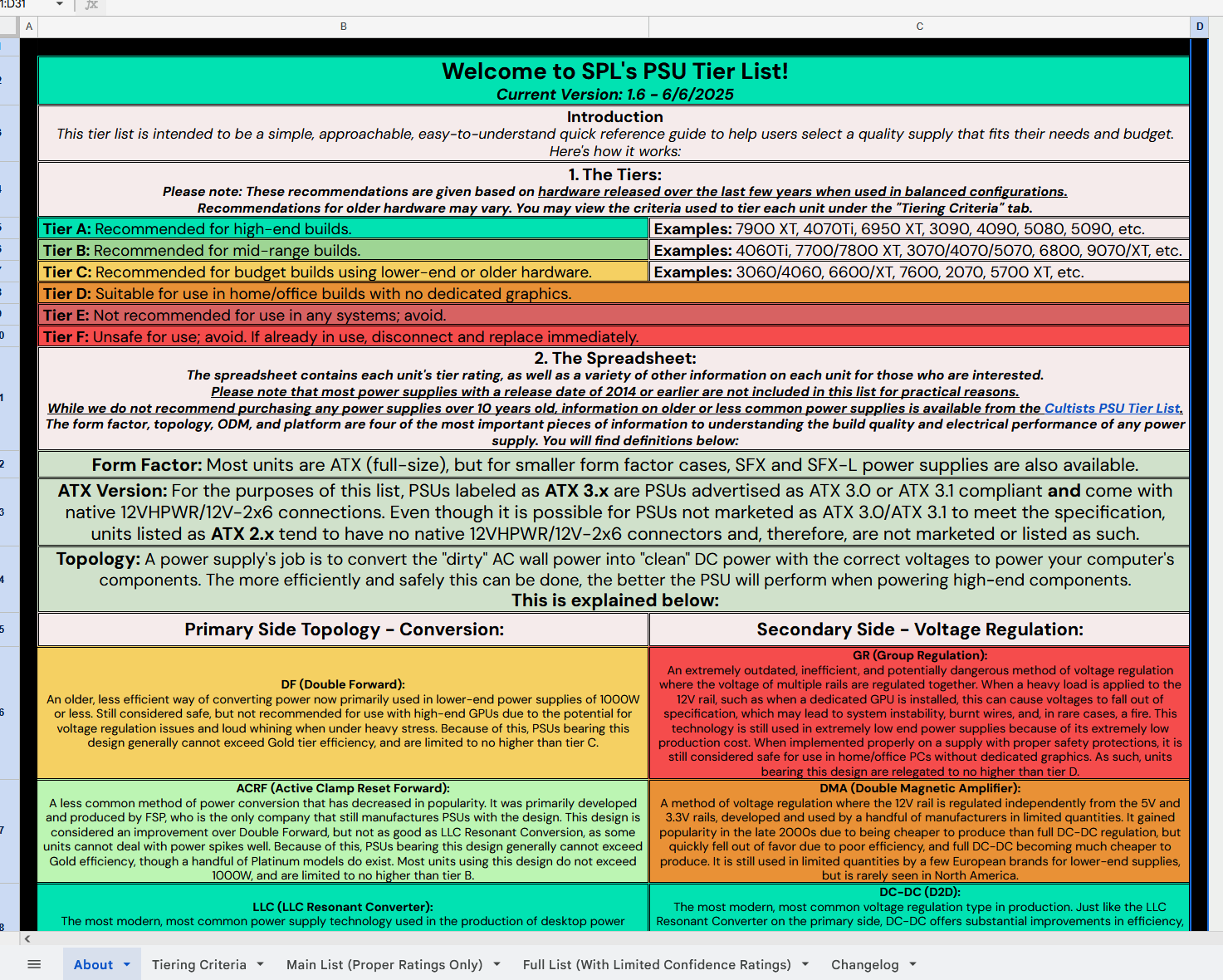

Here, we use this PSU Tierlist to check and read up on PSU's.
https://docs.google.com/spreadsheets/d/1akCHL7Vhzk_EhrpIGkz8zTEvYfLDcaSpZRB6Xt6JWkc/edit?gid=1973454078#gid=1973454078
At the bottom / top you can check the ABOUT and Tiering Criteria if you want to learn more.
