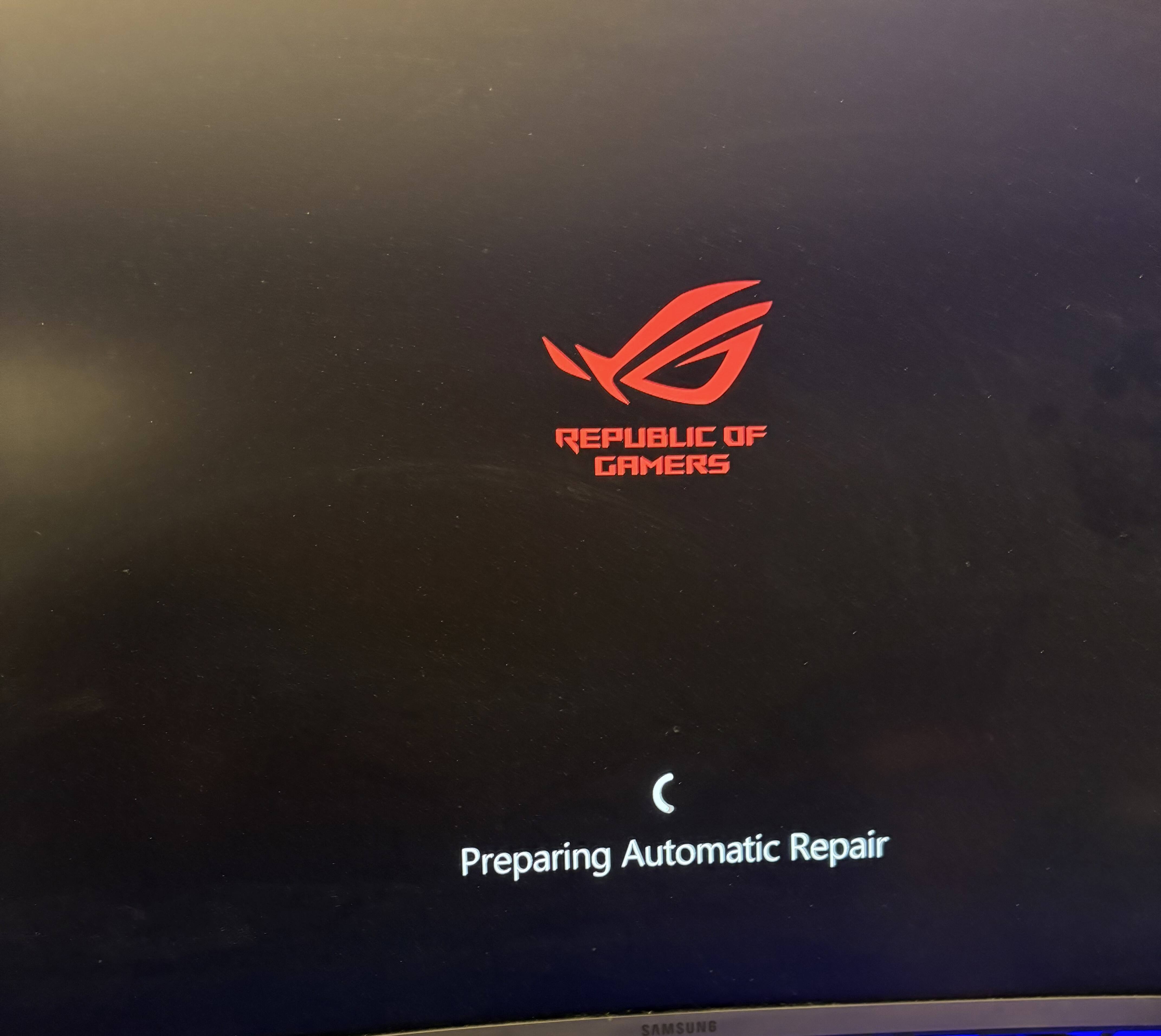

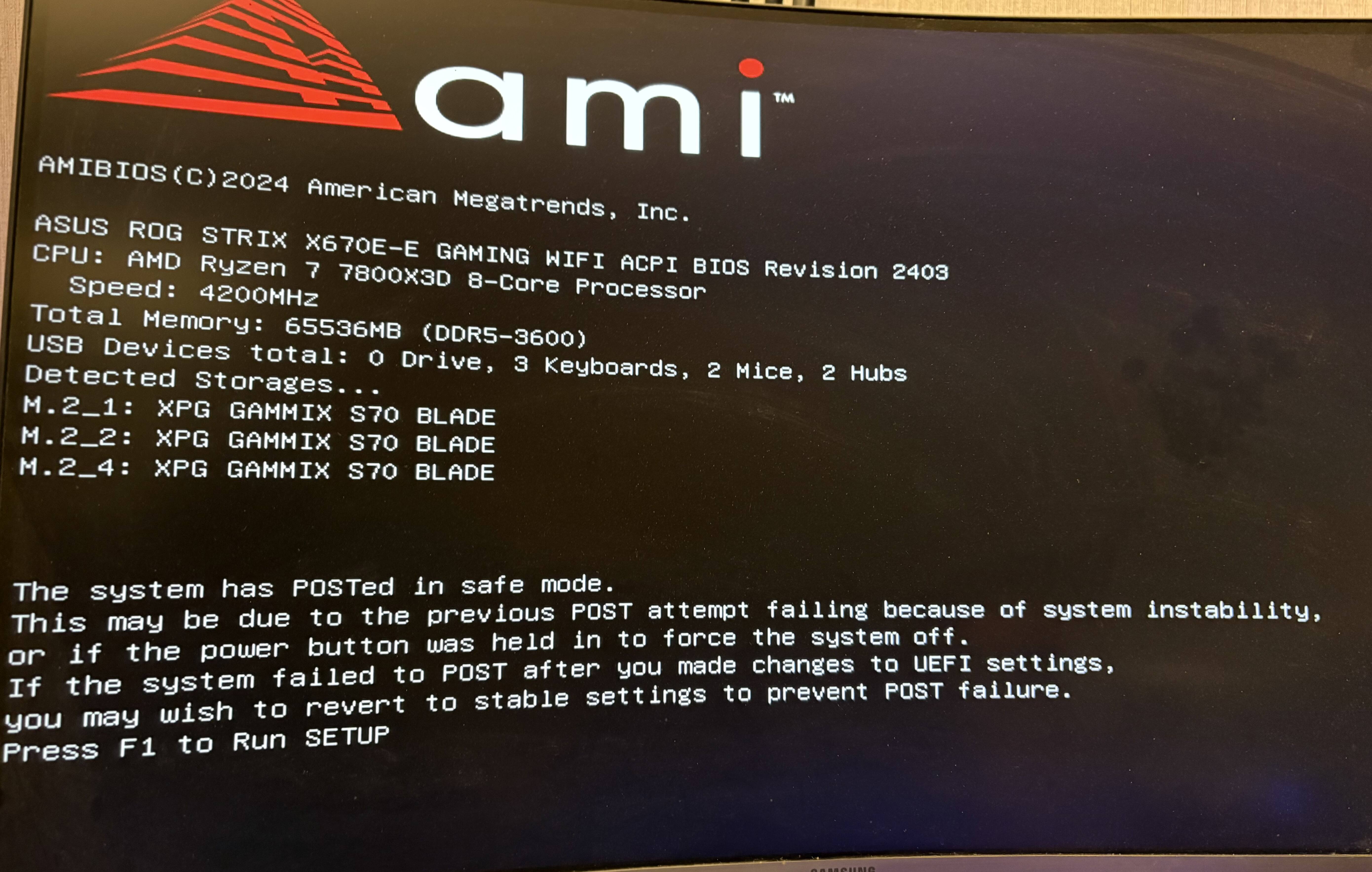

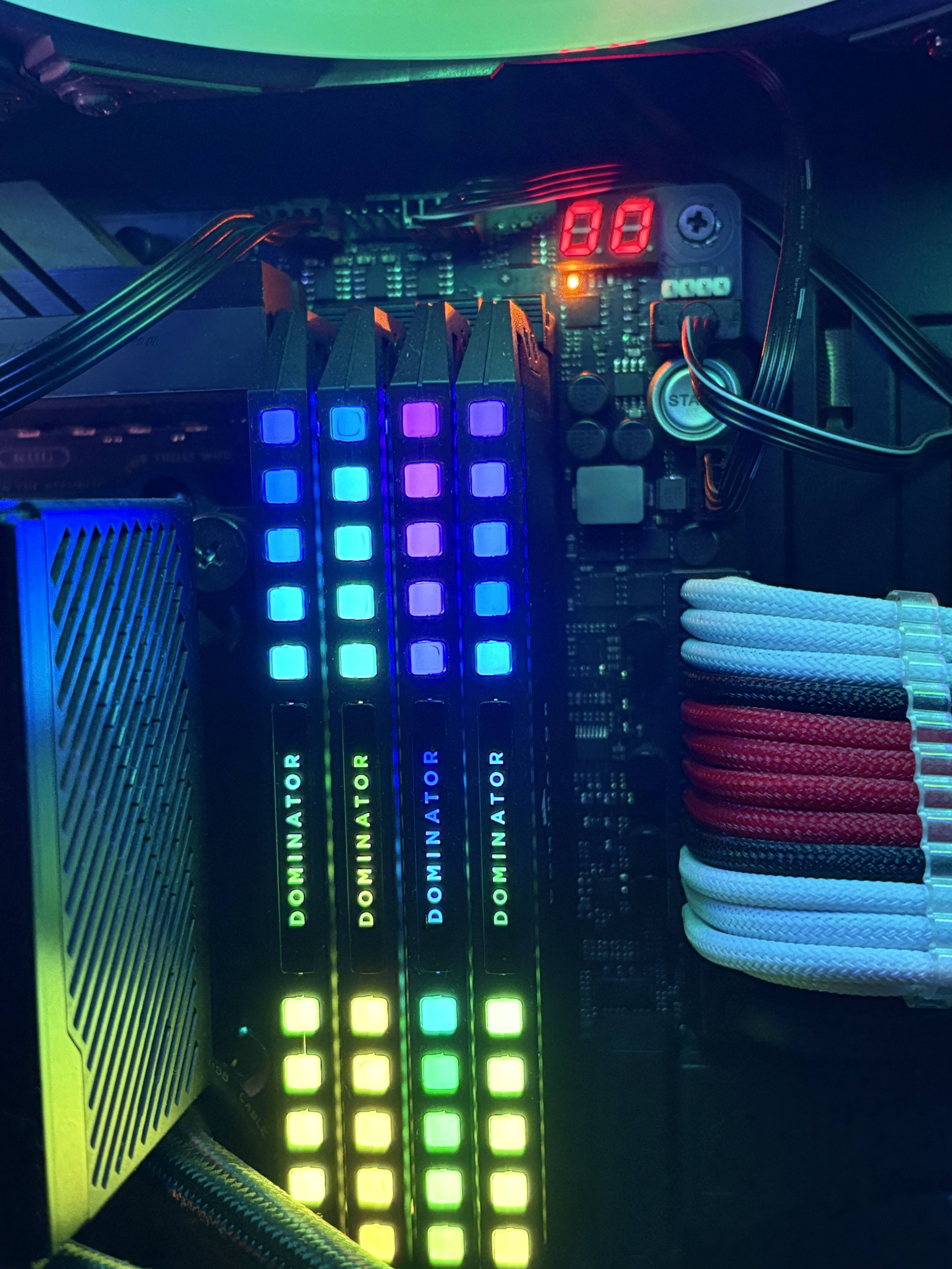

Pc was running fine till yesterday, turned it on today and got the “System has booted in SAFE mode” prompt, tried restarting the system and it went into auto repair and was stuck in that screen for 15 mins so I turned off the system, download a new bios on a flashdrive and tried a bios flashback. Watched a video on how to do it for my motherboard model and it said that the green led on the flashback switch would stay on for 5-6 mins then turn off which would indicate that the flashback is complete. The led in my case stayed on for around 12 mins so I turned off the psu then booted the system again and tried updating the bios from Asus EZ flash. It was updating fine then the system restarted and nothing came on the display and the motherboard Q-code was displaying 00 so I turned off the power again and tried turning on and the system hasn't posted since. How cooked am I?

Yeah the light was glowing solid. I converted the USB to FAT32 using a software and also converted it to MBR from GPT but it still glows solid green, not blinking. Anything else I can try?

Tried the flashback with a 32 gb drive and this time the led was blinking, after it stopped blinking turned off the psu power then booted up the system again, still nothing no post.
