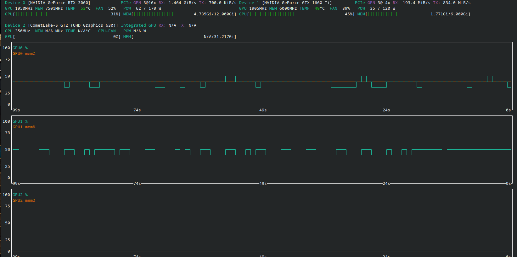

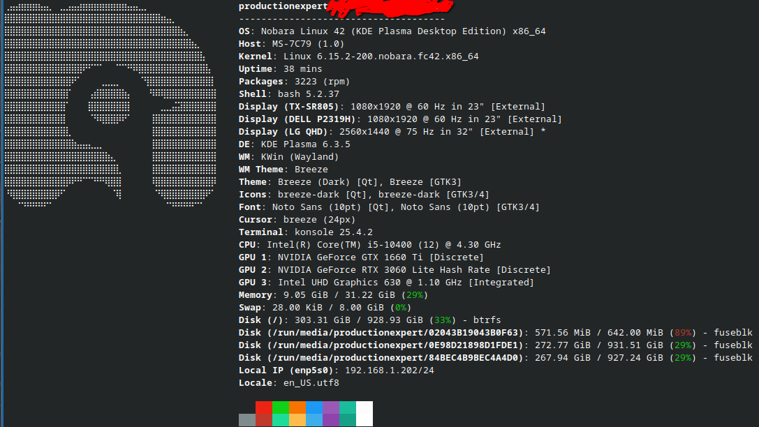

I recently swapped to linux on my desktop (after dallying it on my f13 for a year), but when I tried playing Marvel Rivals today I was expecting similar preformace to windows but how was I wrong, I was getting a really good 60fps in windows, but on linux I was getting closer to 15fps MAX and it was not a good 15fps, even changing to the lowest settings didn't change the preformace. In Nvtop it shows about 40% of the GPU being used..... I am not sure why this is happening, but I assume someone on this forum does, please ask for any further information. image.png.a55334b5bd5f672e621a231676fb7736.pngimage.png.505af14fd33c6da3b57a01aaeededa45.pngimage.thumb.png.5c3f0bad6a770d5a0e3562432e69fc5a.png

Install nvtop and monitor your GPU utilization.
I am not quite sure why I was expecting that with an Nvida GPU..... I have been watching the utilization in NVTOP in a few games since posting, they all seemto be around 40% utilization and most of them not going past the 20fps mark.
40% on which GPU?

3 minutes ago, xAcid9 said:
40% on which GPU?
For troubleshooting sake, I suggest only connect one monitor and use x11 instead of Wayland.
IMO, your setup is not simply "Plug & Play" for Linux, especially with Nvidia GPUs.
40% on the 3060 with ~50% on the 1660ti
If I remember correctly newer versions of fedora (what nobara is based on) don't let you switch between X11 and Wayland, or if they do I have not found a way yet (this is my second attempt at switch on desktop). I will try going to just 1 monitor with the 3060 though.
