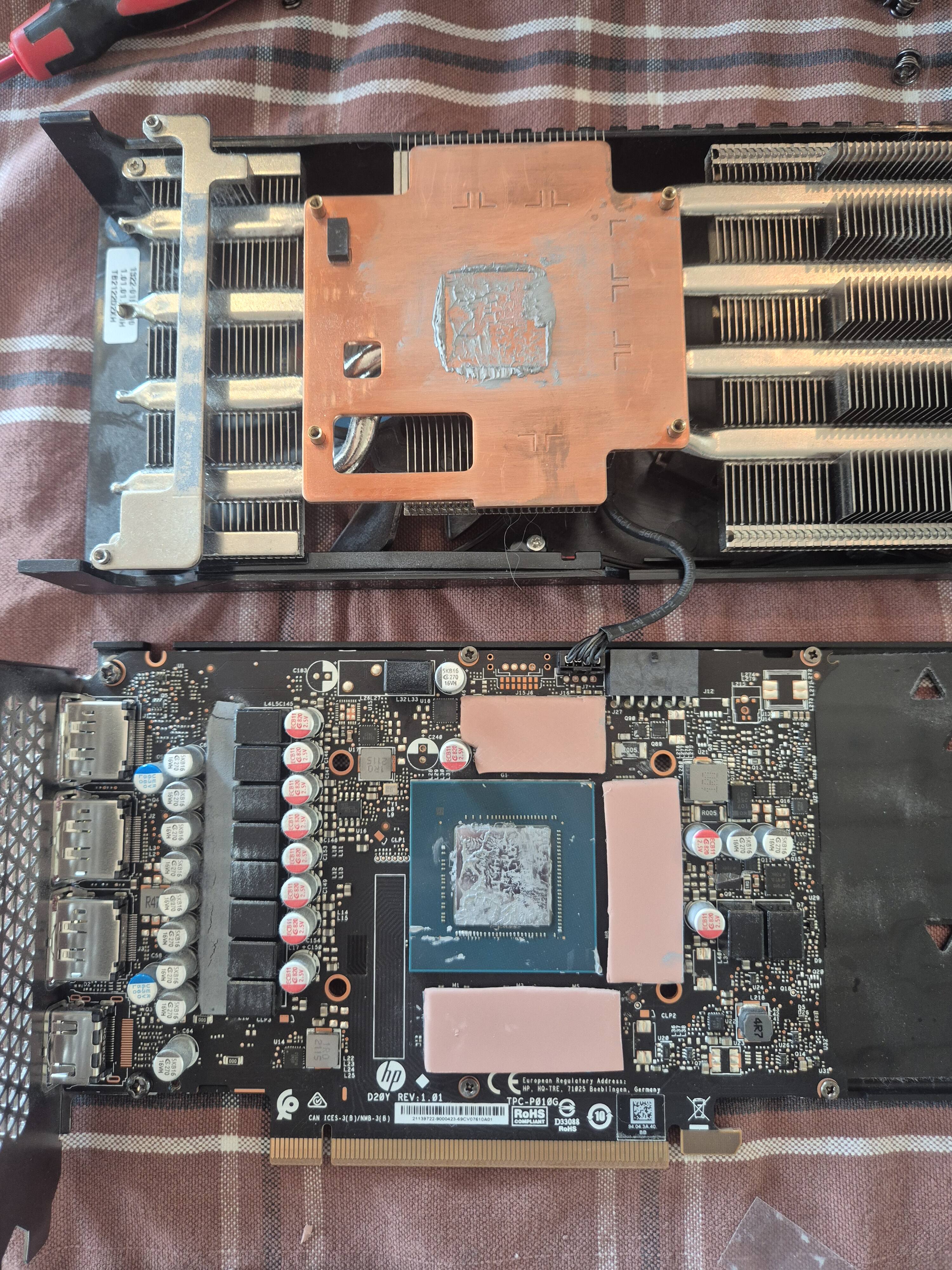

Hello again!
I opened my gpu to re-paste it. Once it was opened i noticed these old thermal pads. They seem old and some are ripped.
Can these be changed to thermal paste? Or are thermal pads required?
(It's a HP rtx 3070 that was included with the HP Omen 25L)
59 minutes ago, StormClaw said:
Hello again!
Either will do 😊

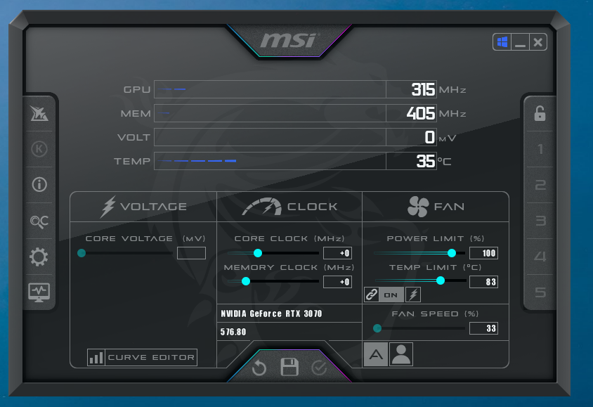

Do you have Afterburner or Fan control? That way you can set the fans speed slightly higher - but not whirring high - just to keep the GPU a bit cooler.
I have Afterburner installed, i'll try experimenting with some fan speeds 😄

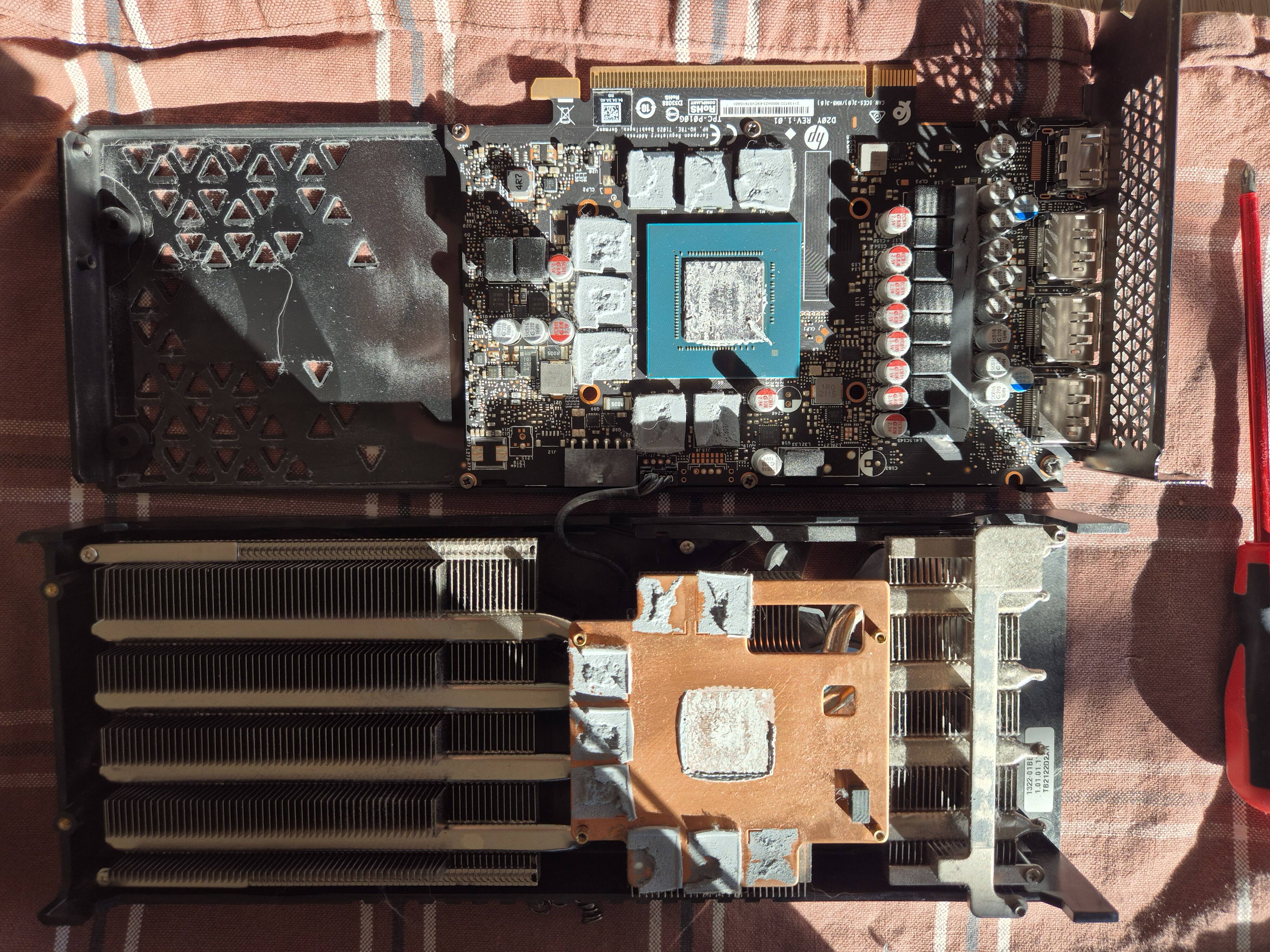

Hello, It's me again.
The thermal pads finally arrived today. I placed the thermal pads over the VRAM chips and screwed the GPU back together. Once i got my pc running again i noticed my idle temps were a little higher than they were before i installed the thermal pads, But i didn't think much of it. I went to boot up STEEP to test the thermals, and in the loading screen i heard the same Loud whirr from before i did anything with the GPU. I tried to look past it, thinking that it might have just been one time, But after loading in the game the loud whirring didn't stop, i lost signal to my monitor before i shut off my computer
What do i do?
What do i do?
Did you put enough thermal paste on the GPU die?
Just now, YoungBlade said:
Are those thermal pads the same thickness as the previous ones? If they are thicker, they might be preventing the cooler from making proper contact.
Did some research and measured the old ones that was on it. They both said 2 mm so that's what i ordered
I added a tiny blob more atop what was shown in the image, but it might not have been enough in that case. I could take it out and apply a bit more
Try that! Tell me what happens.
