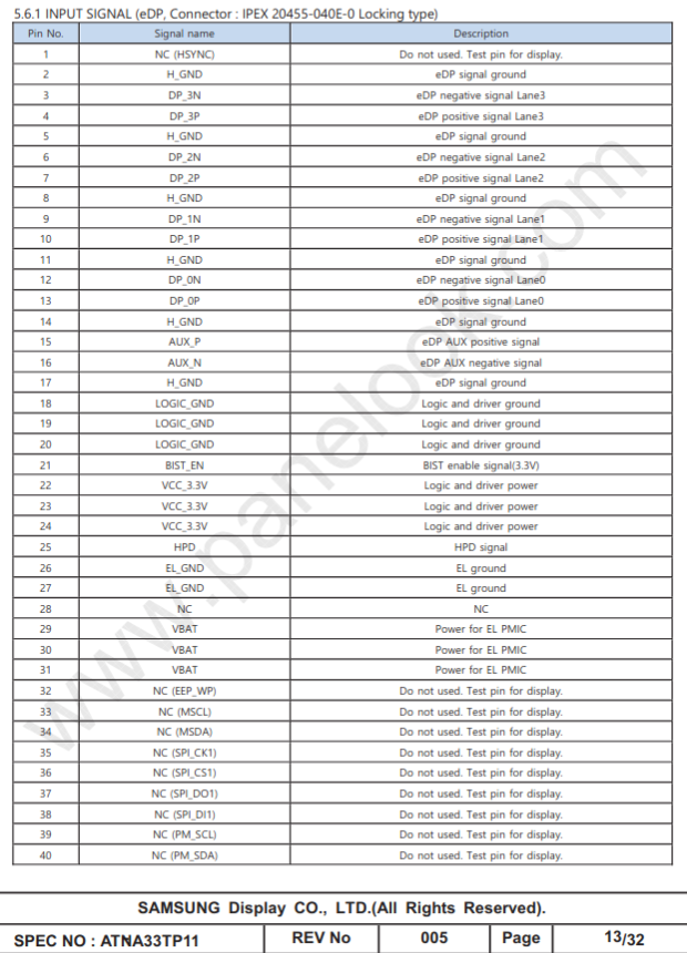

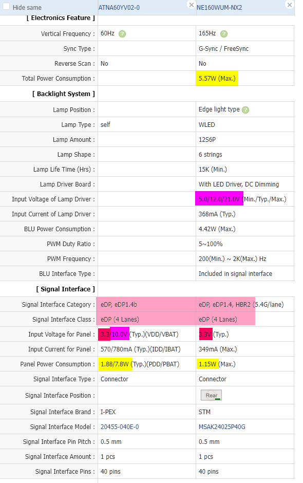

I've researched the feasability of this quite a bit and generally it seems like it might work, the main issue being that they are wired differently. Unfortunately getting Datasheets / Pinouts to confirm this seems impossible as they are locked behind Panelook but based off publicly accessible Datasheets I've found for similar Panels it seems like I'd just need to rewire the voltage supply pins.

If I just plugged it in as is that would definitely be the case and would probably blow up, but even if I rewire the pins to where they belong? eDP is essentially just Displayport, in my mind its primarily about getting the correct voltages to the pins on the display where it expects them which differs between both displays - The voltages are compatible tho.

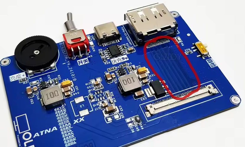

Are you certain about there not being EDID? The document I found for the other Samsung OLED (Screenshot of the Pinout originates from that) mentions EDID, furthermore there are breakout boards for bare panels like this - Checking those, the DP lanes are literally just wired 1:1 to the input jack, at that point I figure there would *have to be* EDID (I believe that communicated via the AUX Channel / Pins which are available here and also seeminlgy just passed through on the breakout, 4x2 Data and 1x2 for AUX). I have definitely seen people swapping eDP displays with different resolutions before, just not between different display types with different pinous.
