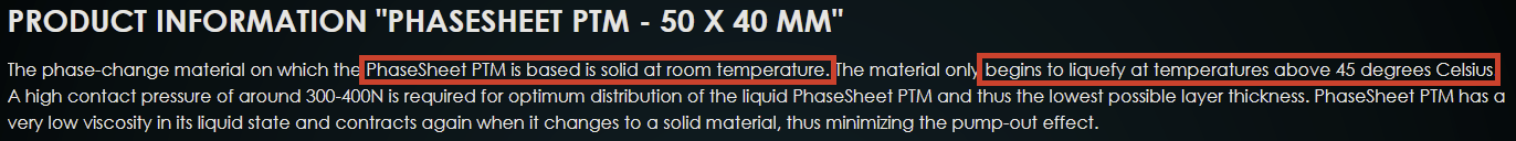

Hello, I needed to swap my heatsink that I had installed using Thermal Grizzly PTM and found this. It was flaky in parts and broke off into pieces in others. Is that normal? I thought these could be reused.
PTM is NOT reusable in the same way that something like kryosheet is. PTM is more like a standard thermal paste in a sheet. It is only in a sheet to make application easier.
