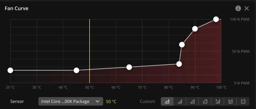

Alright, so would you say something like this curve would be safe to use?
Safety isn't part of the equation, and I can't tell you if that's acceptable because I don't know how it works with your parts in your case with your fans and with your ambient temperature. If it works for you, then its good to go.

Yeah, just tried it, PC got *very* hot *very* quick in game, definitely not having the fans that low
