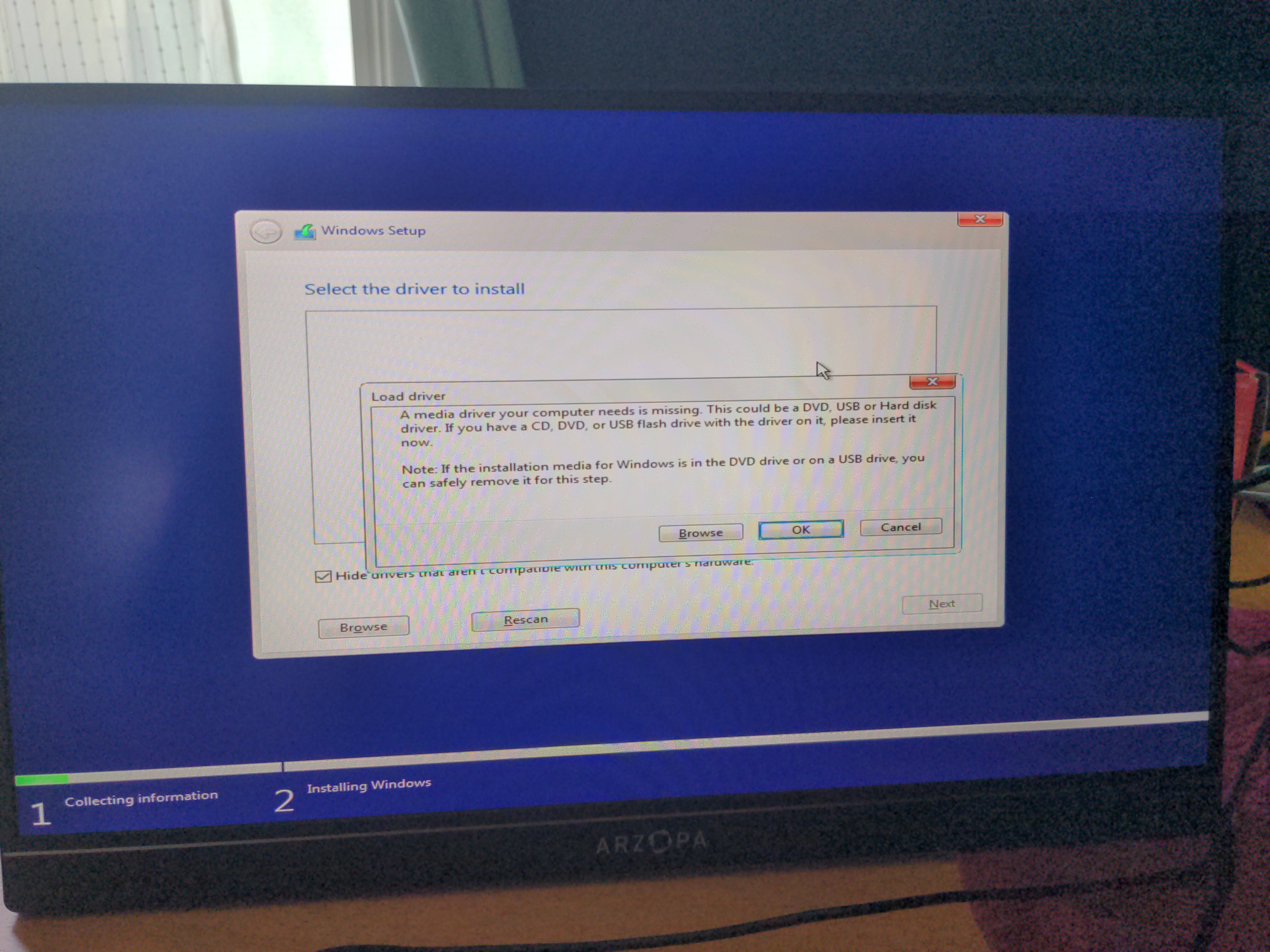

I started a fresh install of Windows 10-64bit, and on the first step I get the error "A media driver your computer needs is missing".

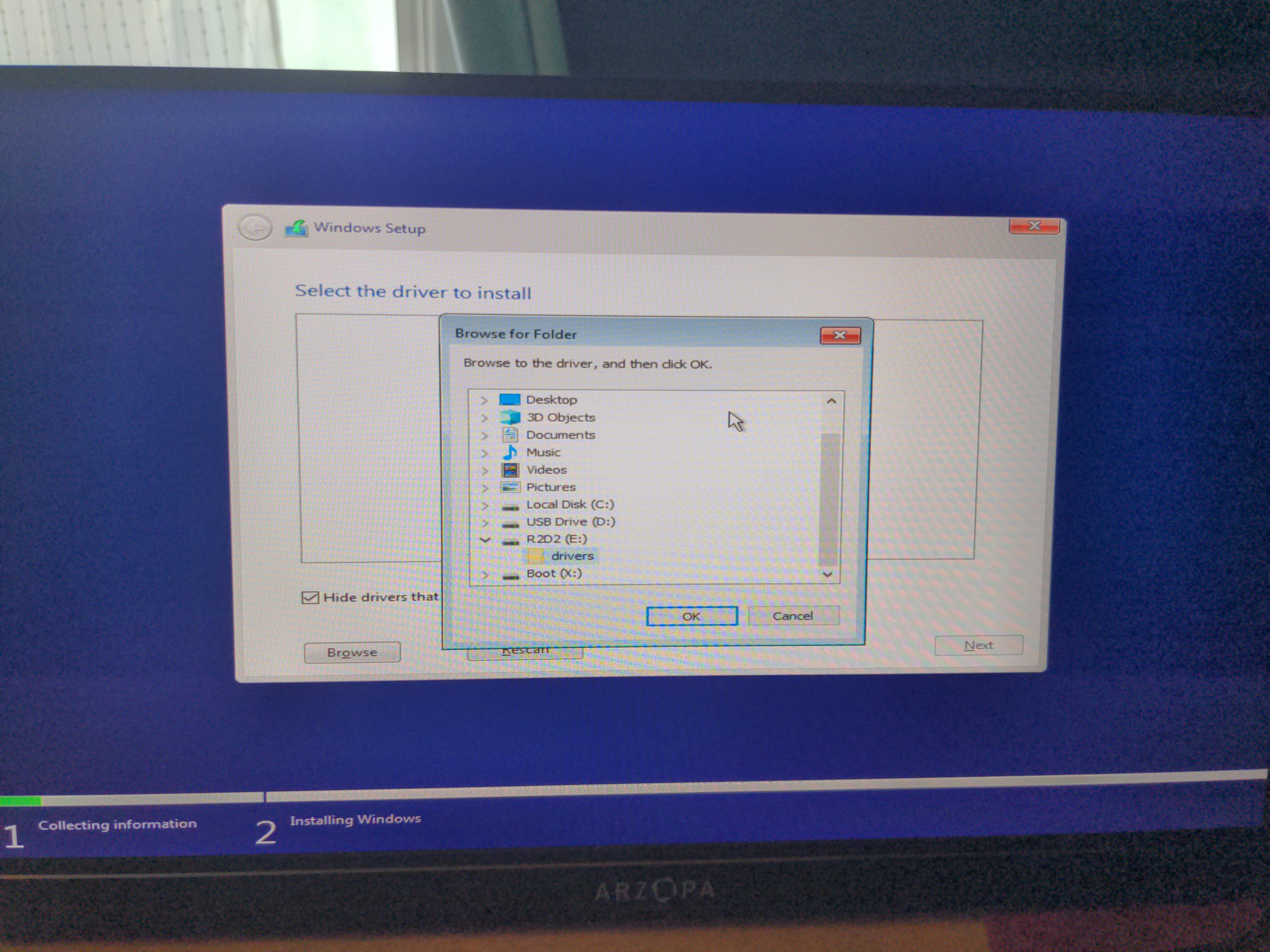

I then downloaded all the drivers for my motherboard (relevant ones seem to be the RAID, and chipset drivers https://www.gigabyte.com/Motherboard/B850-GAMING-WIFI6/support) and extracted them to a FAT-32 formatted flash drive. I plugged the flash drive into a USB 2 port on the motherboard IO panel, and tried to browse for the drivers, but nothing shows up in the folder I have them in.
I noticed the drivers are all in the .exe format, and some research suggests that windows is looking for .inf files? but I'm not entirely sure on that. I also tried leaving them as "zip" archives on the flash to see if Windows installer would recognize them, but still no.

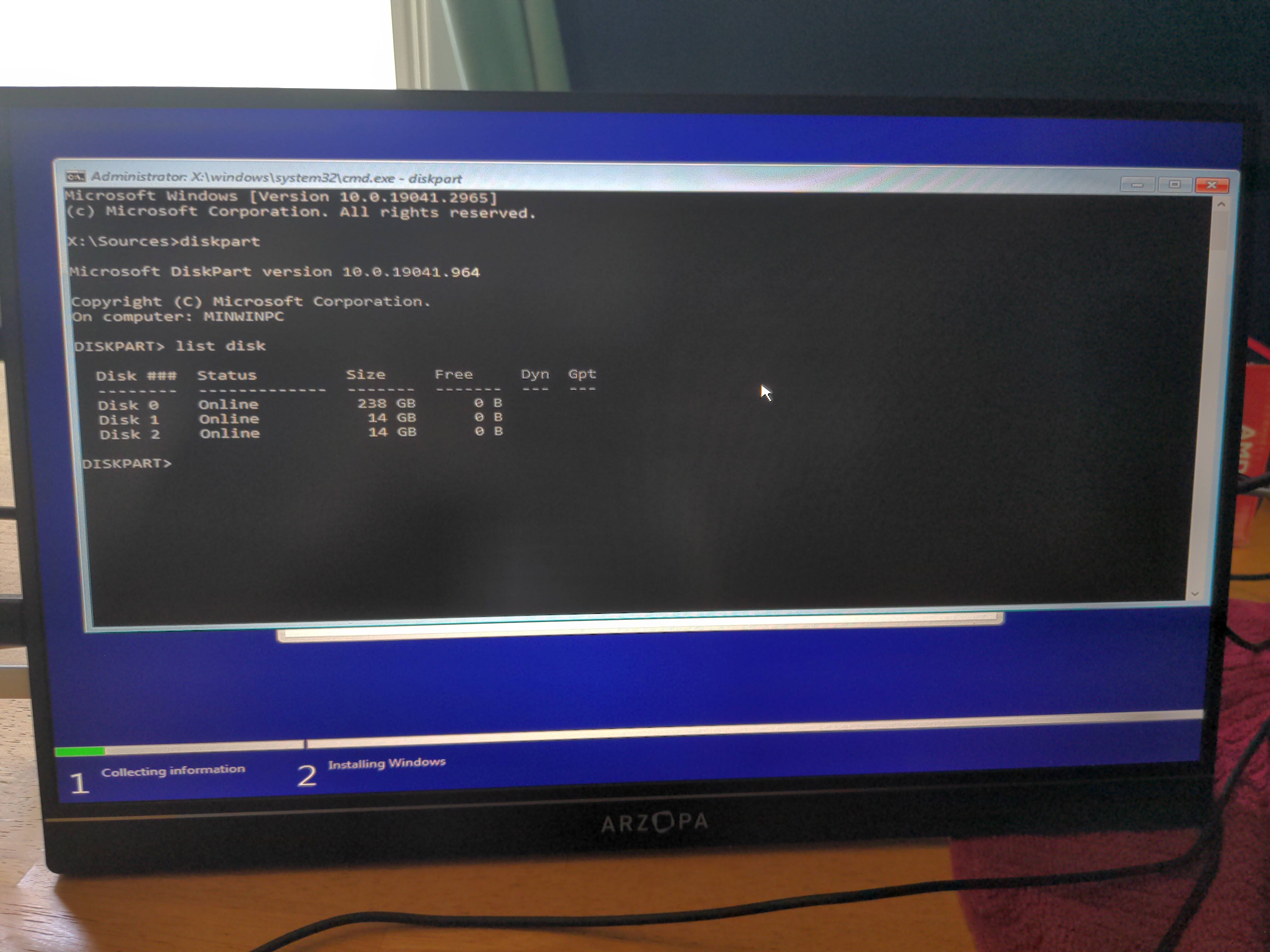

I also opened the command line to see that my drive is recognized, and it is, so I did a full format and created an NTFS partition to hopefully make sure windows could see it, but still no change.

Just tried Windows 11, there are some Gigabyte drivers for windows 11 called "Preinstall drivers" for RAID, which actually include non .exe files. I can get them to show up in the Windows 11 installer when I uncheck "Hide drivers that aren't compatible with this computer's hardware". However when I click "Install" on any of them, I get that same message, "A media driver your computer needs is missing. This could be a DVD, USB, or Hard disk driver. If you have a CD, DVD, or USB flash driver with the driver on it, please insert it now."
See if you can extract the files from the exe file (7-zip can do this for most .exe files) more specifically from the chipset driver installer considering the history with gigabyte and windows installations not working because of missing drivers.
Is your SATA Mode set to AHCI or RAID?  AHCI mode does not require additional drivers during Windows install.  Make sure that all other drives (other than boot drive) are disconnected.  How is your NVME Raid Mode configured?  Don't be afraid to read your motherboard manual.  From your manual:  SATA Configuration & SATA Mode Enables or disables RAID for the SATA controllers integrated in the Chipset or configures the SATA controllers to AHCI mode. RAID Enables RAID for the SATA controller. AHCI Configures the SATA controllers to AHCI mode. Advanced Host Controller Interface (AHCI) is an interface specification that allows the storage driver to enable advanced Serial ATA features such as Native Command Queuing and hot plug. & NVMe RAID mode Allows you to determine whether to use your M.2 NVMe PCIe SSDs to configure RAID.  https://download.gigabyte.com/FileList/Manual/mb_manual_amd800-bios_e.pdf?v=90b5a45be2a2aa3aea69c5db7a34df66
