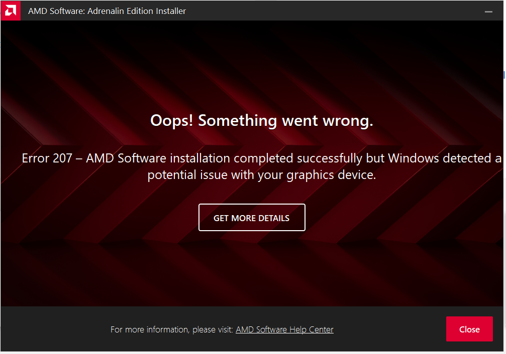

Trying to load May's driver... 25.5.1...
WTF does this mean, it just goes to AMD driver website...  Gotta tell a brother the potential issue!!!!

So when the AMD driver crapped out, it basically uninstalled itself for all intents and purposes.
I just enabled the GPU in Device Manager.  Now it's showing up, and working.
So there is an issue with the AMD Adrenaline or driver itself?
Edit:  But I don't want to use the Windows driver, do I?  I want the AMD driver for best performance?
