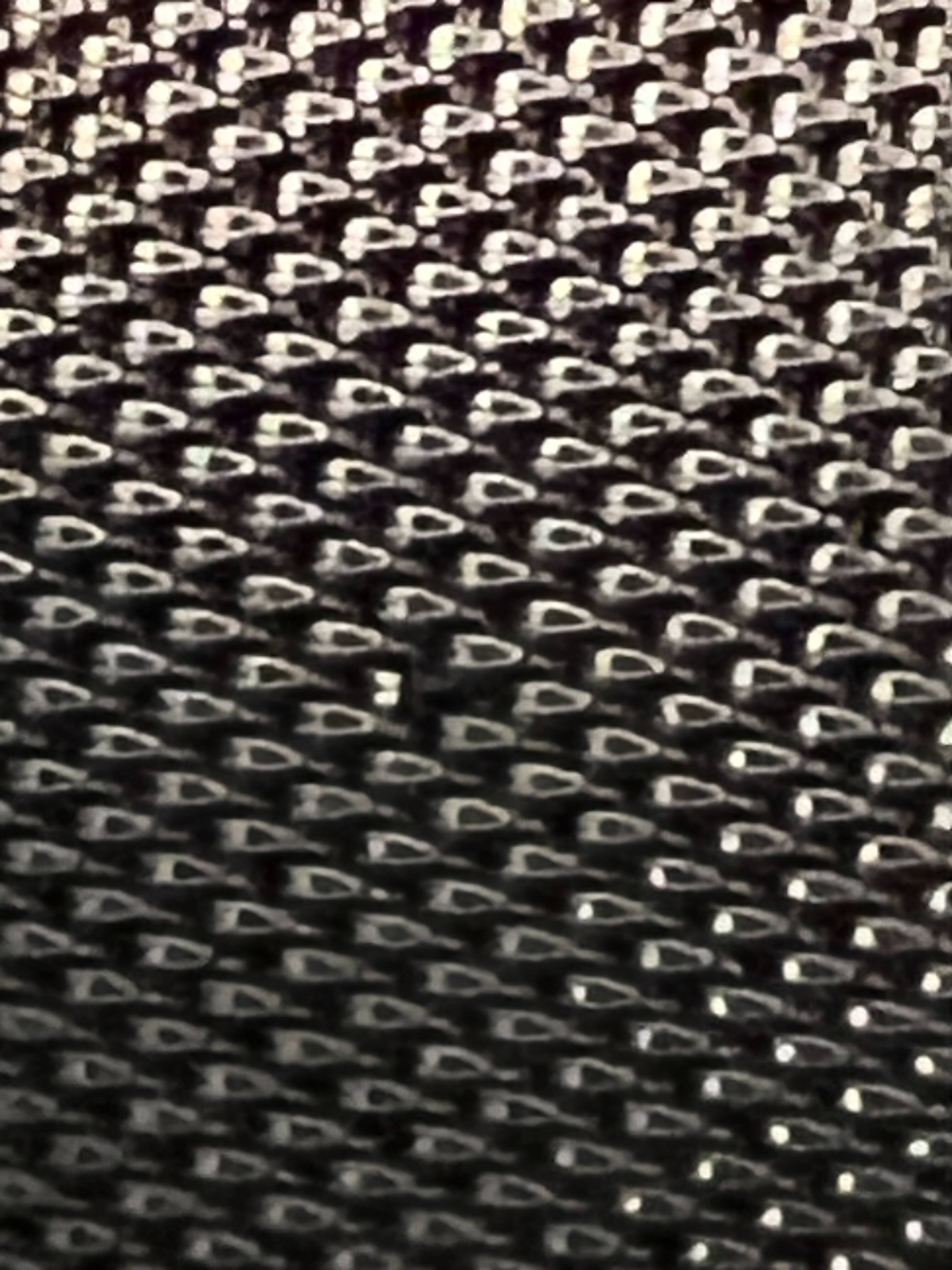

Alright not sure how it happened but it looks like I have a bent mono pin 馃珷馃

Oh bud, that SUCKS. It's not dead, you CAN save it, but it's touch and go. You need steady hands and probably watch some videos on this.聽
Kinda impressed it worked for this long
