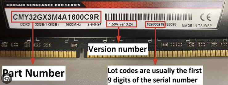

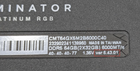

IIRC, the problem that usually occurs with memory sticks that isn't bought in form of a kit is that RAM manufacturer often revise the models down the road, changing ICs and such on the PCB.
Example :
From Corsair's own blog
https://www.corsair.com/us/en/explorer/diy-builder/memory/dram-upgrade-guidelines/
You can buy the very same exact model later down the road but it may have different ICs.
It may play nice with the existing one, and it may not.
But usually the problem that occurs is simply borked XMP/EXPO/DOCP profile, but setting the RAM manually instead of using XMP/EXPO/DOCP usually solves it.

Mixed RAM isn't a guarantee that your system will have issues, it's just that it's more likely to have memory issues than a setup with a matched memory config. The issues come with the fact that different memory kits come with different memory ICs (even the same model number can have different ICs on board), and each of those different ICs have a different window of acceptable parameters that are figured out during memory training. Sometimes they overlap and you have two ICs that play nice together, other times you get two that don't and won't even boot in the same system.
With DDR4, especially low speed DDR4 like yours, compatibility is usually pretty good across sticks, it's rare to have a setup where mixed RAM won't boot. It's not impossible, I do own two sticks that will not boot in the same system no matter what I do even though they both work individually, it's just quite uncommon. Issues usually start showing up when you doing stuff that's a bit more exotic, like running 3600MT/s and higher or doing anything with mixed DDR5.
It's all a question of probability. A matched set should almost always work, but it might still have issues. A mismatched set is less likely to work, but it still can, especially when frequencies are lower/timings are higher.

You can. But even the same model may have differences (e.g. different ICs) depending on when the particular module was made. There's simply no guarantee it'll work at full speed, but it might.
