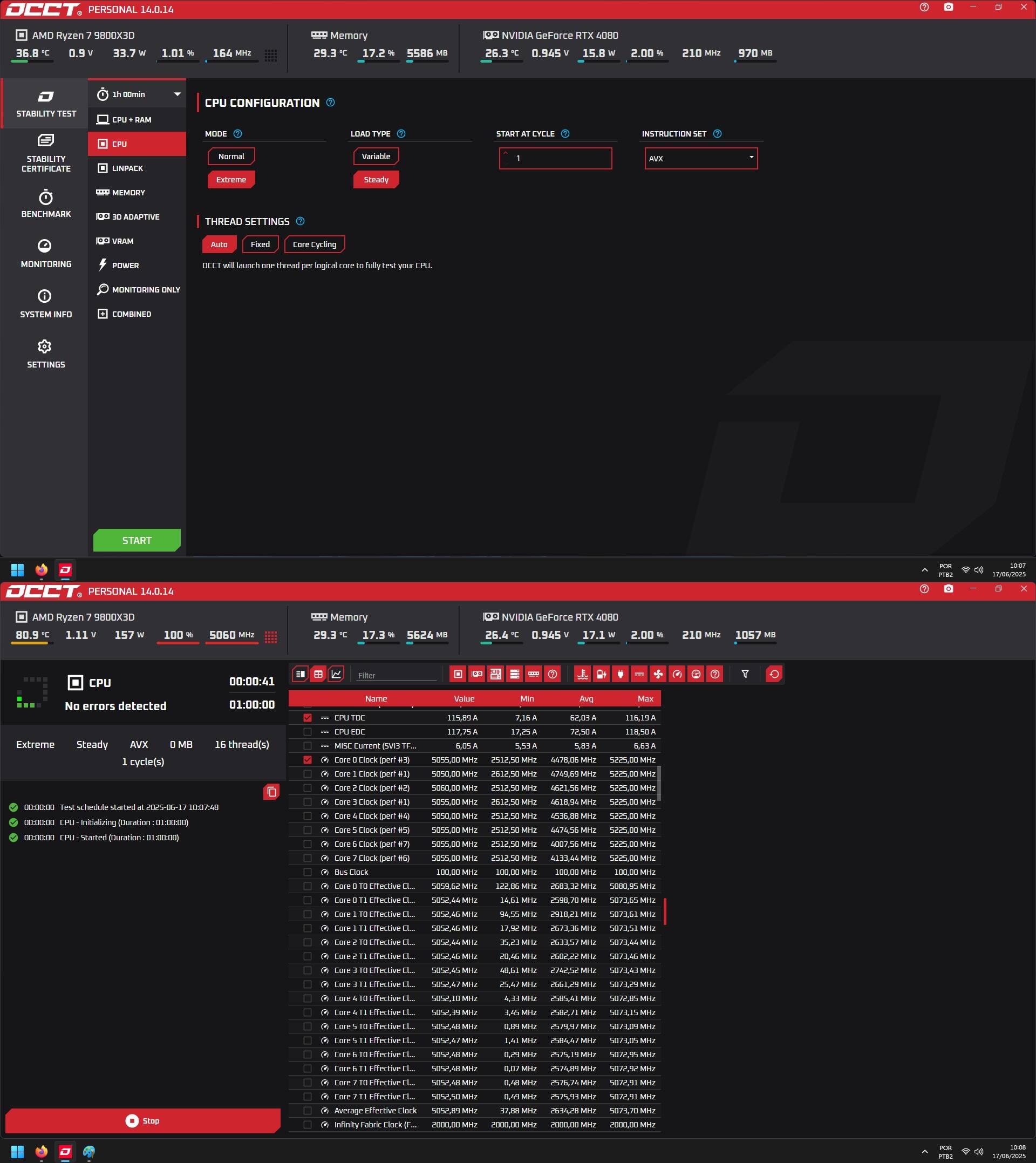

Just one final question: Given the OCCT settings, the clocks under AVX (not AVX-512) are okay? Do you get the same results? Thanks in advance.
Using the same settings are you, I get this.
Again, you have PBO On, while I currently have it Off, so you're seeing 5.0 ~ 5.1 GHz, while I'm sitting at around 4.9 GHz.
Power is about the same...you're like 5W more, basically within variance (e.g. different motherboard, etc).
Temperature is pretty close, I'm running an open loop, while you're using an AIO.

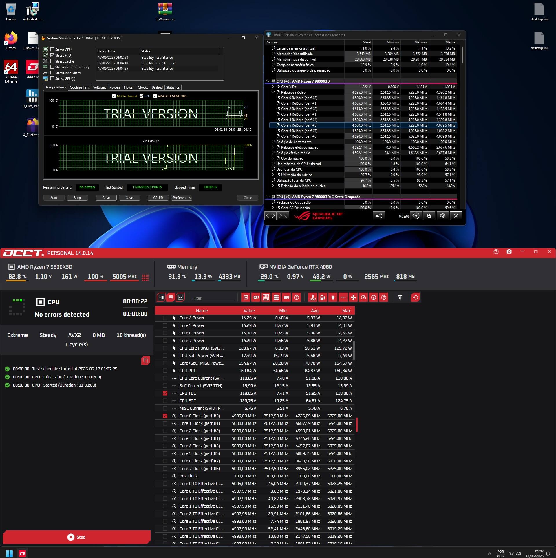

Hello everyone, I just swapped my old 7700X for a brand new 9800X3D. Updated bios, fresh installed Windows 11 with latest updates, updated drivers from Asus website, everything brand new. Back with 7700X I'd get around 5.1 to 5.3 on all cores under heavy load (Aida FPU and OCCT). But now, I'm only getting 4.6 on Aida FPU and 5.0 on OCCT. Is this normal? I have a PL360 from cooler master and gelid extreme as thermal compound. Is this normal or something's wrong? PBO is enabled and DOCP as well, (but same happens with 'em off). My PC settings are the one from my bio/signature.
Here are some screenshots:
CPU: AMD Ryzen 7 9800X3D; Mobo: Asus ROG Crosshair Hero X670E; RAM: Team Group T-Force 2x16GB (32GB) DDR5 @ 6000MHz CL38; GPU: RTX 4080 - ZOTAC GAMING AMP Extreme AIRO; Case: NZXT H7 Flow; Storage: Kingston KC3000 1TB + Adata Legend 900 2TB; Cooling: Cooler Master PL360; PSU: Corsair HX 1200

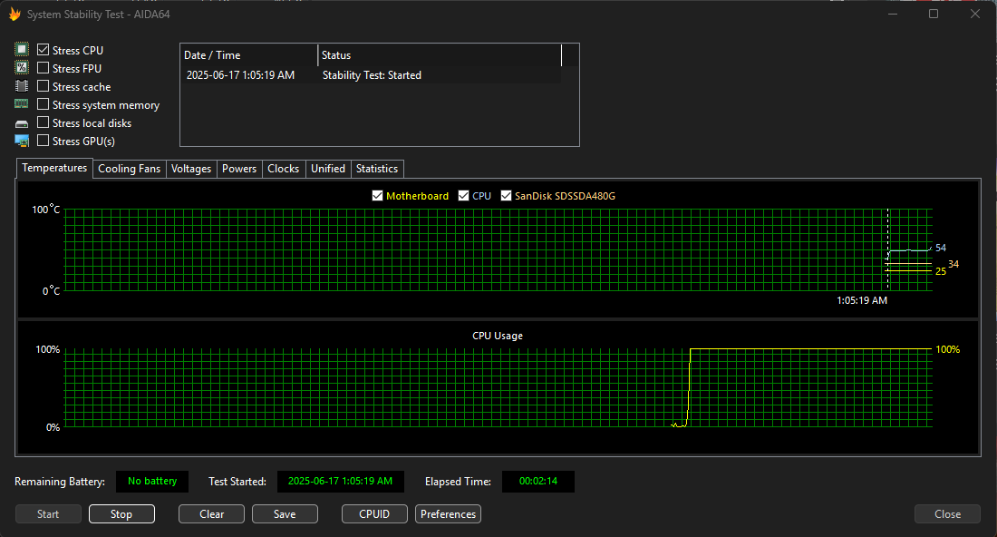

When stressing the FPU (e.g. Floating Point Unit) with something like AIDA64 Stability Test, it will run at a lower clock.
For one, running the FPUs at full blast on all-cores will make the CPU hit is "120W" rating limit.

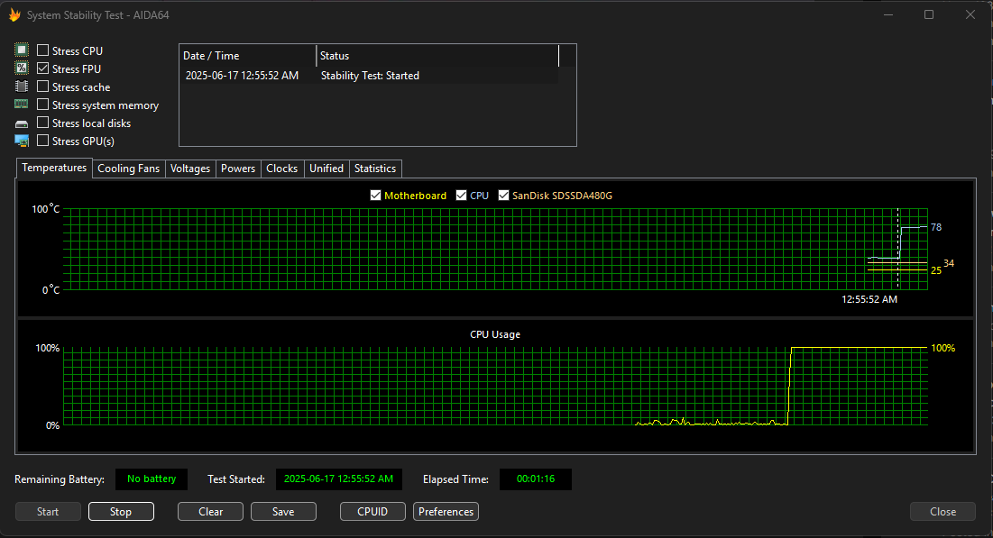

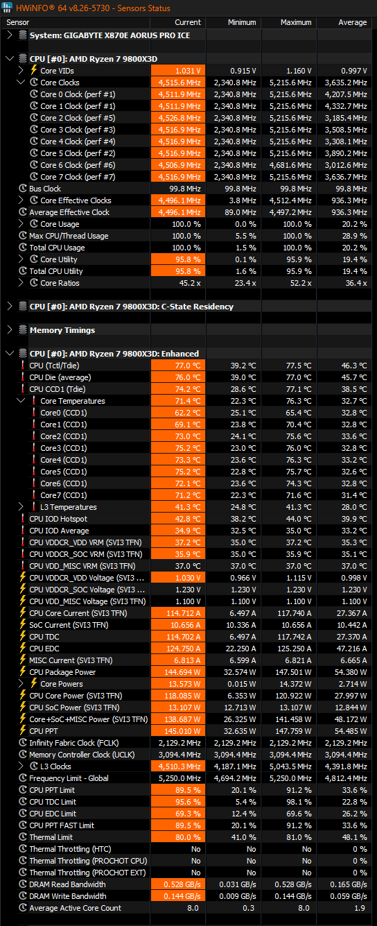

Here is my 9800X3D running AIDA64 Stability Test, stressing just the FPU.
Boosts up to the advertised 5.2 GHz, but shortly drops down to 4.5 GHz. You can also see CPU Package Power and CPU PPT sitting at 147W.

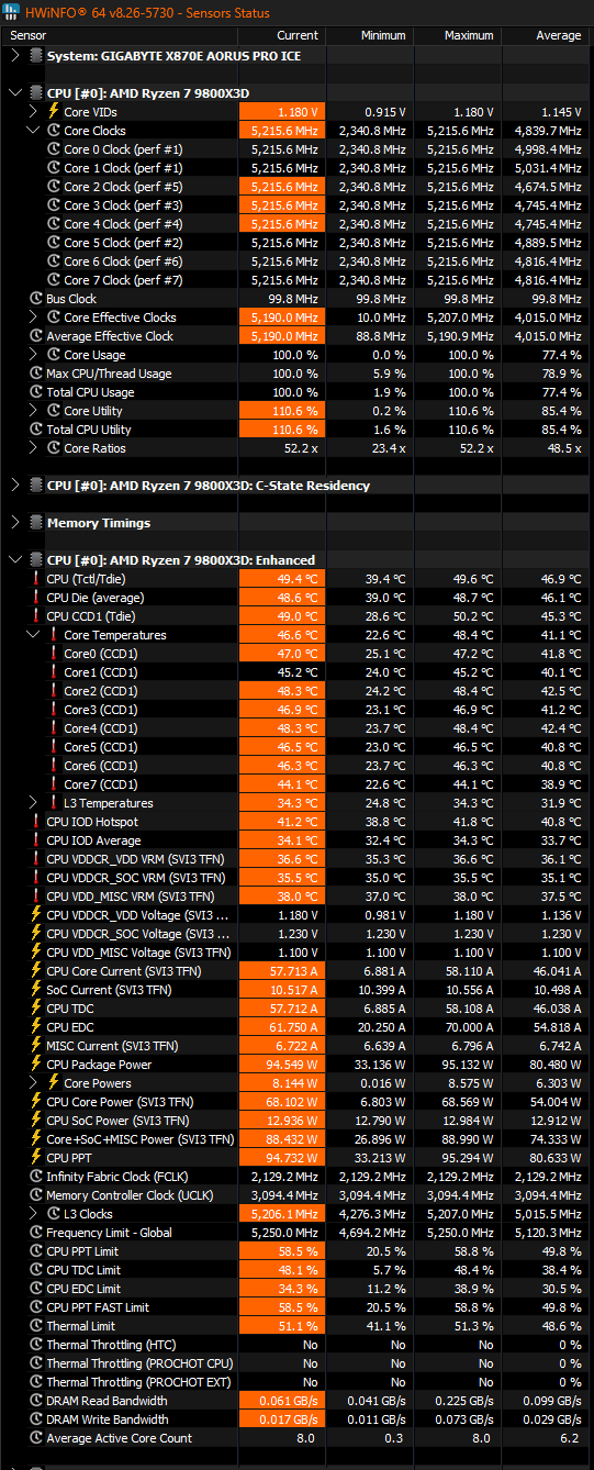

Running the AIDA64 Stability Test, stressing just the CPU.
Maintains 5.2GHz across all cores. CPU Package and CPU PPT only hits 95W.
Sir, thank you so much for your answer, it was very informative and saved me from opening it up (the pc) again just to reapply the thermal compound.
Later, I've found this link that even adds more info to it as well. Since, as far as I know, the PBO doesn't get passed from the 5.2 GHz adversited and it's not manual tweaking like curve optimizer or manual OC, I think it's all good then.

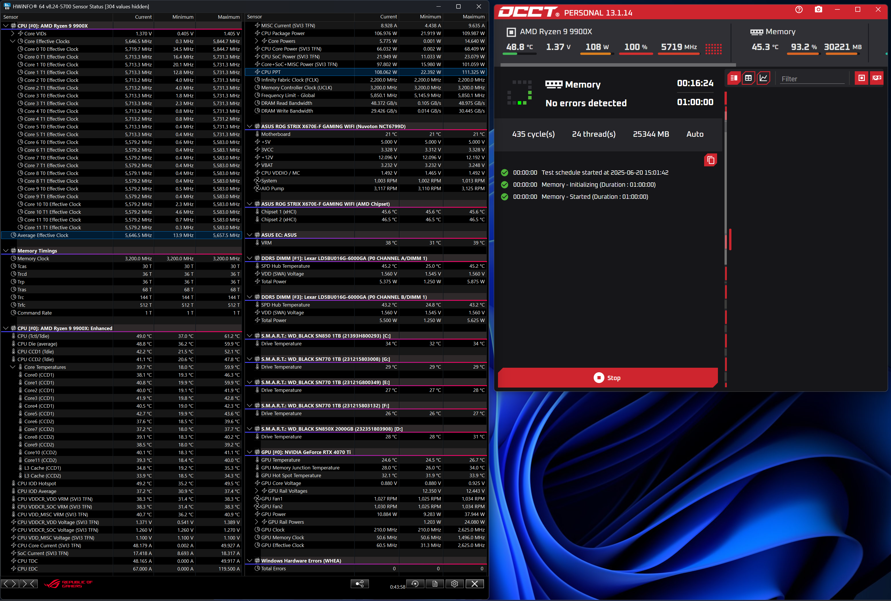

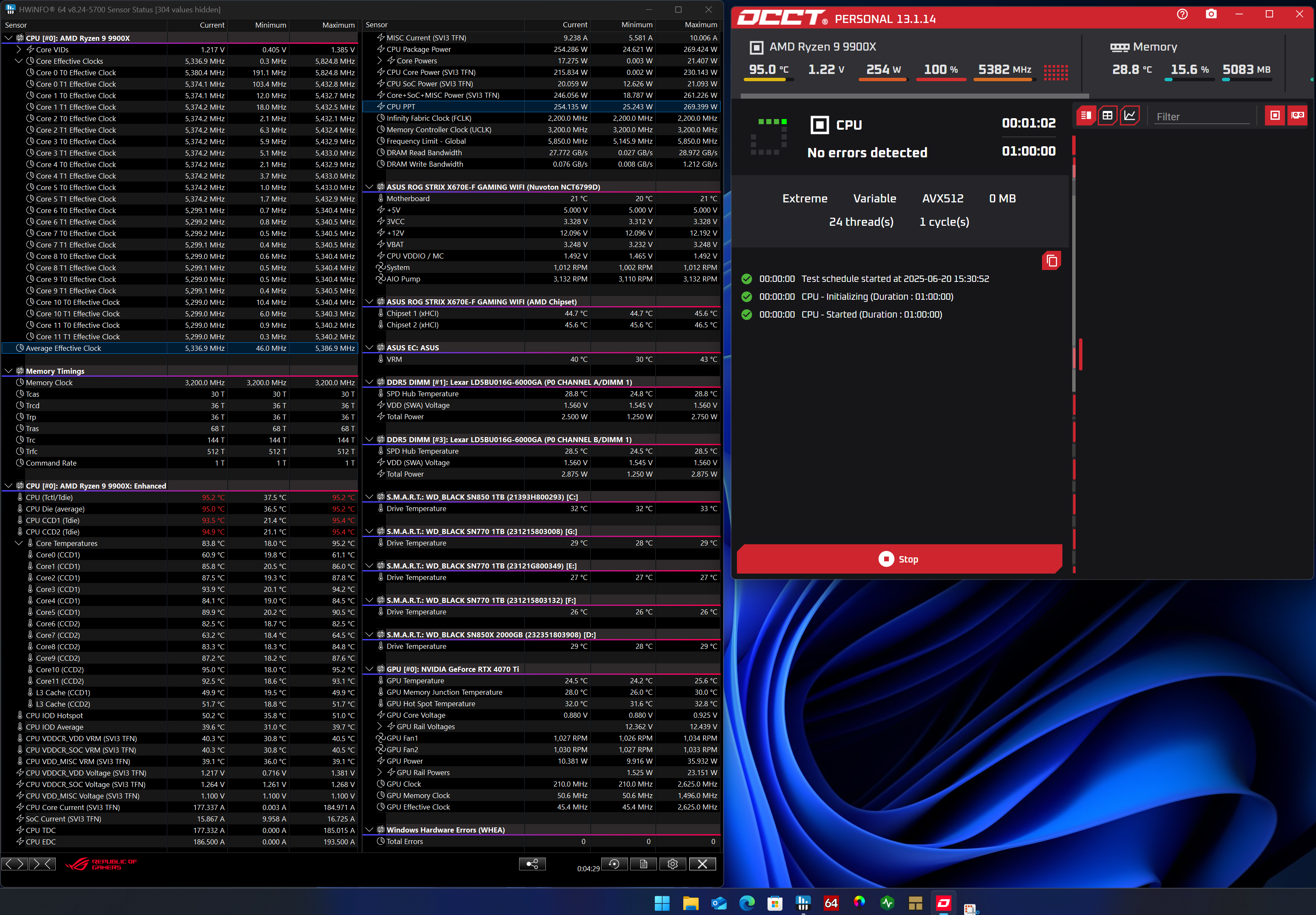

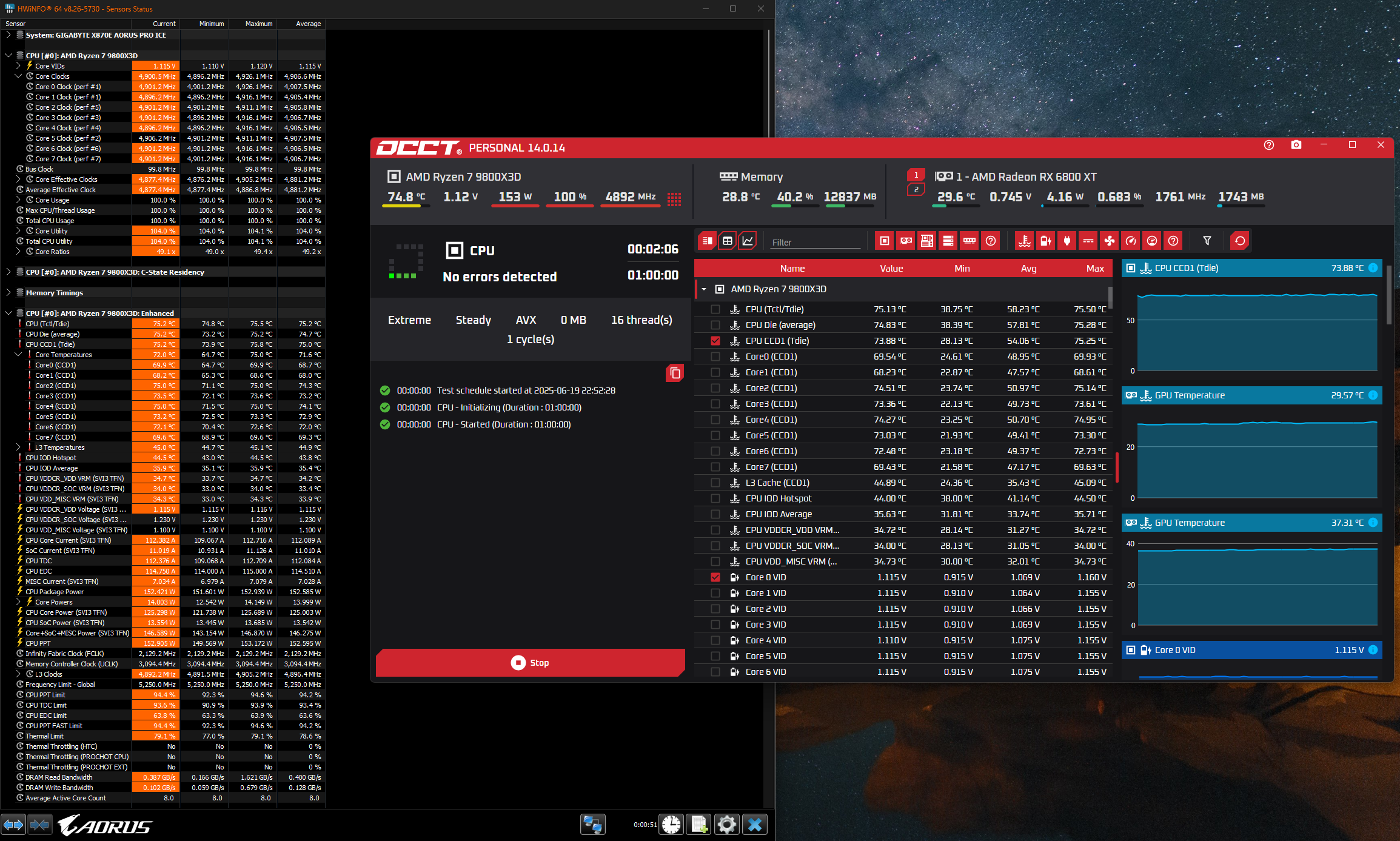

If you want to push high clocks in those type of workloads, you have to have PBO enabled, you have to extend your PPT/TDC/EDC limits, you have to have CO enabled, and you have to have boost override enabled. Running a single CCD part should make this easy work for your AIO or open loop.
