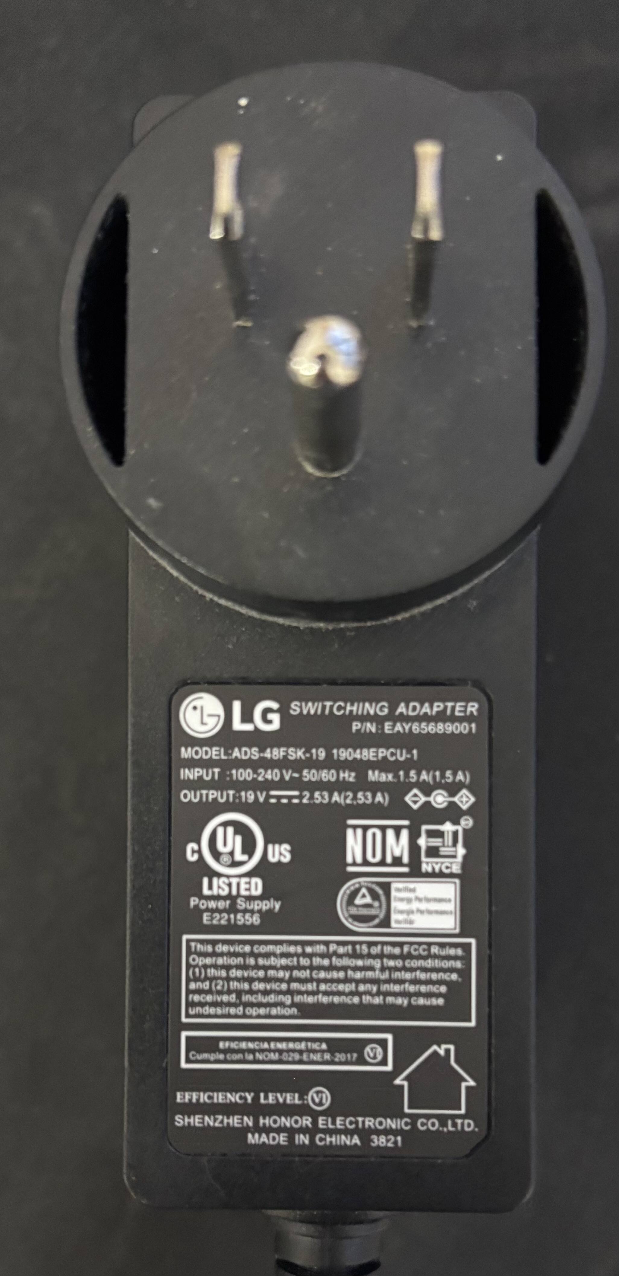

Okay what if an electrical appliance like my monitor has an external power brick? Like this:
Well in this case not much choice but use an adapter. Here since we sometimes get devices that originally have a EU plug they come with a non-removable adapter that firmly grips on the contacts so they don't risk wiggling and causing flaky contacts, not sure if that exists for UK->US.

4 minutes ago, goatedpenguin said:
(only like 230W)
230W sounds like a lot while monitor sounds like a little
LG writes 48W https://www.lg.com/be_fr/moniteurs/lg-27GN750-B

6 minutes ago, goatedpenguin said:
Thanks, I guess I have no choice but to use a US-UK adapter, I just hope nothing breaks or catches on fire. The monitor doesn't draw that much power (only like 230W) I think, so it may be fine. Now I just need to worry about buying a kettle plug and a power cord strip.
I've looked into it, and it would appear that your monitor is designed to accept both 100-120V and 220-240V. You can likely verify this by looking at the power brick. If true, any adapter will do.
As for your PC, what PSU do you have?
The picture they posed shows 100-240v accepted on the plug so they'll be fine there at least.
While I'd hope the PSU is in the same category as being modern and accepting 100-240v definitely good to check too 🙂
Nice spot 🙂

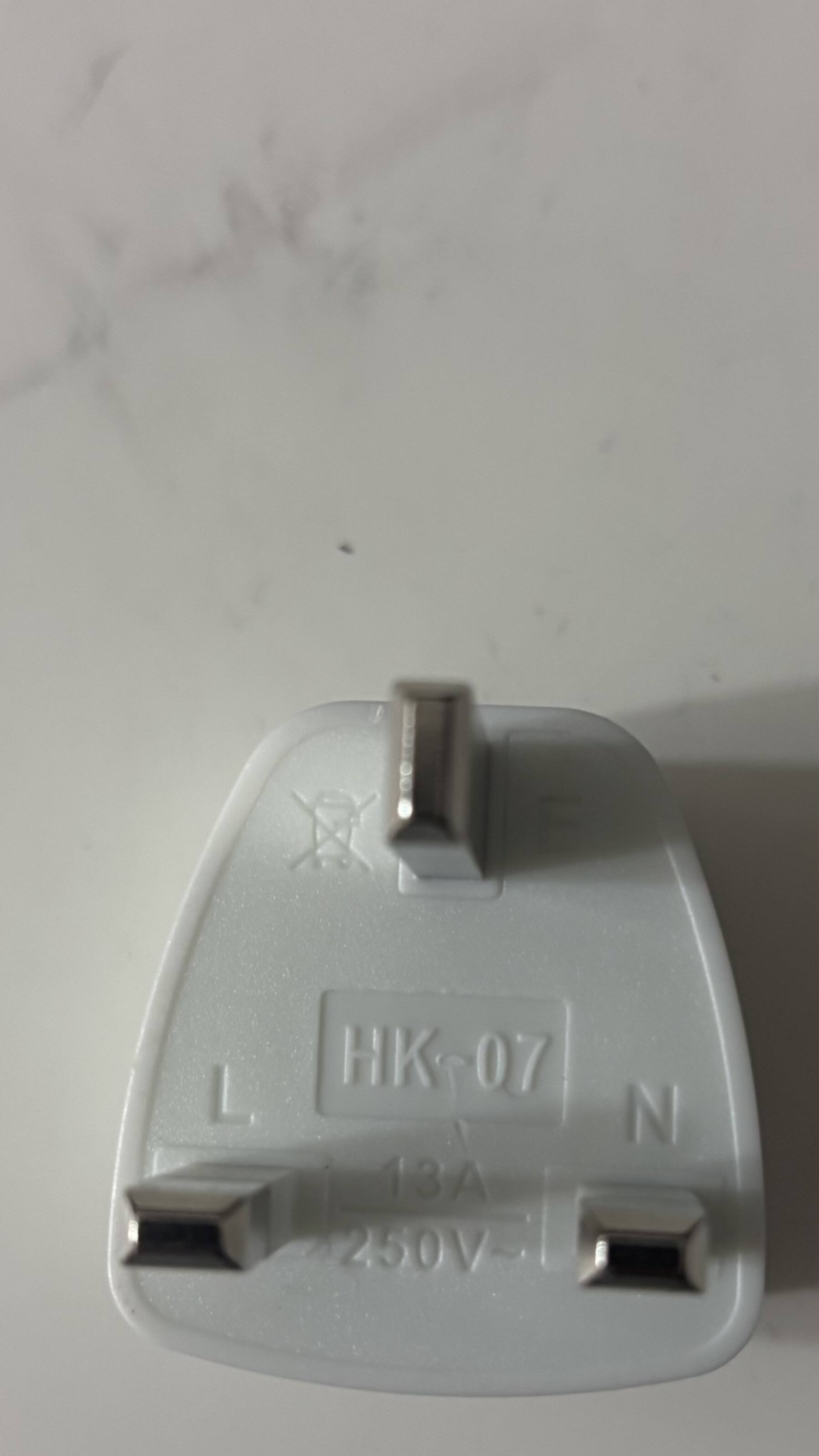

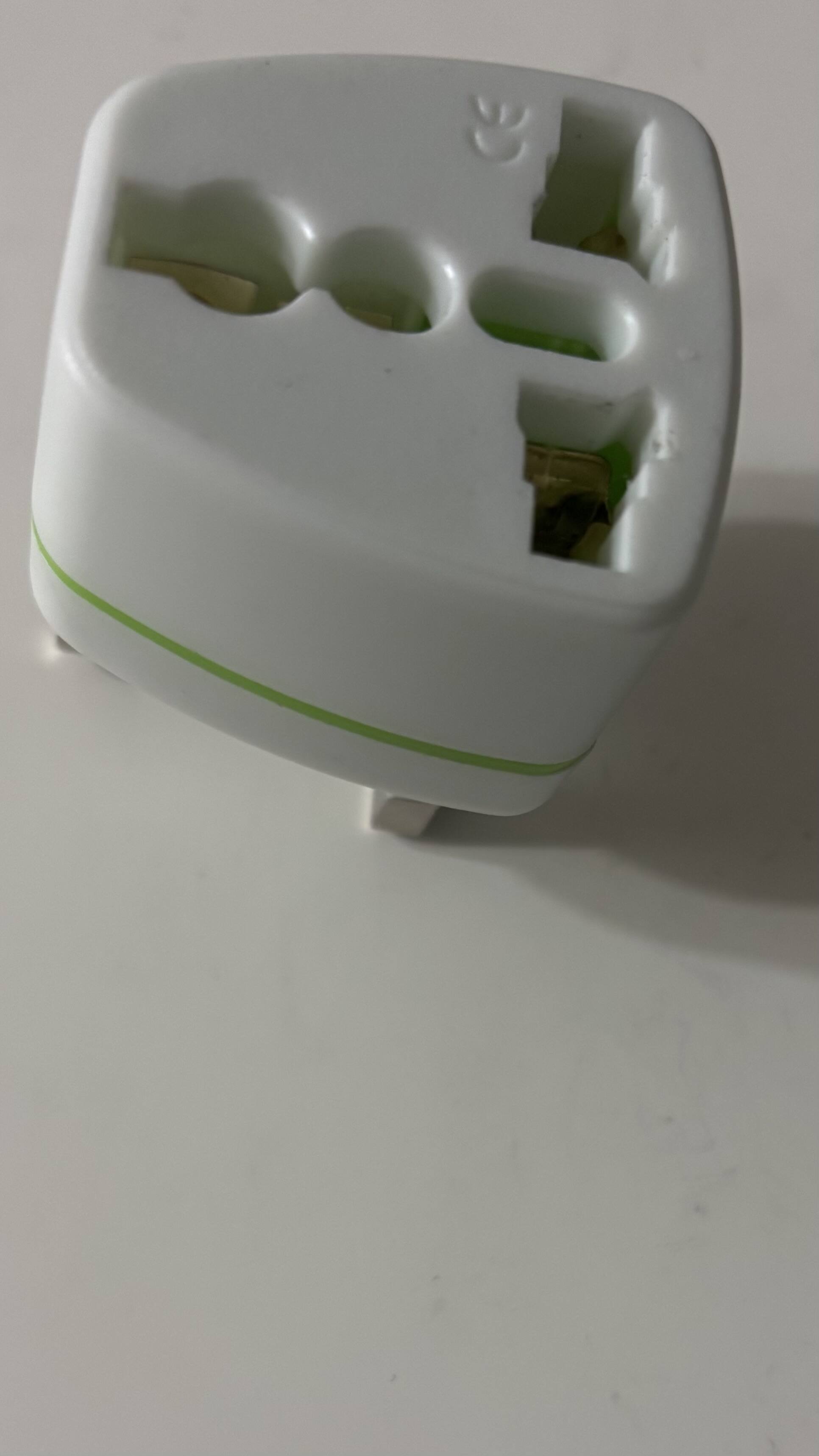

So this is fine? if so can I plug in my US power cord into this so that I don’t need an adapter for everything?
image.thumb.jpeg.333b39170fc29f61f24e5d6088897563.jpegimage.thumb.jpeg.90cc9038496d4645c56641bcd94ac24f.jpeg
2 minutes ago, goatedpenguin said:
So this is fine
For your monitor and PC, yes it should be.
If your going to use it with anything else though you should make sure that the appliance in question accepts both 110V and 230V.
