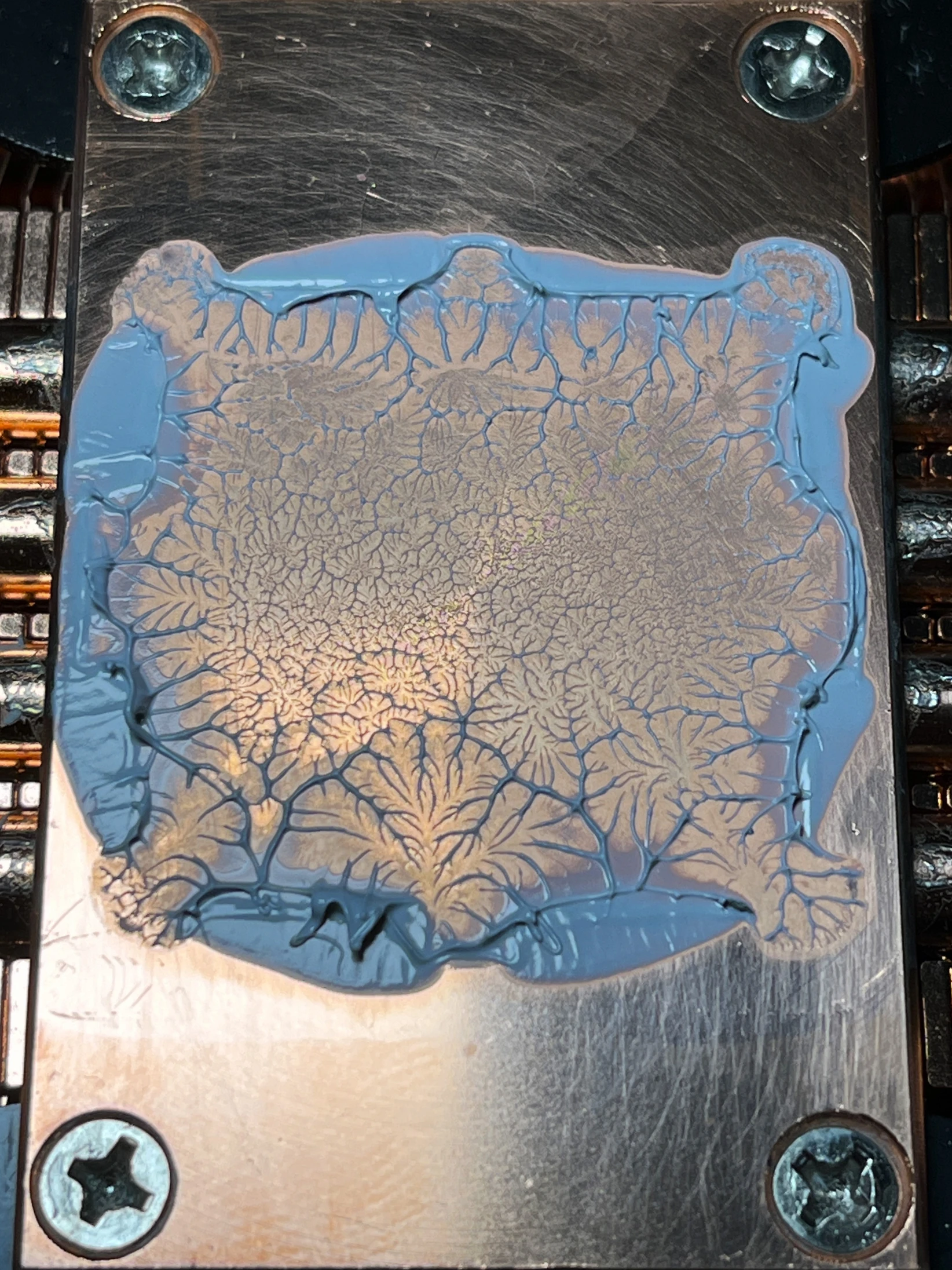

For example on a gpu, the critical factor is the gpu die location. The thermal paste will end up a layer not more than 0.1mm, probably less. After that all pads thicknesses are known because the gpu heatsink is a solid piece that gets positioned on that gpu die, everything is solid, the distances are set.
2 hours ago, KLiKzg said:
no, there will not be the same distance...as there is no way that whole paste can flow that easily
Yes there's way. Did you ever disassemble a cpu cooler or a gpu heatsink and witness the paste pattern ?
Thermal paste isn't made to form a layer but to fill small imperfections in the cpu/die and heatsink surfaces. The less paste remains the better (up to a point) because metal is a much better heat conductor than paste.
Everything you write about physics is not relevant here, there's no choice.
