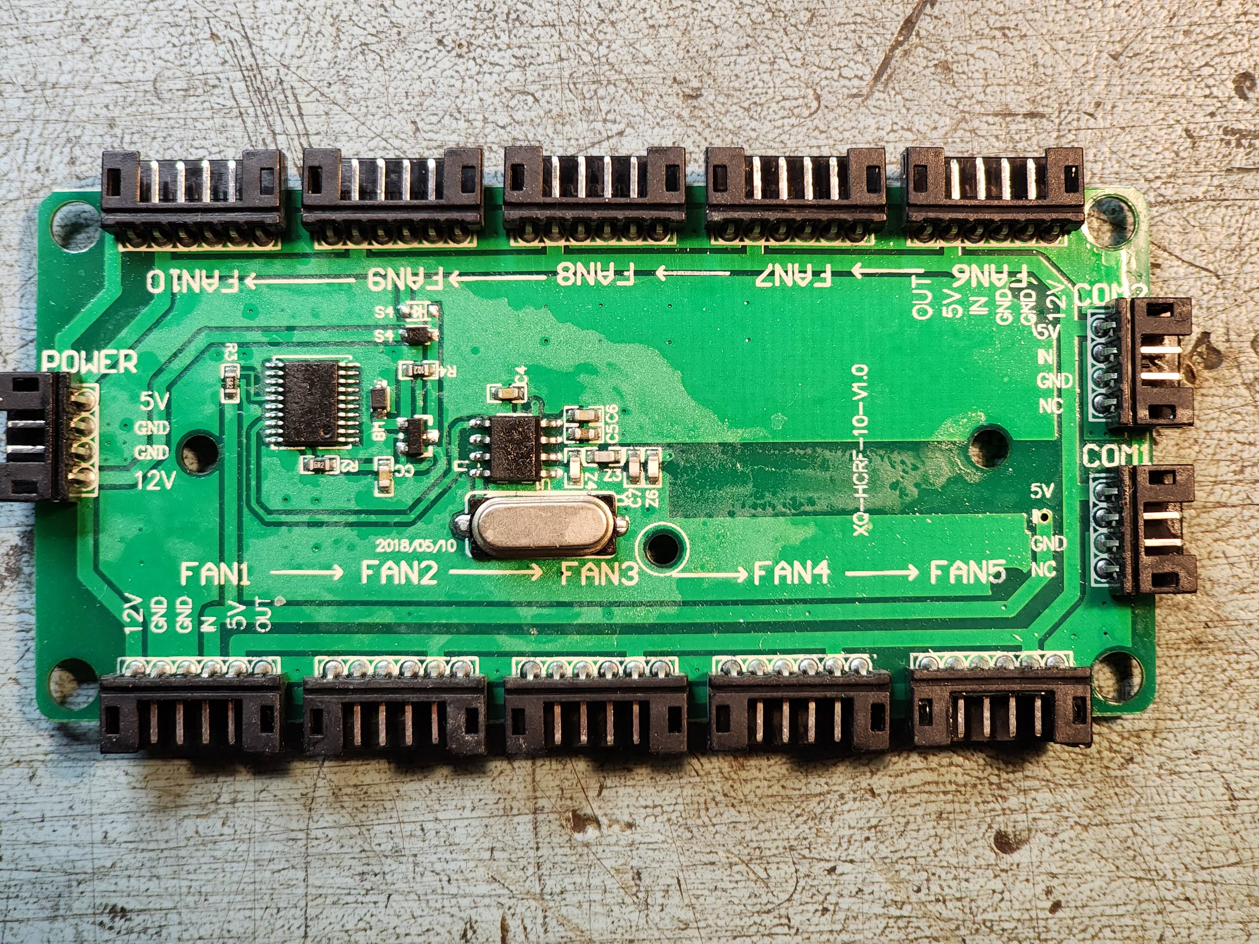

Looking for help with an Uphere fan controller's connections
Go to solution Solved by thrasher_565,
the controller is at a fixed rpm as there no pwm
to control the fans you have to cut off the 12v and ground and wire it to a mb header and in bios set it to dc mode and set a fan curve if your mb can do so. other wises it be old school electronics like a resistor. pot, switch with say off. 12v,5v,7v some fans might run at 3v but most don't so...
there is an adapter that makes dc fans pwm but i think it needs a tac? but i dont really no. but you can buy a pwm fan for the cost of an adapter so...🤷‍♂️
this site you might be able to find the adapters but dont no. probly find them on aliexpress too i can find the rgb adapters but not the fan so...🤷‍♂️

Thanks for your input.  From what I can gather this setup is pre-RGB era stuff.  The power connector for it is a Molex 4 pin.  I do have 3 fans for it so it's not a total waste, plus I'm retired on a fixed income so any money not spent is what I'm going for.  Being a retired electronics tech I am also hoping maybe someone has some of this hanging around and can provide me with enough info to cobble  something together,
As I said, I don't believe this is true. From everything I can see online, the com ports on this board will connect (propriatory cable) to both a PWM header and an RGB/ARGB port on the mothboard.
I agree that a proprietary cable is needed, but I suspect it only connects to the MB fan header.  The fans have no RGB and do function when connected to the controller, but I am looking to be able to control their speed.
I don't think so. The point of all the different 6 pin fan designs were that they combined the fan cables to improve cable management. If this fan controller was only meant to connect to the MB fan header, then the designers wouldn't have reinvented the wheel.
Yeah those are RF controlled so no help there.
They are actually both RF and motherboard controlled, see the cable to the left of the remote on the 7th image (which has both PWM (or DC) and ARGB connectors). Pretty sure that is the type of cable your missing. However, the pin out order could be different.

Posted (edited)

Posted (edited)
or this
i cant find a female molex to male 3pin adapter problem i had long time ago so i made one.
you can find female molex to female 3pin and you can find male molex to male 3pin but not female molex to male 3pin...🤷‍♂️
Sorry, what is this in relation too?
the com ports are 5v argb for strips not pwm there no pwm on this controller. its posable on the remote you can change the fan rpm but dont no.
Corsair Lian Li Bykski Barrow thermaltake nzxt aquacomputer 5v argb pin out guide + argb info
5v device to 12v mb header
Odds and Sods Argb Rgb Links
If the COM ports were just 5V ARGB wouldn't they be missing pin 3?

Posted (edited)
no as its proprietary
its 5v, in = data, gnd = ground, nc =  no connector
Edited by thrasher_565
Yeah, your right... Oh god, why? reeee
(Also, just found this source that explains that)

Just now, will0hlep said:
Oh god, why? reeee
the "traditional" argb connector is 5v data space ground but when it comes to proprietary any wire can be in any spot and any connector can be used hence proprietary
so you can get any order for both argb and rgb connectors and even mb headers can also be random order...

Thanks to all who have replied.  I'll be testing the RGB strip theory, just to see if it works as I don't care about RGB on this build.  I'll most likely initially run the fans at whatever fixed speed they run at because some airflow is better than none.
Posted (edited)
cant test argb with out the remote. and gl finding strips. fans might not even run with out the remote too but don't no. i think your wasting your time. you can buy a controller for like $8 so ...🤷‍♂️
