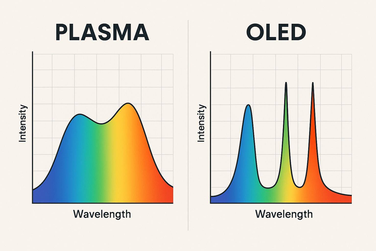

Here’s what I discovered: plasma and OLED don’t just differ in specs, they differ at a fundamental light production level. Plasma uses phosphors that emit a broad, continuous spectrum of light—more like a natural incandescent glow than anything modern. That means it outputs many overlapping bands of light across the visible spectrum (OLED has wider color gamut, but plasma produces more bands of light in the visible spectrum). The result is a type of illumination that feels rich, organic, and alive. Colors blend with grace. There’s warmth in every shade, a kind of atmospheric depth that gives the image a soul. Reds smolder, greens breathe, and skin tones feel touched by sunlight rather than lit by electronics. It’s not just color—it’s radiant, expressive light.
OLED, on the other hand, uses highly efficient emitters with narrow spectral output. Each subpixel produces a sharp spike at specific wavelengths—very pure, very intense, but also very narrow. This gives OLED a wider measured color gamut, since those pure spikes can hit extreme points on a CIE chart. But that’s not the same as broader spectral coverage. OLED covers more of the chart, but with less light in between. The result is often clinical. Colors appear isolated, not continuous. Everything is vivid, but it feels artificial—like looking at a very digital rendering instead of looking at something through a window.

Appreciate thr thoughtful reply, but a few points here need some clarification, especially regarding human color perception and spectral output...
You're right that human vision is trichromatic—our cones respond to long (red), medium (green), and short (blue) wavelengths. But it's not as simple as “any RGB source is good enough.” The spectral shape of each channel—the actual light distribution within each RGB emitter—has a huge impact on how colors are perceived. It affects not just how we see pure primaries, but how colors blend and how natural or artificial the overall image feels.
OLED’s emitters are extremely narrow and spiky in the spectral power domain.. That spike-like distribution allows for a wider measured gamut, sure—but the energy between those spikes is lacking. Plasma, using broadband phosphors, emits smoother, fuller curves with overlapping bands of energy across the visible spectrum. This more continuous spectrum doesn't degrade color separation—it enhances realism, because real-world light sources (sunlight, incandescent bulbs) emit similar broadband light. Plasma mimics that behavior, leading to more natural gradients, subtler skin tones, and richer overall tonality—especially in midtones.
The argument that continuous-spectrum light only matters when lighting external objects (i.e. real-world lighting scenarios) misses a key nuance: even in direct-view displays, the spectral shape determines how light interacts with our eyes. Displays aren’t just triggering cone responses in isolation—they’re engaging our entire visual system, which includes complex interactions, adaptation mechanisms, and cross-channel blending. That’s why OLED often feels vivid but synthetic, and plasma feels warm and cinematic—even if both are technically “accurate” in a color chart.
Also, your point about psychovisual preference is fair—yes, spme of this is perceptual and subjective. But not all of it. Motion resolution, for instance, isn’t up for debate. Plasma’s pulsed drive gives it a clean 1080 lines of motion resolution, while OLED's sample-and-hold nature limits it to 300–400 lines without motion interpolation. That’s a measurable, tested difference in effective resolution during real-world content, and it directly affects sharpness during panning shots or fast movement. A 4K OLED looks less detailed in motion than a 1080p plasma.
So yes, OLED wins on lab specs—deeper blacks, wider gamut, higher peak brightness. But plasma delivers a more full-bodied, lifelike visual experience thanks to its analog light characteristics, real motion clarity, and broadband color emission.
