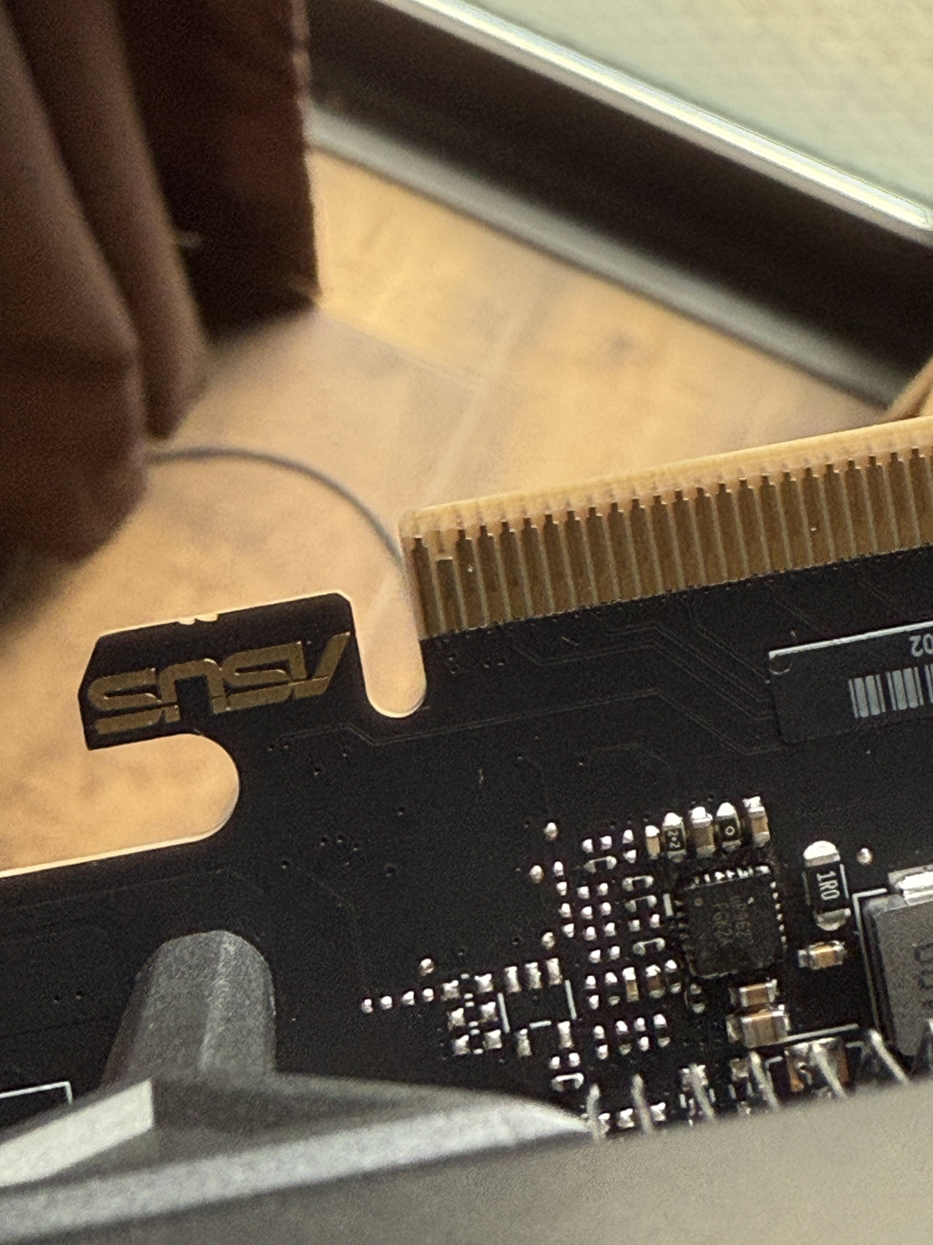

2 hours ago, windening said:
i was inspecting my gpu and realised this part of the pin missing. Would it be the cause?IMG_9952.thumb.jpeg.811a2c89f72437150b1afb52af92f890.jpeg
That is a sense pin. It's supposed to be shorter than the others, because it's used to determine if the card is fully seated.
No, as was said the pin looks like that on purpose.
If possible check the card in another PC. If it's works there, it's something with your motherboard or CPU.
Alternatively, maybe borrow a card from a friend and try it in your PC. If it works, then it's likely your card. If not, same a above.
oh okay thank you for explaining it.
