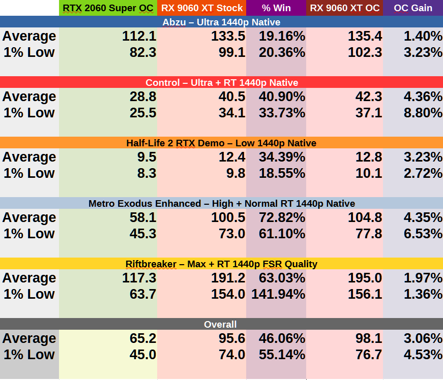

After 5 years, I've finally upgraded my graphics card. I decided to run some benchmarks to see how the two cards compare.
The games I picked were ones that I either knew would be demanding, or ones that I actually intend to play. Because these results were for my own reference, I actually kept the undervolt/OC on my RTX 2060 Super intact - I want to know how much of an improvement I'm actually getting.
With that said, I thought some others might be interested in these numbers, since this is probably one of the only head-to-head comparisons between these two cards available at the moment. Just note that, between the factory OC and my own tweaks, the numbers for the 2060 Super are inflated by 5-10% compared to reference.
I also tried out an overclock on the RX 9060 XT. The numbers for that are +10% power limit, +185MHz frequency offset, and 2900MHz for the memory. That overclock was stable for these tests, but actually crashed when I was getting the results together working in the desktop, so I ended up having to pull it back a bit, but I didn't want to re-run everything. In the end, the OC isn't amazing. It probably isn't worth the potential for instability. I'll try for an undervolt in the coming weeks - although even that is dubious, as the card runs very cool.
The specific models are the Gigabyte RTX 2060 Super Windforce OC 8GB and Sapphire Pulse RX 9060 XT 16GB. The CPU in the system is a Ryzen 9 5900X with a Curve Optimizer per Core undervolt. The memory is 48GB across 4 sticks overclocked to DDR4-3333 with primary timings 16-18-18-38. The 2060S was limited to PCIe Gen 3 and no rebar - this is a 20 series limitation. The 9060 XT was running in PCIe Gen 4 mode with SAM enabled.
The weakest results here are in Abzu. This could be a CPU or RAM limitation - the GPU utilization was only in the 80-90% range during the test. It could also be that this is a weak game for RDNA 4 - or perhaps a strong one for Turing. It is also the only game without RT, which could imply that RDNA 4 has much stronger relative RT performance compared to shader performance vs. Turning. Abzu benchmarking is not common, so I wasn't able to find any others who benchmarked the game with the 9060 XT. If you're a random person on the Internet 10 years from now looking for this data - you're welcome.
The best results are in Metro Exodus and The Riftbreaker, both of which had RT enabled. The Riftbreaker is unsurprising in some ways, as it's an AMD sponsored game with limited RT options, but Metro Exodus was a showcase game for the 20 series, so I was surprised to see the 9060XT completely decimate the 2060S here.
On the whole, I'm honestly not thrilled with these results. I was hoping for better. But some of this is almost certainly due to my CPU being a limiting factor. Metro Exodus showed utilization below 100% the entire time - sometimes as low as 80% in the early part of the cutscene I didn't benchmark when the card was pushing over 150fps.
Benchmark details for those interested:
The numbers here are a 3 run average.
The benchmarks for all of these was taken with Afterburner/RTSS - I did not use the numbers from the built-in benchmark for The Riftbreaker.
The Abzu benchmark was swimming across the room where the ocras spawn past the pillar of coral in the center to the reefs on the far side.
The Control benchmark was in Central Executive - I fast traveled there, started recording, then turned around and went up the stairs, around the upper level, and looped around, returning to the control point.
The HL2 RTX benchmark was in Nova Prospekt - I just loaded the level, went around the corner, through the fence, through the fog, and stopped at the debris, then turned around and went back to the starting point.
The Metro Exodus benchmark was the opening of the level Moscow, including some of the opening cutscene, but not all of it. I started recording when Artyom wipes his mask, then I played through the beginning of the level, turning on the flashlight when prompted, and burning the cobwebs when prompted. I stopped at the second set of cobwebs in the train car.
The Riftbreaker benchmark was simply the GPU benchmark.
The main potential outlier here was a bad run for the RTX 2060 Super in The Riftbreaker, where the 1% low dipped all the way to 1.6fps as the final result. This was likely due to the card running out of VRAM - it happened on the third and final run. The RX 9060 XT was reporting nearly 13GB of VRAM allocated in its runs.
I also attached the spreadsheet itself - the raw numbers are held inside of =AVERAGE() functions.
BenchmarkResultsSansCrysis.ods

For future spreadsheets, I do recommend using a geometric mean for the averages rather then an arithmetic mean. Your 1% low average is being pulled up really high with riftbreaker, with a geometric mean, the 1% low average is 40.6%

That's fair. I know that reviewers typically use a geomean for that reason. While I feel it was a valid run, the outlier data in The Riftbreaker is factoring in too heavily.

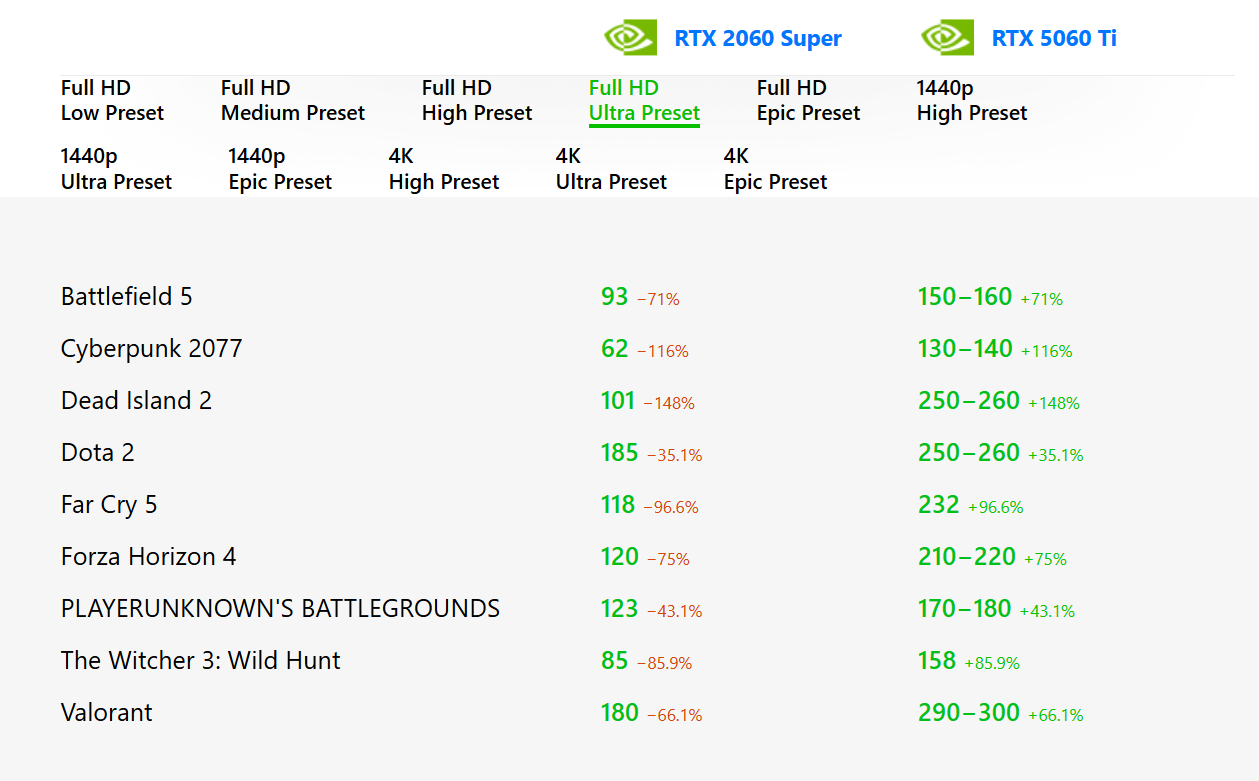

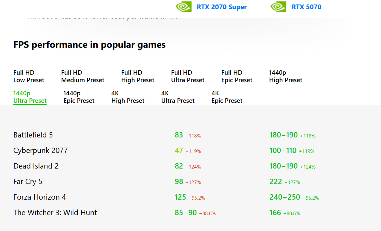

DLSS should be factored OUT, not in.  I dont know what you are talking about with a graph.
Also what kind of cards are you using here?
Also what kind of website are you using here that uses percentages so wrong. -119% makes zero sense. that is negative frames per second.
Stepping up a tier doesn't make sense as a concept either, or rather making a statement like that doesn't make sense in terms of engineering.
I also want to point out alot of the numbers on those chart are very wrong.

The 5060 Ti is the equivalent of the 9060 XT, no?
And for the upper tier, I used upper-tier cards from the same generations. Not choosing AMD is a personal commitment, but the point stays the same. 50% is the very minimum of performance gains when 1080p, the intended use case, is considered. It is far from terrible. And where does this idea of exponential performance gains come from? From the times when the dies shrank by 10+ nanometers with each generation?

Quite a bit faster! I'm surprised an overclock didn't do more though, and I'm also surprised the 9060XT didn't win by more in the Abzu game.
Abzu was likely being held back by the rest of the system. I saw GPU utilization below 90% there, which usually indicates a CPU or RAM bottleneck.
I picked that game because I like to return to it and use the Meditate feature to appreciate the atmosphere and art style. It is likely not a good title for GPU benchmarks.
If the Abzu results are removed, the average win percent increases to 52.79% - much more in line with what would be expected from such testing.
If Abzu is excluded while using a geomean instead, this goes to 50.41% - a big increase from the 41.54% given with that result still included for the geomean.
