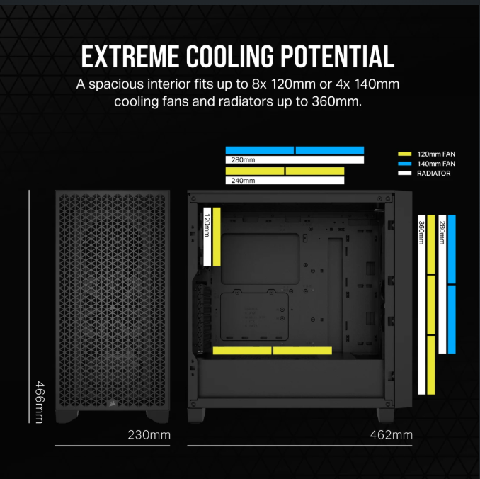

I recently build a PC with this case that came with 3 pre-installed front intake fans.
After that, I added a 240mm AIO at the top as my CPU cooler (exhaust configuration).
The system was running fine for over a month — temps seemed normal, and I barely heard the fans spin up, even while gaming.
A couple of days ago, I installed a rear 120mm exhaust fan. Ever since then, my system fans have been noticeably louder, even during idle or light use (no gaming). I'm not sure what's going on.
Current CPU temps are around 55°C at idle/light load, which seems a bit high, but I don’t have data from before to compare. I never had a reason to check temps earlier since everything seemed quiet and stable.
My guess is either:
  • The rear exhaust fan is disrupting airflow near the AIO (they're fairly close to each other), and now the AIO fans aren’t working as effectively.
  • Or maybe I accidentally loosened the AIO mounting when installing the rear fan, affecting contact with the CPU.
Current Fan Setup:
  • Front: 3x 120mm intake (came with the case)
  • Top: 240mm AIO (exhaust)
  • Rear: 1x 120mm exhaust (recently added — issue started after this)
Specs:
  • AMD Ryzen 5 7600X
  • NVIDIA RTX 5070 Ti
Would really appreciate any help or suggestions on how to diagnose this. Should I try removing the rear fan to test airflow? Or shift the AIO more towards the front?
