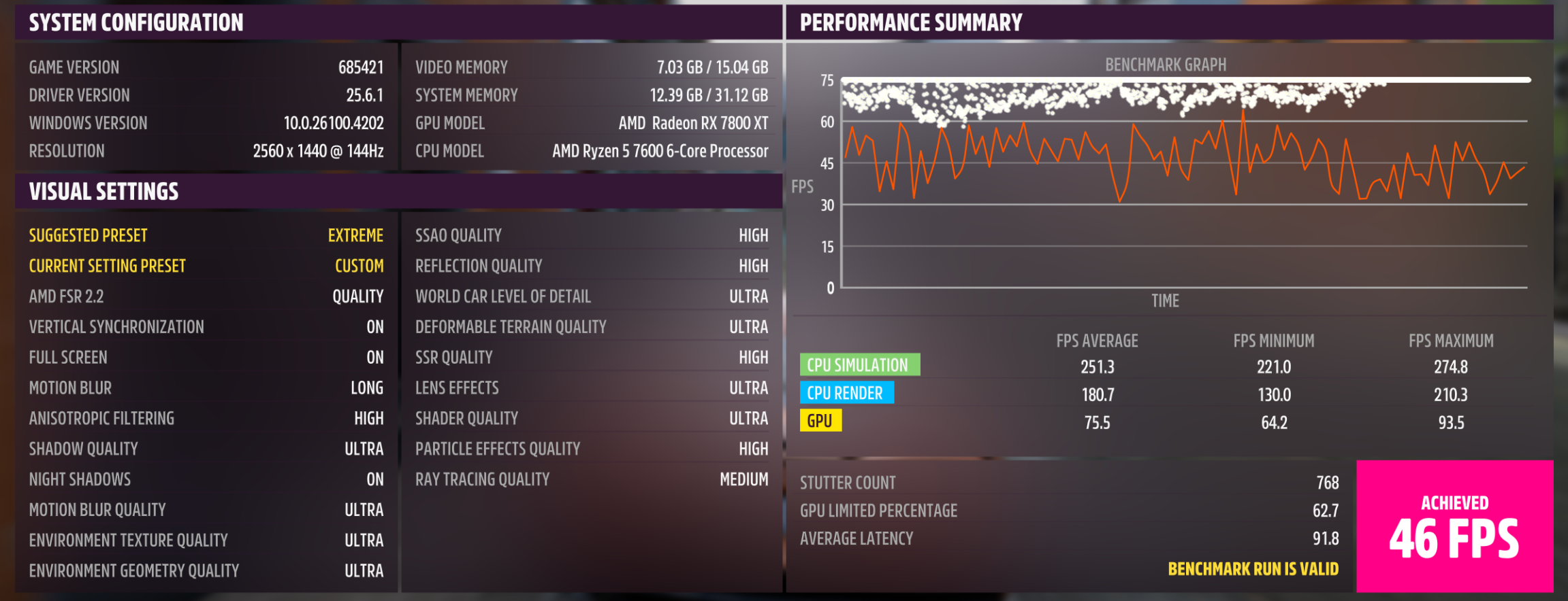

When you're running the benchmark, pop open Task Manager. Is your CPU, GPU, or RAM pinned at all? Make sure to change the CPU graph to Logical Processors
1 hour ago, Gamer6163 said:
I got a 7800xt and a ryzen 5 7600x cpu and i am playing horizon 5 and it just hits 50 fps and is basically unplayable
It shows in the results that you were only GPU limited around 62% of the time, indicating some kind of bottleneck somewhere. Your 7600 shouldn't hold you back that much, Forza Horizon 5 ran pretty well on my ROG Ally and I was usually fully GPU bound. RAM shouldn't be a problem as the game reports 12GB out of 32GB used
