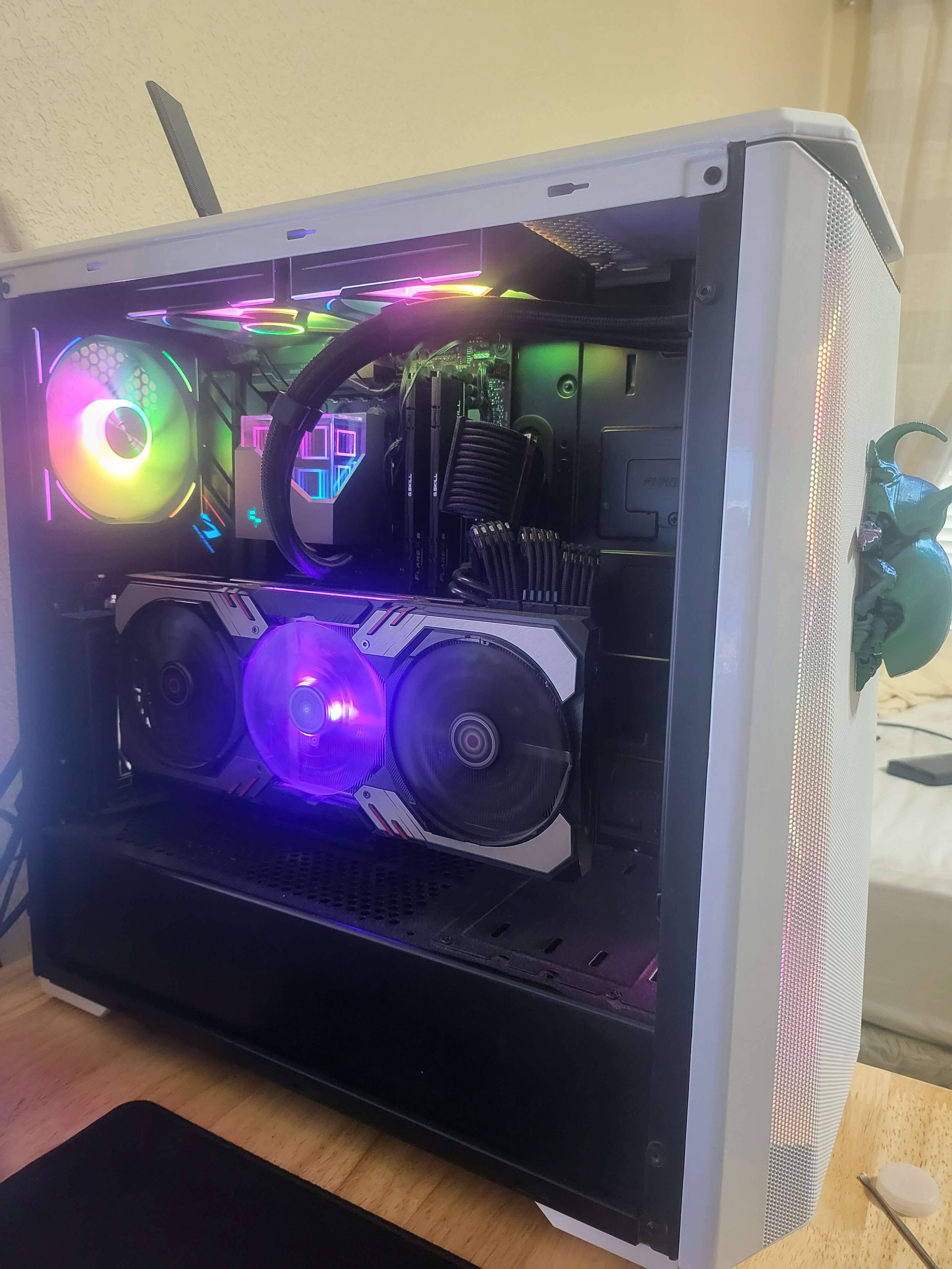

My Cooling is not good maybe bad not sure. Please any advice is greatly appreciated.

Looks like there are way too many intakes with just a single exhaust.
Unless the top fans are reverse blade.
Try flipping the rearmost top fan and check if that helps.
It's entirely hopeless as long he has an AIO, a fishtank case and a vertical GPU mount lol. The worst imaginable scenario from an airflow perspective... Slot in a decent air cooler and the whole situation changes completely (yes the case fans will still be mostly useless, but it'll matter not as much 😉 )
My temps are a bit high and scaring me.
My Asrock 6950xt oc is ideling at 45c which is okay but when i play games its a gets to about 103-109c and just stays in that range unless i turn my graphics to low or medium.
My CPU is a ryzen 9 7900xt and has a deepcool 270mm aio and will idle at 64c and goes up to  80- 90c ... why is my idle temp so high should  i switch to a big air cooler. remount my aio. idk

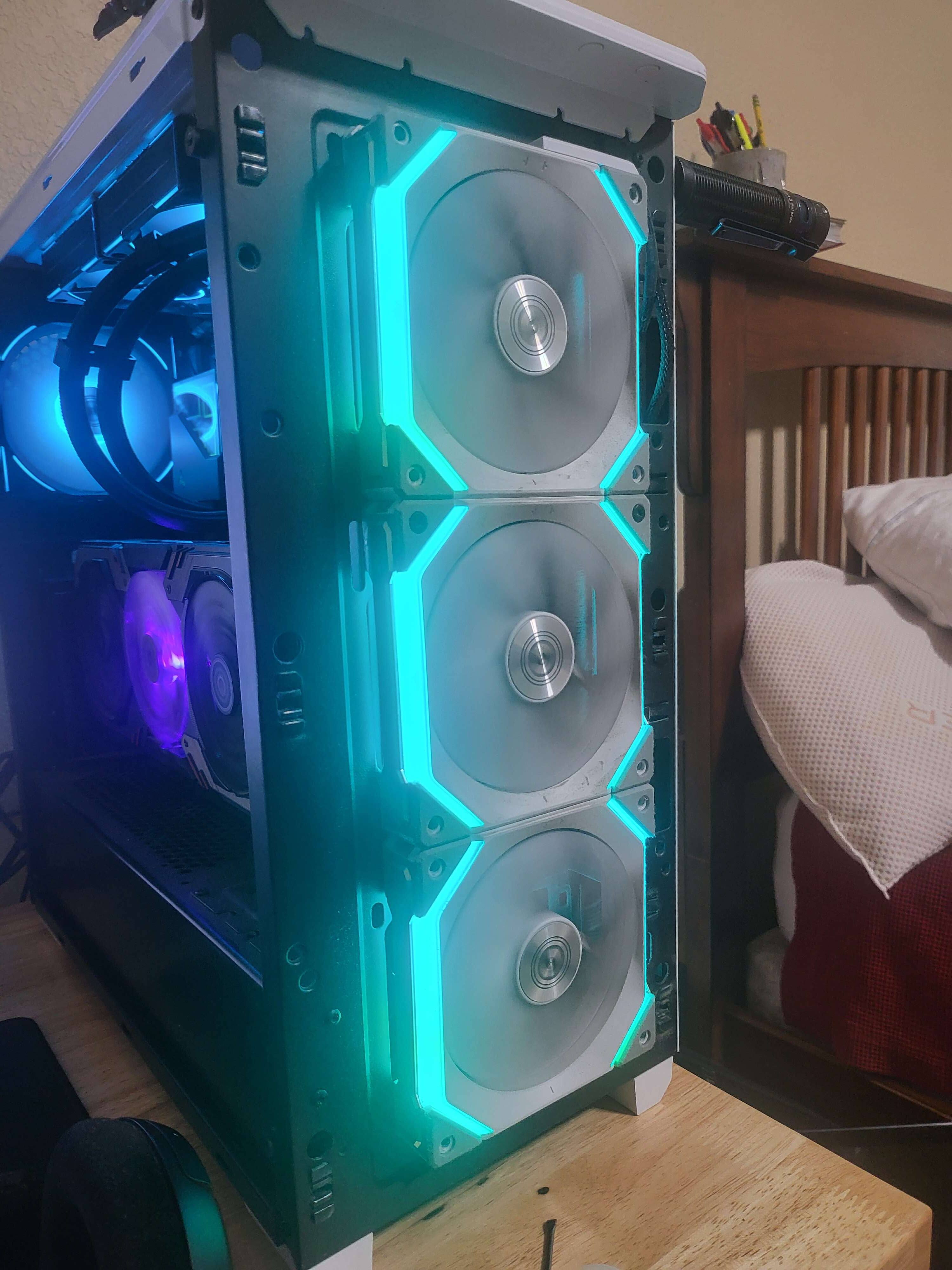

Also for the pc fans i have 3 going into the front and two venting out the top and one out the back.
should i make my gpu horizantal ??

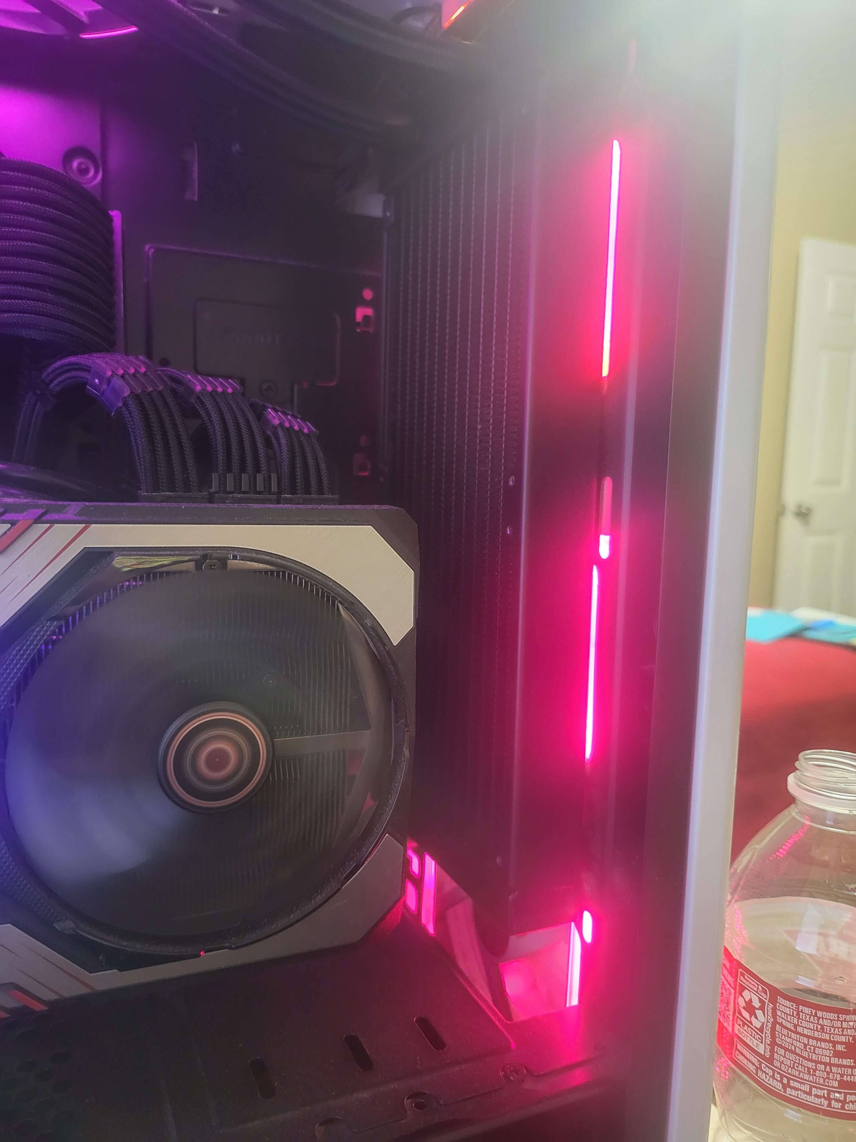

you have 3 HOT intakes and GPU is suffocating against the glass. Open the case and run some games. See temps. If they're significantly improved, your answer is poor air circulation and delivery.
Edit: solution is to rotate the GPU and run exhaust fans a bit harder to create negative pressure. That's how I'd do it.

I do not agree at all.
That GPU is absolutely not suffocating against the glass.  There's plenty of room in front of it.
As for what the issue is:
Have you tried running without the front panel on the case?  See if that helps any?
Top Fans:  Those look to be intake currently, unless they're reverse blade?  Double Check those.
CPU:  Ryzen 7000 run hot, so you can fully expect that to go to 85-90c regularly.  That's not unusual.
GPU:  Probably should be a little cooler.

Can you post a pic of the front fans where they're installed?

A GPU doesn't have to be suffocating directly, but because of its cooler design, it has 50% of the exhaust on the bottom, which it then recirculated into itself due to heat column effect. So it's an important factor to consider.
the top fans are blowing out my bad for the confusion
I'd swap both top fans to exhaust, as they're far enough from the front fans
And OP should try installing GPU horizontally to check if temps are better

daym you right those are intakes. their lian li fans and yes they are not running fast enough

Isn't a fishtank case one where the front panel is glass? That's a P400 (maybe 500) with a mesh front grille. It happens to be my personal favorite case
