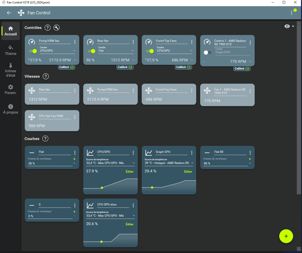

I don't use ICue, get FanControl and enjoy freedom 🙂

Fancontrol allows you to make mixed controls on max/average of whatever sensor temp, manage fan acceleration/deceleration and delays, and even more !
No RGB tho 😮
Plus it's super light
