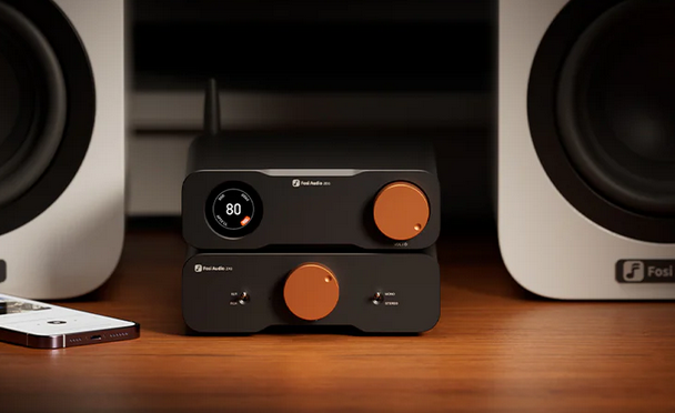

  2. I guess then its time to look at pretty case proposals. Should be black to match Fosi Audio ZD3
