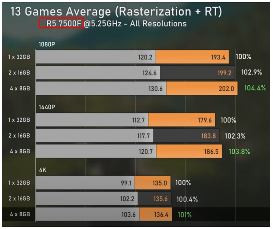

But I saw this video a while ago by ancientgameplays. So in short, still. 4 dimms is better than 2? I thought it would increase latency but shits faster. What gives?

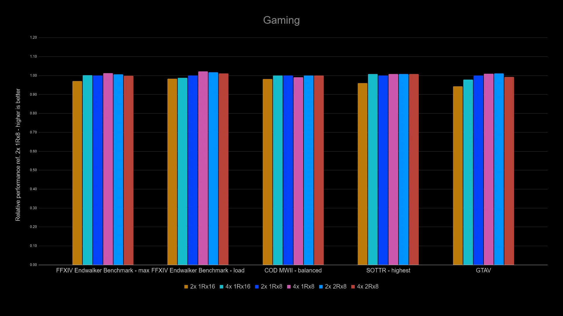

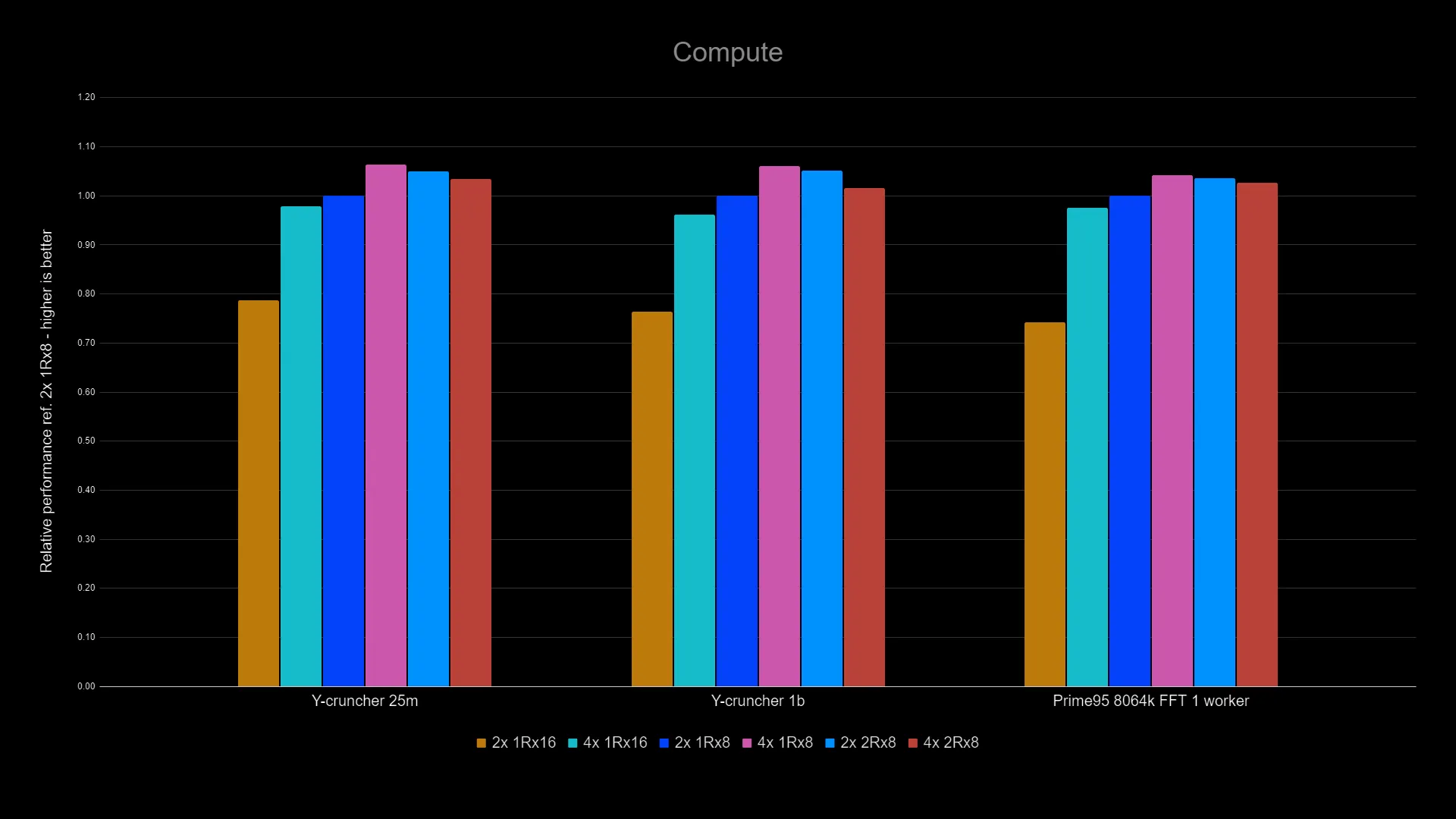

Below is old testing I did with DDR4. 11700k, 1080 Ti, 1080p. Minor variations in gaming. I could have done with a faster GPU at the time so it might be more GPU limited. Look at memory heavy compute below for a bigger difference. I did set all ram to 2133 MT/s. Didn't note latency but whatever JEDEC mid bin is.

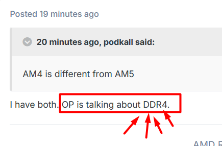

Just now, podkall said:
AM4 is different from AM5
I have both. OP is talking about DDR4.

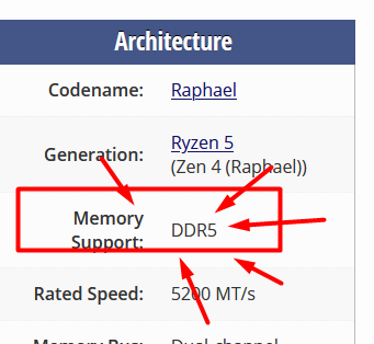

2 minutes ago, starsmine said:
7500F is only on AM5
AKA DDR5, not DDR4
I wasn't the only one talking about DDR4, I was expanding on what they were saying. I also kicked in some of my short experience with DDR5.
