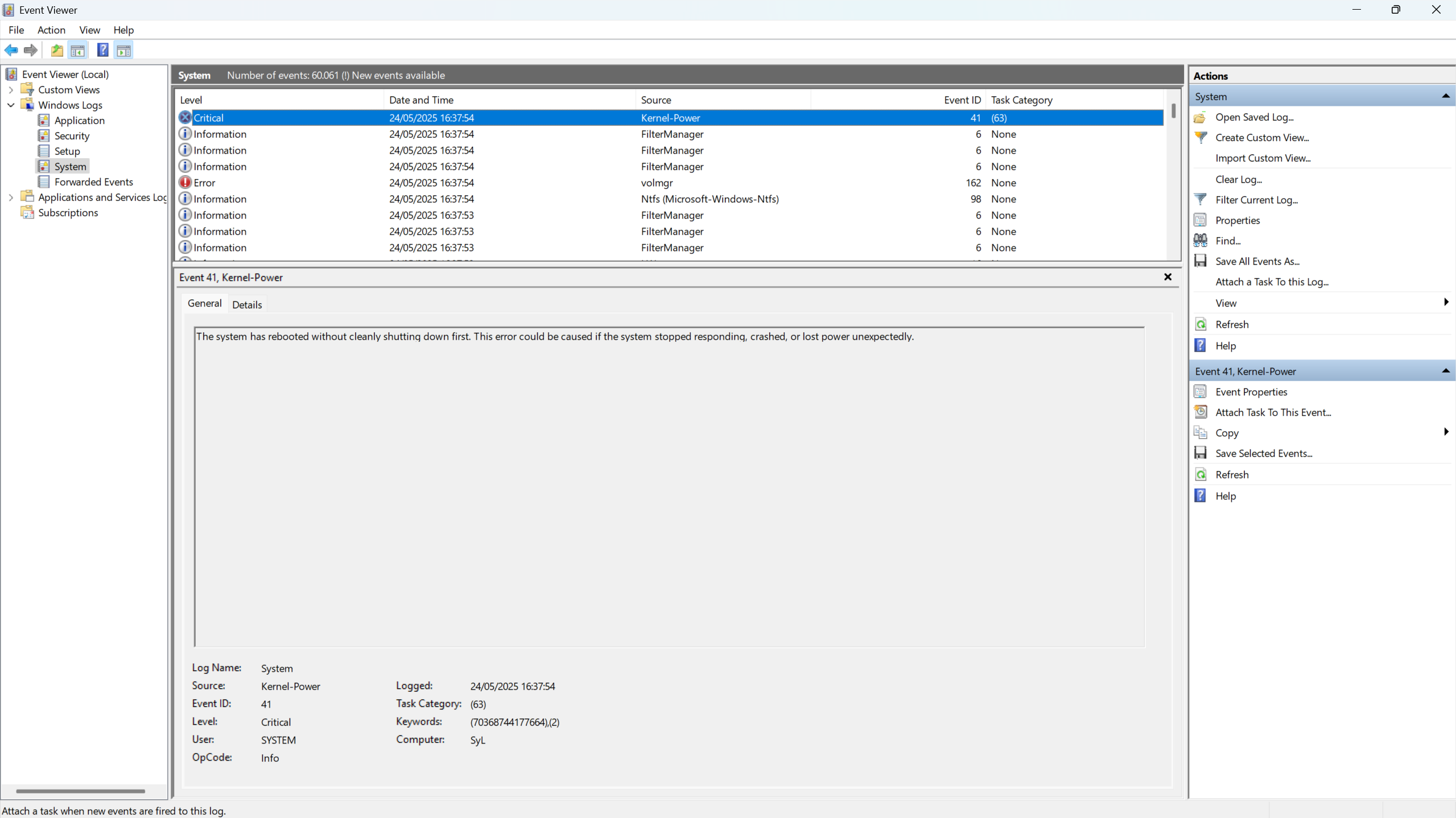

I haven't do the MemTest, would try it tonight or tomorrow. I will do the RAM on different slot test on last if possible, because my HSF block the RAM, so i need to remove it first lol.
I did the 2 & 3 one.
Not sure if the Windows Logs the right one, but yeah i found 1 critical there.
For the 12v 5v and 3.3v, i could only see it on my motherboard, and i ss it as well.
I don't see any fluctuation on the PSU during idle / just boot.

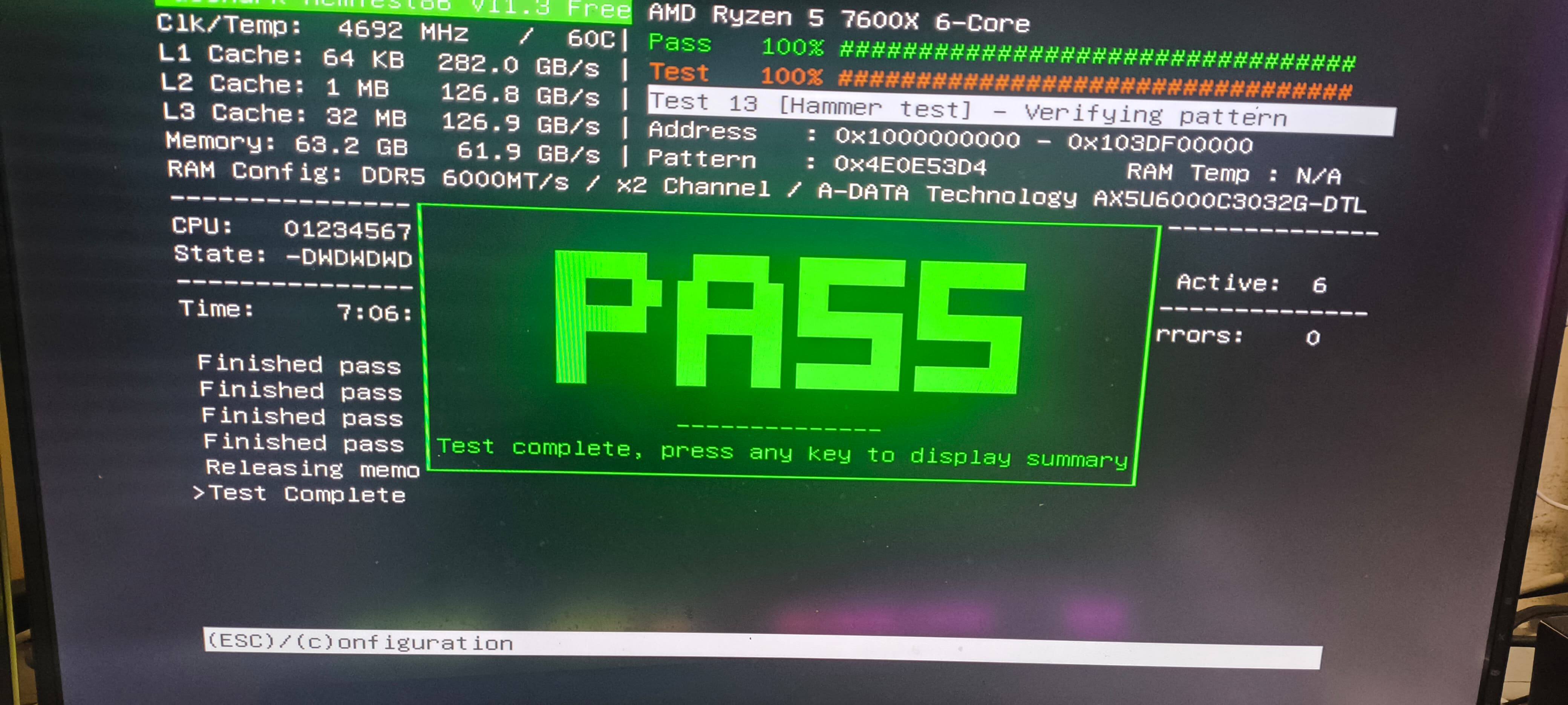

Hey, sorry i just able to reply again. So i did memtest as you suggest.
I did 2 times, 1 with everything default. (and sadly i forgot to take photo of the end test, but yeah it's all pass without any error)
And the 2nd time. I did try with PBO setting and EXPO. And yeah it's pass as well without any error.
