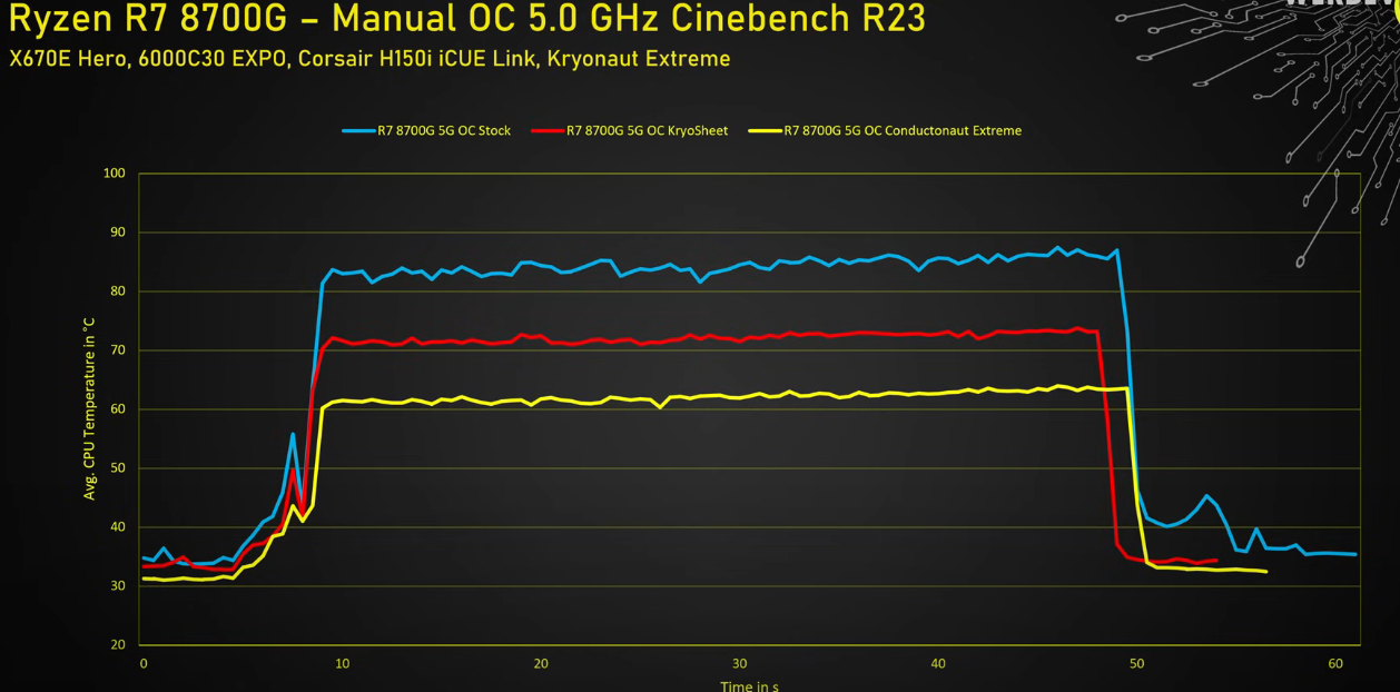

Yea. But I don't want my fan to go haywire 24/7 either. It's mainly to see where it can go. But yes. It is for over clocking purposes as well. Der 8auer lowered his temps by 10 to 20 degrees swapping to kryosheet/LM respectively on a 8700g. But I wanted to maybe get some more input from others who might've done something similar. Not necessarily on the same CPU as me but in general
I'm pretty sure DerBauer didn't gain 10-20C by just changing the paste, he usually do direct die as well

This is the video im referring to. I know he's using an 8700g but i doubt they use a better paste on the 8600g. And he didnt even properly remount the IHS. I doubt that a proper remount would drastically improve the result but maybe a bit.
Here's just the chart so you dont have to go through the whole video.
