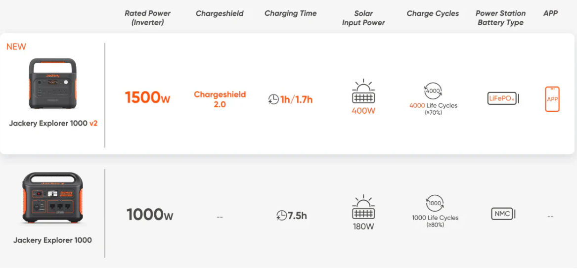

42 minutes ago, Mark Kaine said:
Okay, from the US/CA description the V2 uses a LiFePo battery and the original uses a NMC (I assume that's Lithium nickel manganese cobalt), so the V2 is a bit safer, but otherwise V2 is 17% smaller and can take a larger solar input.
Also looks like the v2 can take 4 panels as input.

You need one 100w panel for every continuous 100w's is my read on it. The package comes with 2 100w panels.
Also if you read the description on the site, apparently the solar panels themselves use USB. Just keep in mind that solar requires optimal sunshine to be efficient, and even though it says 100, it's likely not going to be 100 off each panel without constantly adjusting the angle towards the sun.
Anyways, I do not have one, I can not vouch for it's quality or reliability, though after reading the description it seems like it would probably be a minor step up from the lead-acid gel battery UPS since conventional UPS is not intended to be portable and the battery has to be replaced after a few years, where a Lithium batteries have a different end-of-life failure which is why "a bit safer" really depends how it's used.
