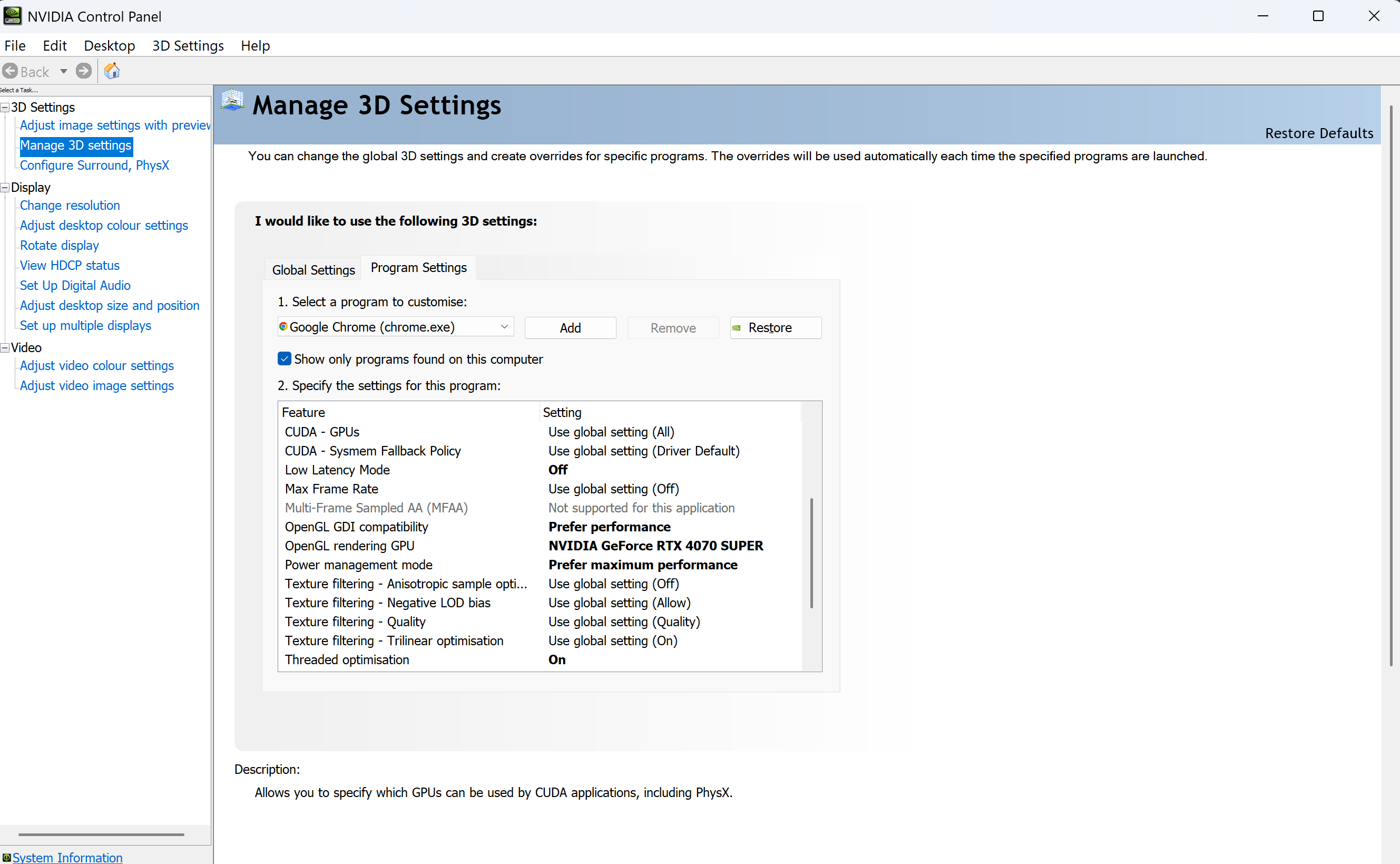

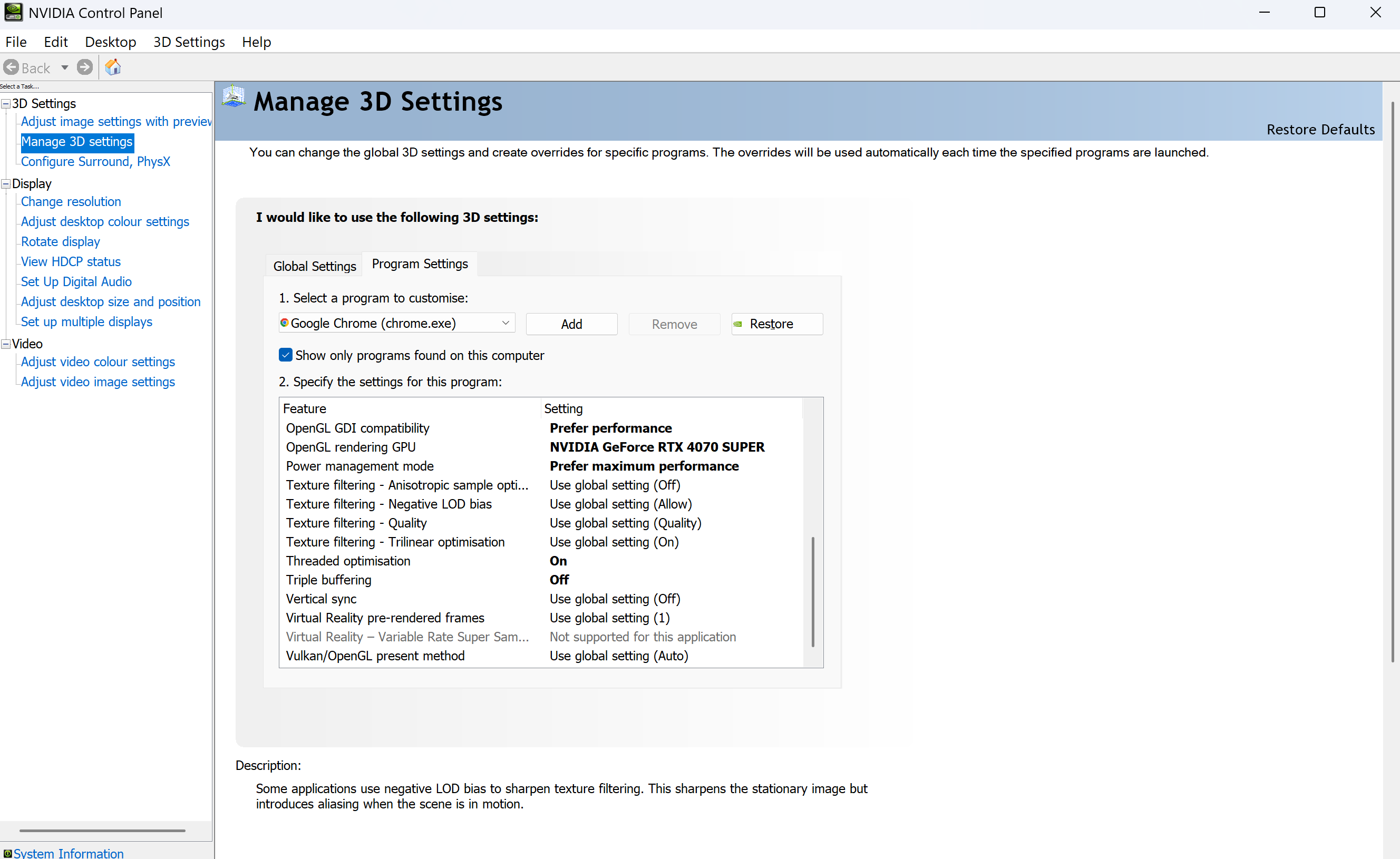

Okay, well, I believe I just fixed it myself.
What I did:
After talking some more with ChatGPT something in me felt like it would be worth changing a few options in Nvidia Control Panel. Here are my new custom settings:
Some of these have been proposed by ChatGPT, some others I straight up did on intuition.
One last thing I changed is something ChatGPT also suggested:
📌 (Optional) Force Chrome to Use DirectX Instead of OpenGL
What I did:
