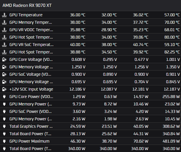

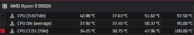

AIO as  side intake?  also  do u have  cpu watt picture?

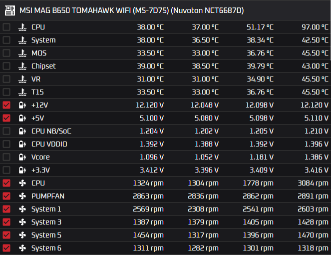

How did you plug and control the LF3 ? The pump speed is low, at high load it should run at 4200rpm

The LF3 is plugged into the motherboard CPU and PUMPFAN headers. The BIOS default settings are in place for fan/pump control.

But which connector is plugged in which header ? the LF3 has 3 connectors, one for the pump, one for the fans and a third for the VRM fan

max pump speed is 2800, so ur over spec thats good.

Pump is on Pump_Fan, VRM is on Sys_Fan, AIO Fans are on CPU_Fan.
Ok then update the Pump fan curve and set it up to 100% at full load, may gain a few C
But I suspect the AIO block isn't seated correctly, maybe some issue with the offset mount or pressure, pls check it or post a pic

I re-ran the same test without changing anything with the same results. I took temp readings from the AIO radiator with a laser thermometer. Idle temp was 28c and it hit 31c max.
That means CPU is transferring very little to the AIO. Something is wrong somewhere.

I removed the AIO and examined the paste distribution. It was fine. Slightly more on the upper right corner, but some paste thinly spread across the entire surface of both CPU and AIO copper plate. I respread the paste a bit and reinstalled. I re-ran the test. This time temps quickly rose to 97c within 2 minutes and stayed there for the remainder of the 15 minutes I let the test run. Previously, temps started around 88c and fluctuated wildly between 88c and 96c, then started to go up about 8 minutes in. AIO radiator temps remained at 31c, as before. Checking BIOS pump settings.

I enabled Smart Fan mode on all fans and the pump. I set the fans and pump to spin up earlier and to hit 100% at temps above 72c. I re-ran the test. There was no change. CPU temp 97c and AIO radiator temp 31c.
