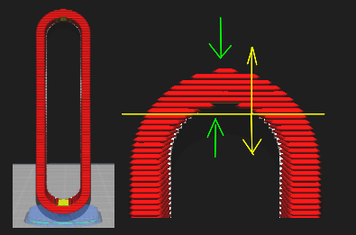

The choice of your fillament IMO is less important,
the orientation of your print is often more critical when it comes to strength.
This is because the layer lines in 3D printing naturally create weak points along the z-axis (height), so if the print is oriented in such a way that forces are applied along the layer lines, the print is more likely to fail.
Say you want to print this:
Printing it, as it is on the picture above and then stretching it along the Z axis (pulling on the ends of the long sides)... yeah your object will almost certainly fail along the layer lines:
(green:compressing = fine, but yellow: stretching = fail)
So, if you want to avoid that, simplest thing to do is to orient your object for printing differently, for example like so:

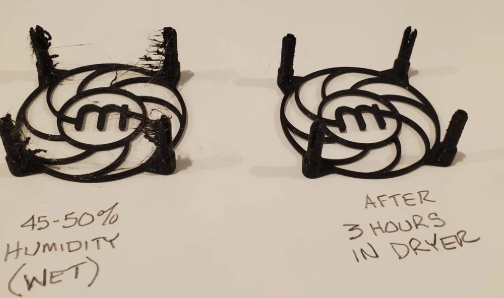

That being said, PETG is a lot more hygroscopic... and wet PETG prints like ass.
So if you don't plan on using up your whole PETG spool in a day or two then you should also get a filament dryer (or DIY one yourself using a food dehydrator, cheaper and ironically often better).
PLA also absorbs moisture, just a lot more slower so you can get away without drying it in most climates.
  Hide contents
