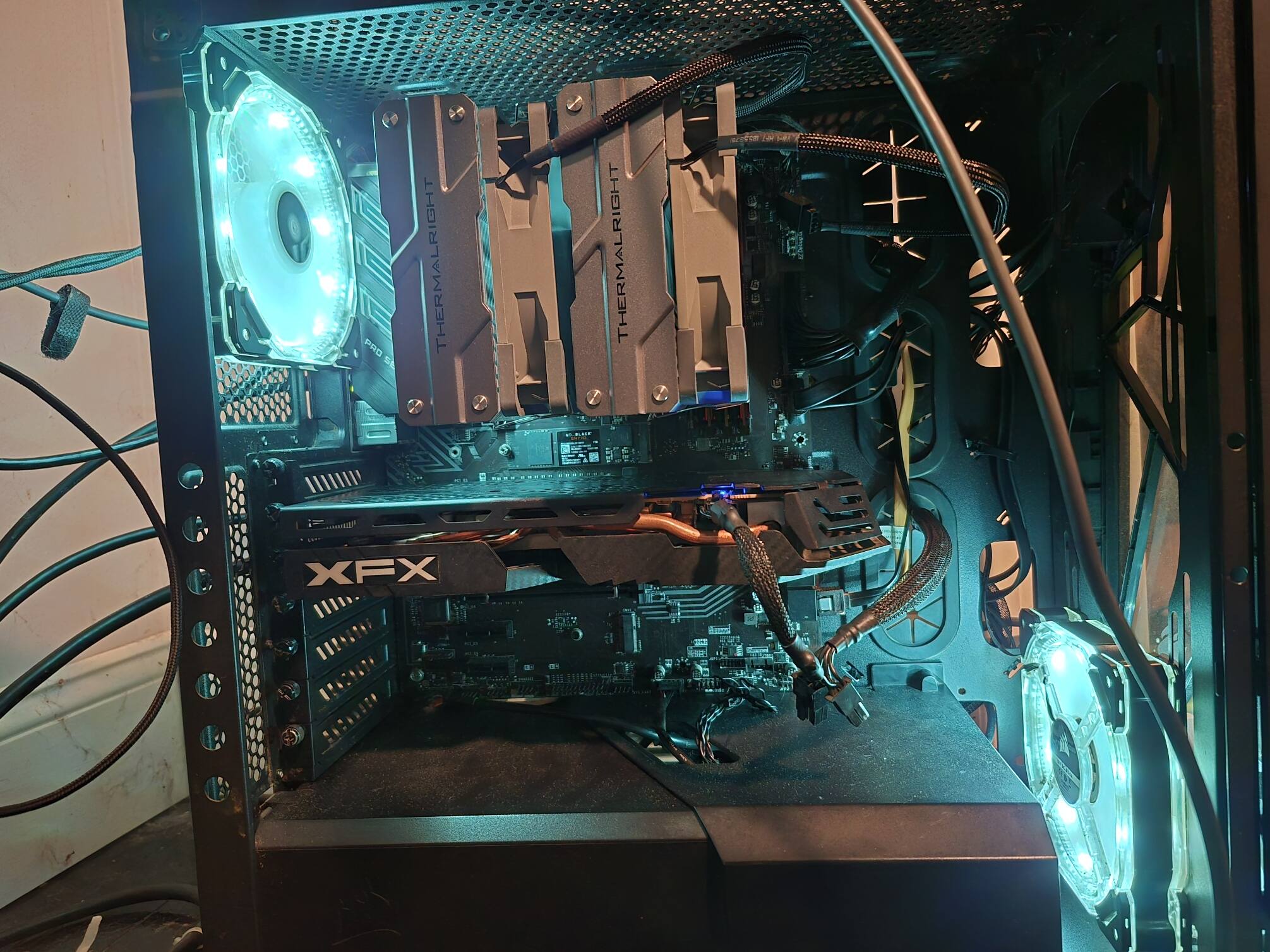

Hello all,
I recently purchased an allegedly brand new (as the eBay seller claimed) i3-9350KF basically for the hell of it, and decided I'd pick up a cooler that's probably a bit overkill for this 91 watt processor (I figured I may as well see if I could push this thing to the moon). Installation wasn't hard, it came with their decent looking TF7 paste which was a little annoying to apply but I think I did it right, and the whole setup looks pretty slick in my case even if it's in the wrong color. Unfortunately, I don't seem to be getting anywhere near the performance that reviews across the internet promised for the PA120 - despite only drawing about 90-95 watts with AVX (but not AVX2) enabled on Prime95, I skyrocket all the way to 100 degrees within a couple of minutes and thermal throttle. Even just benching on CPU-Z shoots me to about 77-80 degrees.
This seems unusual. I've read a couple of reviews stating that this cooler can handle 200+ watt intel CPUs @ about 75-80 degrees celsius (at my room temperature), and Tom's Hardware had a graph that I calculated for my temps to be probably anywhere around 56-60 degrees under load (their 95 watt TDP graphs). Even when ran at stocks clocks and similar voltages to my i3-9100F it exhibits odd behavior, both with my stock cooler (which it ran on for a few days) and the PA-120, such as weird core temperature variance (core temp differences will be 35 degrees or greater sometimes between cores), very sharp spikes when under sudden load such as from 38 degrees at idle straight to 80 degrees within 1-2 seconds, and just generally what feels like lackluster performance. A lot of these behaviors don't seem to be present on my other Coffee Lake CPU, even at similar voltages.
What could the issue here be? Did I maybe overtighten the cooler, misapply thermal paste, etc or could there be something else wrong, like dried out/simply insufficient TIM under the IHS or simply a faulty chip? My temps are a bit better than on my old cooler, but not really satisfactory. I also only have 1 intake fan, so maybe the cooler's struggling to breathe slightly, but not sure.
