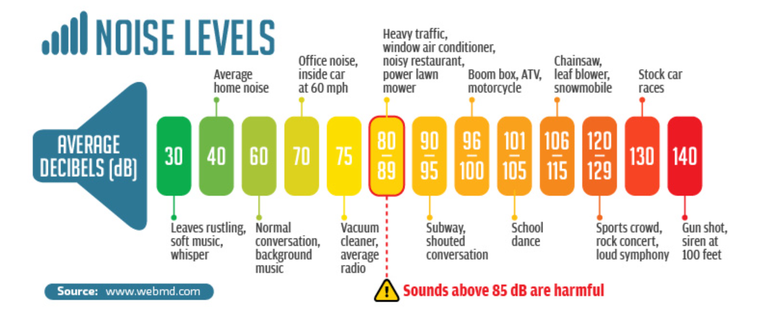

For a reference point in loudness, the KEF Q750 has a sensitivity of 88dB. That means at 1 Watt, it's already at the threshold of safe hearing.
