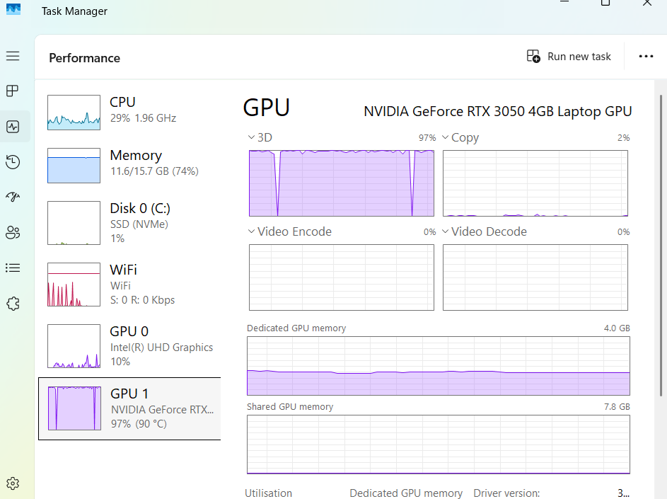

I first got this laptop last July and it was perfectly capable of running games at a completely stable 60 FPS (it could get up to 120 fps easily with uncapped fps) without overheating or any fps drops even with max graphics but I took a break from playing games for a while and when I returned, I had 40 fps at best, settling around 20 most of the time. I did a factory reset and reinstalled it, in case it was a malware issue but I had the same problems. One thing I've noticed is the CPU usage of the game starts at 40% when it first opens but then drops to 10% to 20% afterwards. Does anyone have any ideas as why performance degraded so much? (the game is Genshin Impact by the way).

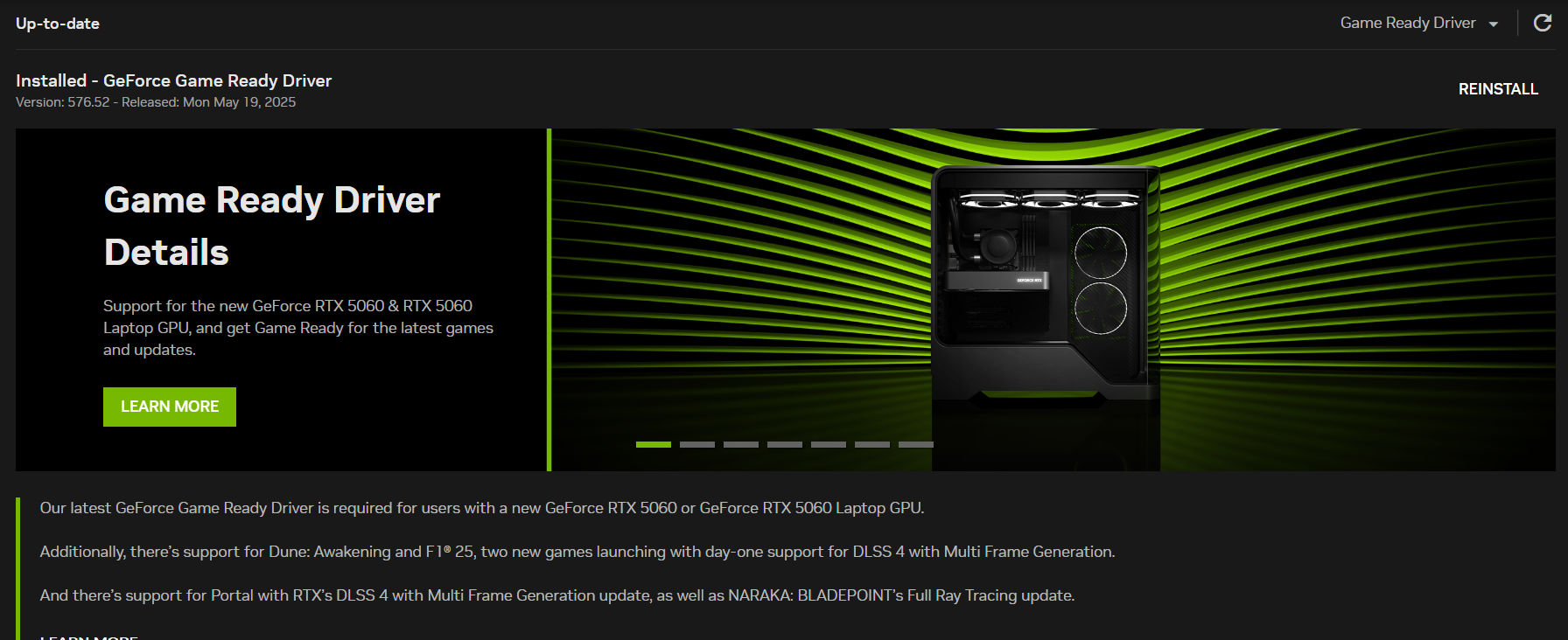

are your gpu drivers updated?
Well yeah its overheating. That gpu is supposed to be 83c max it will HEAVILY downclock to not kill itself and even then its failing as its at 90c.
Open your laptop and blow the dust out of the fans. If its been 3 years also do a repaste.

I did open it up a couple of days ago and blew out the dust from the fan (with a wipe too). I might not have been thorough enough but there's definitely a lot less dust (but I might try again with compressed air or smth if it's a better option). Still, there wasn't much of an improvement. I do think there's something wrong with the fan though since the cpu is always on high temperatures even under low load. It's been less than a year since I got it so I don't know if I should repaste. Maybe a cooling pad would help?

Didn't they say that they already blew out most of the dust? I'd really advise changing the thermal paste. My laptop had its thermal paste on the GPU really dry after just 1.5 years of daily use. It's now been 3 more years and I haven't had to replace the thermal paste yet. One thing you ( @MuonicAnalysis )should try, is let the device cool down, then start a load on the GPU and monitor how quickly the GPU heats up. The higher the initial jump, the more your paste has dried out and should be replaced. I don't think this is something to be fixed purely by cleaning the fans. In the case of my laptop, cleaning the clogged up fans did bring an improvement, but it didn't bring it back to where it once was. Only a repaste did
