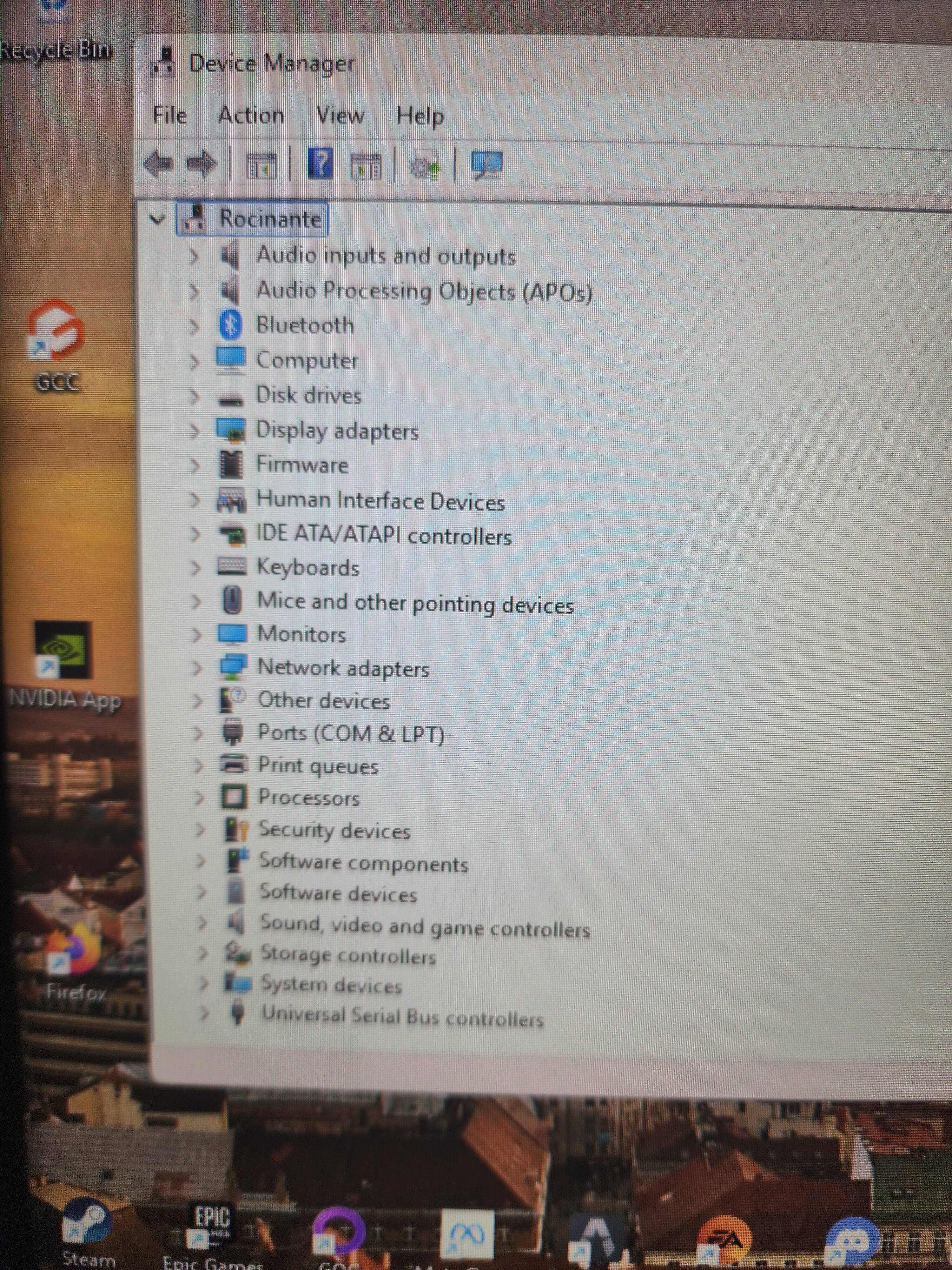

If you can get into Windows. I would check Device Manager. See if there is anything highlighted. From there you can find hardware errors and it will list the error codes. You can web search the error codes for more info.
Doesn't look like anything is highlighted?
Device Manager looks fine. So far this sounds like a RAM issue. You might have better luck with RAM that has a CAS Latency of 30.
